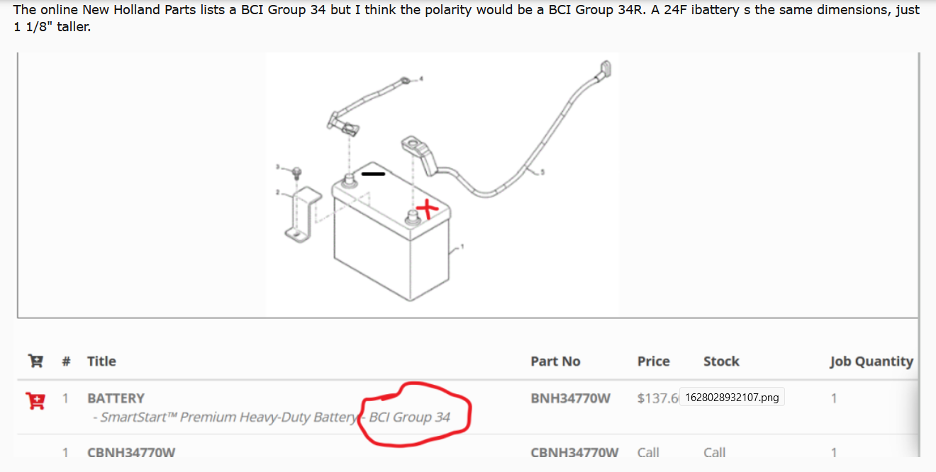

Getting a BCI 34R would have probably bolted right in.
The way the clamp is designed it may well NOT have. There would be a gap of about 1/4 inch between the top of the battery and the bottom of the clamp. The clamp is a fixed height.
I'll hit the hardware store tomorrow and get a longer bolt and some washers to make it work.

Got my replacement at walmart after a ton of wasted time on the internet. The battery was having a little trouble starting the tractor last winter. Happen to have the picture of the battery on my phone with the measurements edited on to the picture so I would not forget them.
