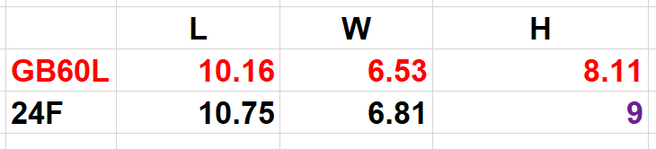

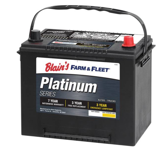

The battery group 24F is about 1/4" wider. I am guessing it would fit. The Farm and Fleet battery I pictured is $110 and 725 cold cranking amps.
/ New Holland battery replacement #8

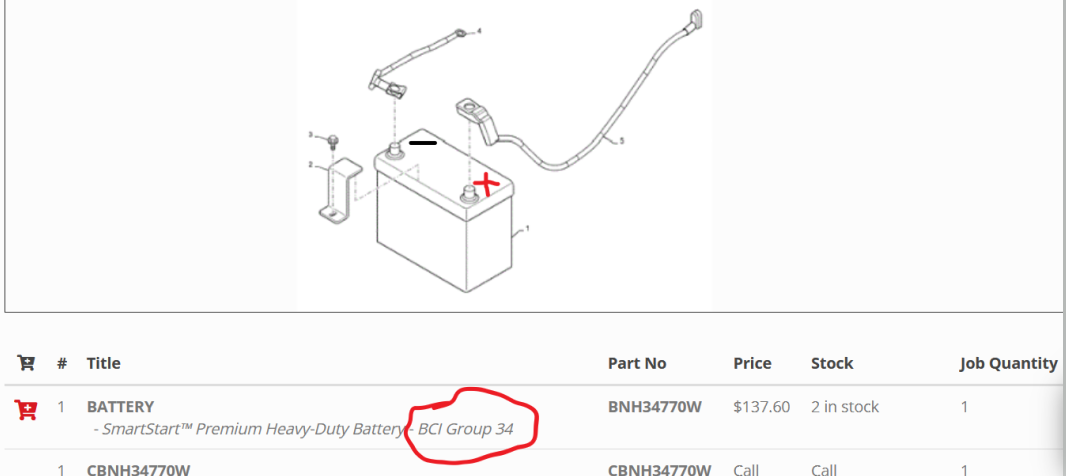

The online New Holland Parts lists a BCI Group 34 but I think the polarity would be a BCI Group 34R. A 24F ibattery s the same dimensions, just 1 1/8" taller.

  • So compare your battery dimensions to the 24F and 34R dimensions I have posted above.
  • Check the polarity locations of your positive and negative cables.
  • Take your old battery into your store of choice and and match it up with a new battery
  • By the version with the most cold cranking amps you can get
  • Install the new battery

Getting a BCI 34R would have probably bolted right in.
