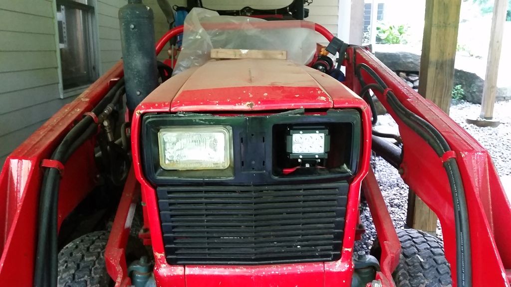

This isn't pretty but I came across a set of led lights for little money and they fit in the area where the sealed beams are with no modifications. I tried to find a led lights that were roughly 4 x 6 but no luck.

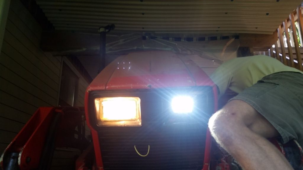

Of course they are brighter than the stock lights and use less amps by 50%.

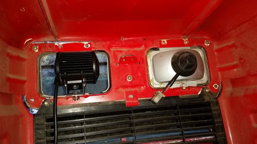

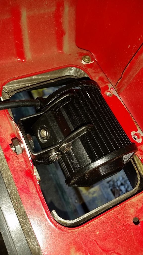

The top of the light wedges in to the top of the sheet metal opening and the bottom of the light mounts in the original stock mounting hole. I was considering making a shroud to go around the light but it's not worth the effort to me. I needed lighting up front and this should do the trick.
Look at this on eBay 2pcs 4inch 18W CREE LED Work Light Bar 4WD Offroad Spot Fog ATV SUV Driving Lamp | eBay

Like driving around at high noon now! :thumbsup:
