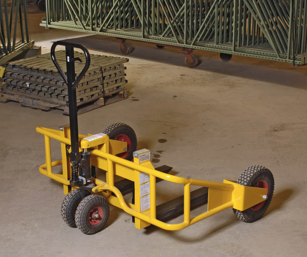

Here's an option. Use your tractor for snow and other stuff and get an All Terrain Pallet Jack to lift/move your wood?
This PJ has an "Optional Tow Bar" package. Not sure what that really is, but maybe you can tow it with a ball on the drawbar of the tractor. The PJ is $704 and Optional Tow Bar package is $178.71.
