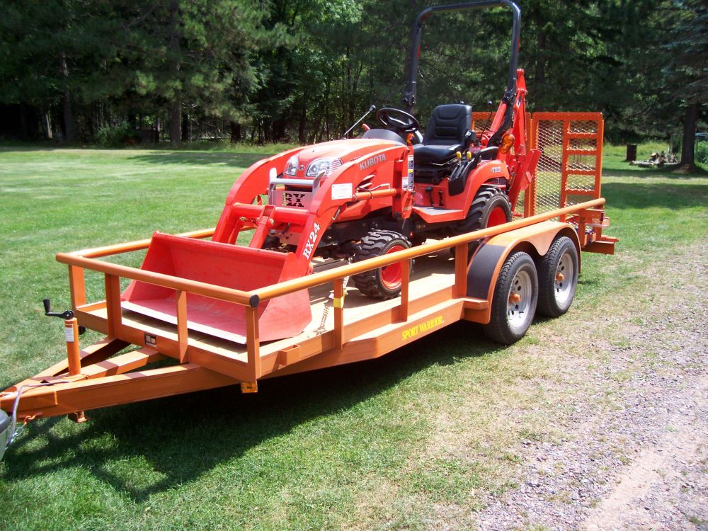

Hi everyone. I've been browsing here silently for a while and now I have a question. I am awaiting delivery of my new BX24 TLB :D:D: I am looking for a trailer to move it on. My questions are: What is the total gross weight with FEL and backhoe on? What is the overall length with FEL and backhoe on? Any assistance from current BX owners out there would be greatly appreciated. Thank you.
Matt.
/ New Guy with a BX24 question. #2
As a TLB, weight is about 2250#. With the MMM you're up to 2500#. I wouldn't tow it on any shorter than a 14'. 16'[ or 18' would be better. Dual axle 7000# GVW is what you want. I've seen guys tweak by with a 6x12 single axle, but I wouldn't. Go a little bigger, so you have some wiggle room if you want to bring along some implements, they're heavy too.

Bare minimum: 7,000# dual axle 7' x 16' transport/utility (non-landscaping) trailer. I've found that lots of landscaping trailers only have brakes on 1 axle.
I have a 10,000# 20' trailer which is a LITTLE overkill (not as much as you would think) but it has been a great addition to the armada. The 10K trailer weighs about 200# more than the 7k trailer, but I get that much more comfort in towing with that extra rating. Tows straight as an arrow and gives me some room to carry my stuff without piling it up on top of itself while loading.
Having had a 3,500# single axle trailer, I can say that it is inadequate to tow these machines on, even if within the weight limit of the trailer. The COG is all wrong. No bueno.
I have a place here local that sells 7k 16' trailers all day long for under $2k. I got my 10k 20' trailer for $2,500, but that was a particularly good deal. You could get them down to $2,800 on a good sale.

/ New Guy with a BX24 question. #9
You mean one of these?

Matt, I have had my BX22 for around four years now. I have 900 hours on it and have hauled it on a 5x10 single axle 3500Lb rated trailer, a 18' tandem 10K rated trailer and a couple of sizes in between. I have many years of towing experience. Some of what you have received is sound, some is questionable.
1) Never,... never tow with the bucket up. I have had the misfortune of being first on scene after a chevy blazer pulling a tractor loaded in such a manner stopped rapidly after running into a ditch. The tractor broke free of the bindings and made the trip into the back of the blazer which was occupied by several laborers. Front bucket should be down and if possible up against some sort of solid blocking device such as the front cargo bar of the trailer.
2) Absolute minimum length for a BX22 trailer is 14ft and that does not allow you any extra length to shift the COG. I have found that 3000Lb - 3600Lb 16' tandem utility trailer without ducktail works very well. I don't bother with ramps as you can loft the front up with the loader and then pi ck the backend up with the hoe and push the whole tractor up onto the trailer (actually if you leve the two vehicle in neutral you end up pulling the trailer under the tractor).
The beauty of working with small equipment is that you don't have to have the big iron to haul it around. I sold my 3/4 ton truck several months ago and now haul mine around with a 3 liter for ranger with no problems.
3) Unless your truck out weighs the trailer and tractor significantly then brakes are a sound investment. I prefer hydraulic surge to electric. But each has advantages.
4) Good ties downs. I pull a logging chain and binder across the main hoe hinge, a pair of binders around each side of the front axle. I also run a chain and binder across the fron of te bucket to stop the tractor should we have an emergency stop or accident that breaks on of the other three tie downs. I have about $300 in chains and Tie downs.
Having said all that. I'd recommend two trailers. If y9ou are into cars then themachine fits on a 17 or 18 foot car hauler with room to spare.
If you are handy and find yourself at Lowes or Home Depot frequently then the 16' Tandem untility would find more use in your stable.
How much you can haul with a small pickup is really a function of trailer brakes and operator experience. I am currently gathering the material to put togeather a 18ft tandem wheel over gooseneck specifically for the bX22 and my Ranger. It wil only be 5'8" wide and will be a bit higher than the utility as the whells go under the bed instead of outside the bed. You won't find one of these on the lot, but I want to be able to load and unload palletized material and the wheel over is the only design that allows me to do that from the sides. Hope some of this helps you a bit.
