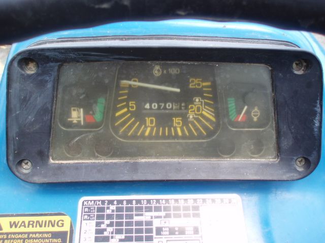

Here's the part that I'm curious about, step #2. engage PTO at 550. My RPM gage show's an RPM position for 540 and 1000:
Do you mean to get the RPM up to the 540 spot and then slowly engage the PTO? Step #3 has the RPM down low and #5 says to bring the RPM up. :confused: Is step 2 a parenthetical comment or is there something you are doing there?

First, I think that 540 RPM is the standard PTO speed, never 550 RPM.
I think he means that you want to lower your revs down to a fast idle and engage the pto slowly as you said you do.
Then, once the cutter is spinning happilly, crank the revs up to 540 RPM on the tacho.
I think you are doing it right allready.
The difference with what Rob said is that his tractor has a lever that engages the pto. But you then have to let out the clutch for it to start up.

Just to make sure everyone is clear on this, the speeds noted for pto on your tachometer are for the engine rpm to make the pto spin at that particular speed. Or in other words, the speed the engine has to turn in order for the pto to be turning the rated speed.(540/1000, etc)
Those are NOT engagement speeds and are subject to tear something up if your not extremely lucky. Engage the pto at the slowest possible speed, lowest possible load, and increase speed/load after it is engaged.
Just wanted to make this clear,

I appreciate the help, Spiveyman. Our set-ups look pretty much the same, so I'll pretend I have a Ford until I get my manual.
Is my monitor blurry, or does your dashboard show 4000 hours? Wow, that's what I call getting your money's worth out of a machine. I was feeling bad about putting 10 hours on mine already, kicking it up to 613 hours.
