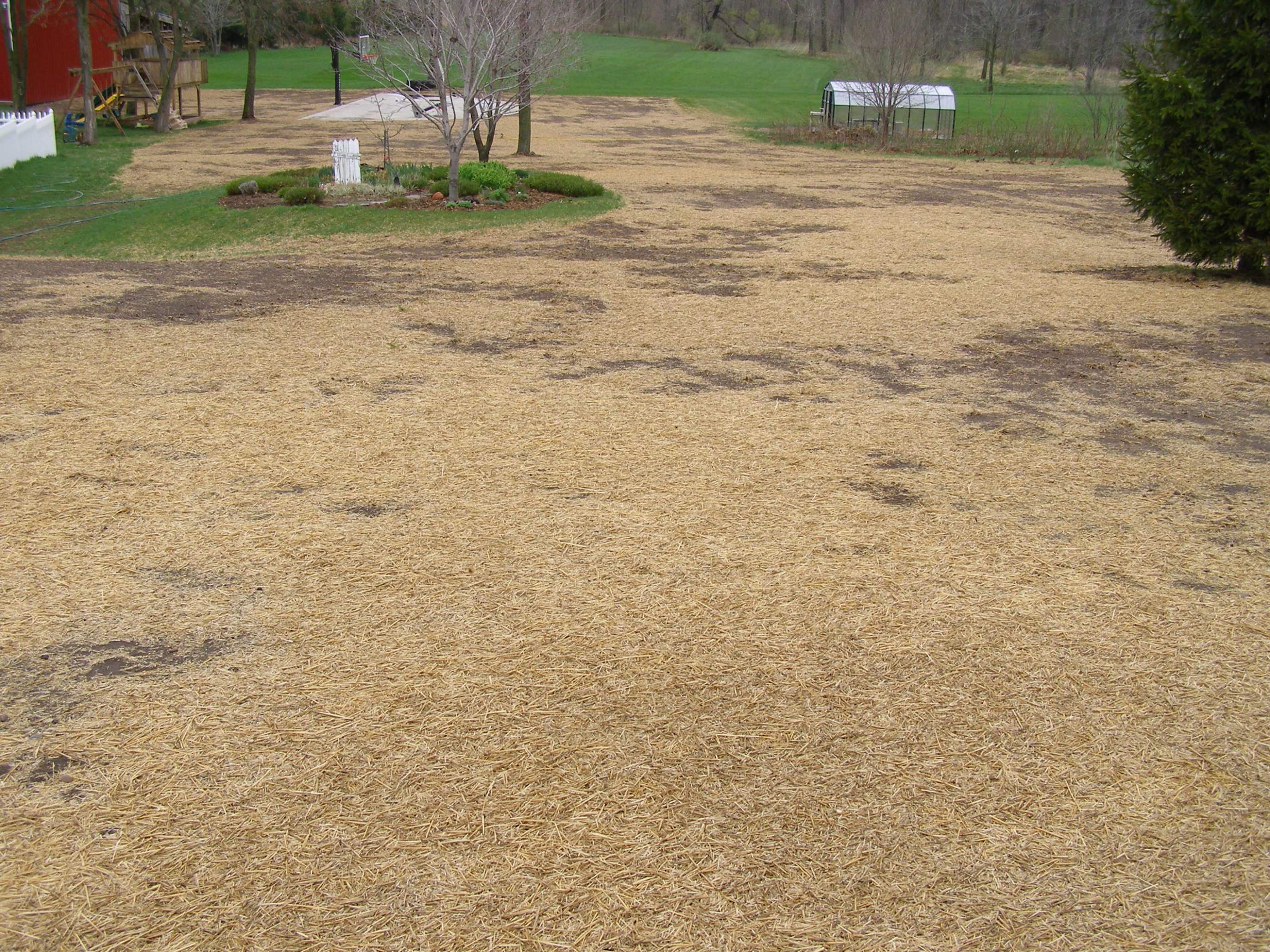

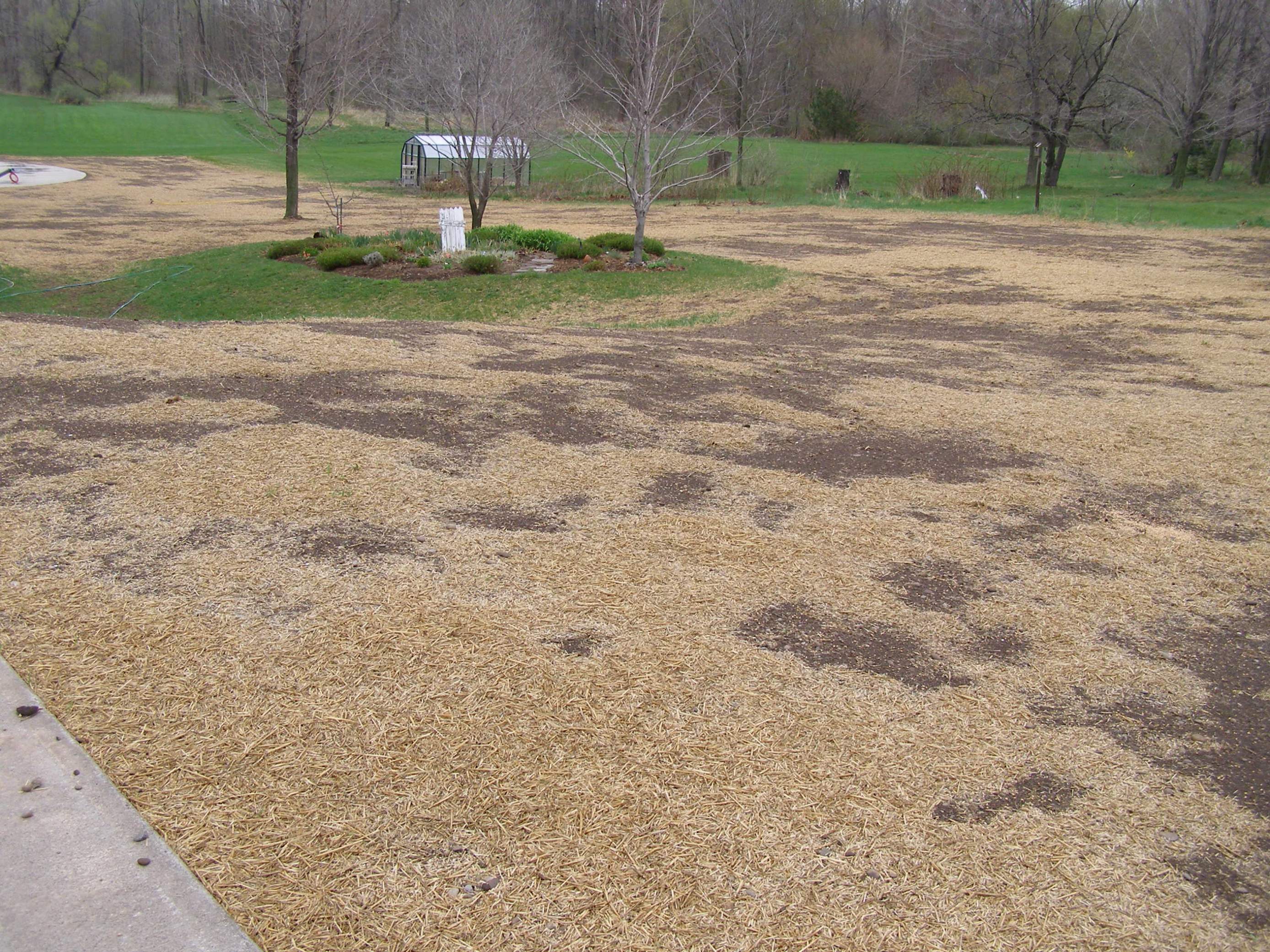

I seeded my lawn last Saturday, 4/18, and no sign of any growth today whatsoever. I live in Western New York. Here's the background. Last fall I used round up to kill the grass, then I rototilled it. Total area of about 1.5 acres. In March, I landscape raked and graded it. Last Saturday, I spread triple 10 fertilizer, then had someone harley rake it, then I broadcast seeded, the he blew on mulched straw. The problem is that I've encountered the following conditions since:
Saturday (day of seeding): 20 mph winds, sunny, and around 59. Low in 40's.
Sunday: 20 mph winds, cloudy but no rain, and around mid 50's. Sunday night low in 40's.
Monday: rain all day with highs in the low 40's. Overnight low in mid 30's but no frost.
Tuesday: same as Monday.
Wednesday: Clearing, but still in the 40's. Overnight low in high 30's.
Thursday: Sunny, high in the 50's and winds around 20 mph. Low in the mid 40's.
Friday and Saturday: Sunny and warm, high near 80 and lowes in the mid 60's. Saturday night, heavy rain and low around 58.
Today: sunny and 60 with winds in the 15 mph range.
About 40% of the straw is either gone or setting on other areas where straw remained intact. Where the straw is gone, I don't see any visible grass seed (or grass for that matter). There is no peach fuzz apparent anywhere. If I lift the straw, I see seed underneath, but no visible germination.
My question is at what point do I bail and just reseed? I'm afraid that with the cold nights and heavy rains, the seed may have spoiled. Any advice is appreciated. Thanks!

sounds like you havent given it enough time.i seed yards all the time it takes anywhere from 7 to 21 days im my area,,[ tennessee ] dont give up yet ...just give it time . some my have washed away...but if you are using fescue. it is a cool season grass it loves cold nights.. when it comes up you can go back and scratch the areas that didnt come up with a hand rake and just put more seed on your bare spots..it has happend to me on more than one occasion ,,,good luck Bruce neal tractor works

germination temps are much higher than regular growth temps for fescue. anywhere from 50 - 60 degrees and plan on 10 days at that temp. lower temps take longer. keep in mind this is soil temp and air temps are usually quite a bit higher.
keep it moist and give it another week or two. unless you used old seed, you should see growth once night time temps stay warm enough that the soil sees a constant 50 degree temp. use a themometer to check the temps first thing in the morning to see what your soil is doing.
also keep in mind that watering will lower the soil temp due to evaporative cooling so even if the day and night temps are warm enough, the moist soil will be cooler. this is one of the many reasons you should seed a lawn in the fall....

Yep, keep it moist and be patient. You might re-seed the areas blown clean, then recover them with straw/grass clippings to retain the moisture. I have found it takes a VERY long time for the seeds to crack if they don't have nearly constant moisture.

The area in the pictures behind the new seeding were done in late August a couple of years back and I was mowing before the end of the season. I didn't have the luxury of a fall seeding this time though because I tilled too late in the season. I didn't get my tiller until late October. Thanks for the advice.

If you dragged the area after seeding it, there will probably be enough seed left in the soil. If you didn't drag it before blowing on the straw, then your seed is likely drifted into the same areas your straw moved from the winds. Either way, time will tell. The soil temps should just now (after the past few warm days) be right for germination. The next good soaking rain should kick it into gear and you'll see the fuzz a few days after that. The difference between now and when you fall seeded is the soild temperature. Fall seeding takes advantage warmer soil left over from summer heat.

I quit using straw for my installations unless it was very dry conditions and watering was difficult. It ends up being blown around by the wind most of the time and straw usually has a few weed seeds in it as well.

That's what I say. The ground is too cold. And putting straw on top of it, is not going to help the sun warm it up any time soon.
I wait until the ground is about 65 degrees to plant grass, and only use straw or mulch, if it is a dry season. You should get enough rain this time of the year to be able to get by without it. Then the sun can get in there.

I used a 33/33/33% mix of fescue, ky bluegrass, and rye (all cold season grass). I saw some patchy peachfuzz today for the first time. Mid 80 degree temps and moist soil helped. Very patchy though with most of the area still barren dirt or piled straw.
I used a total of 90 lbs of seed initially followed by around 10 lbs of additional seed I used to patch areas that blew away. It looks like most of those 10 lbs blew away too. I still have another 10 lbs in the bag.
The total area is around 1 to 1.5 acres so the rate was about 2lbs per 1000 sq ft. I seeded twice that area with 34 lbs 3 years ago, but it was in the fall.
Some of the straw in spots is pretty thick due to the wind blowing it around. I'm somewhat encouraged since I'm getting peachfuzz, but I'll follow up with 2 weeks of patience and post a couple more pictures. At that point, I'm not sure if I should throw down another 50 lbs on all the bare areas, but I don't know the best way to put it down to ensure it stays there instead of seeding all my neighbors lawns. Thanks for all the posts. Additional advice is welcome.
