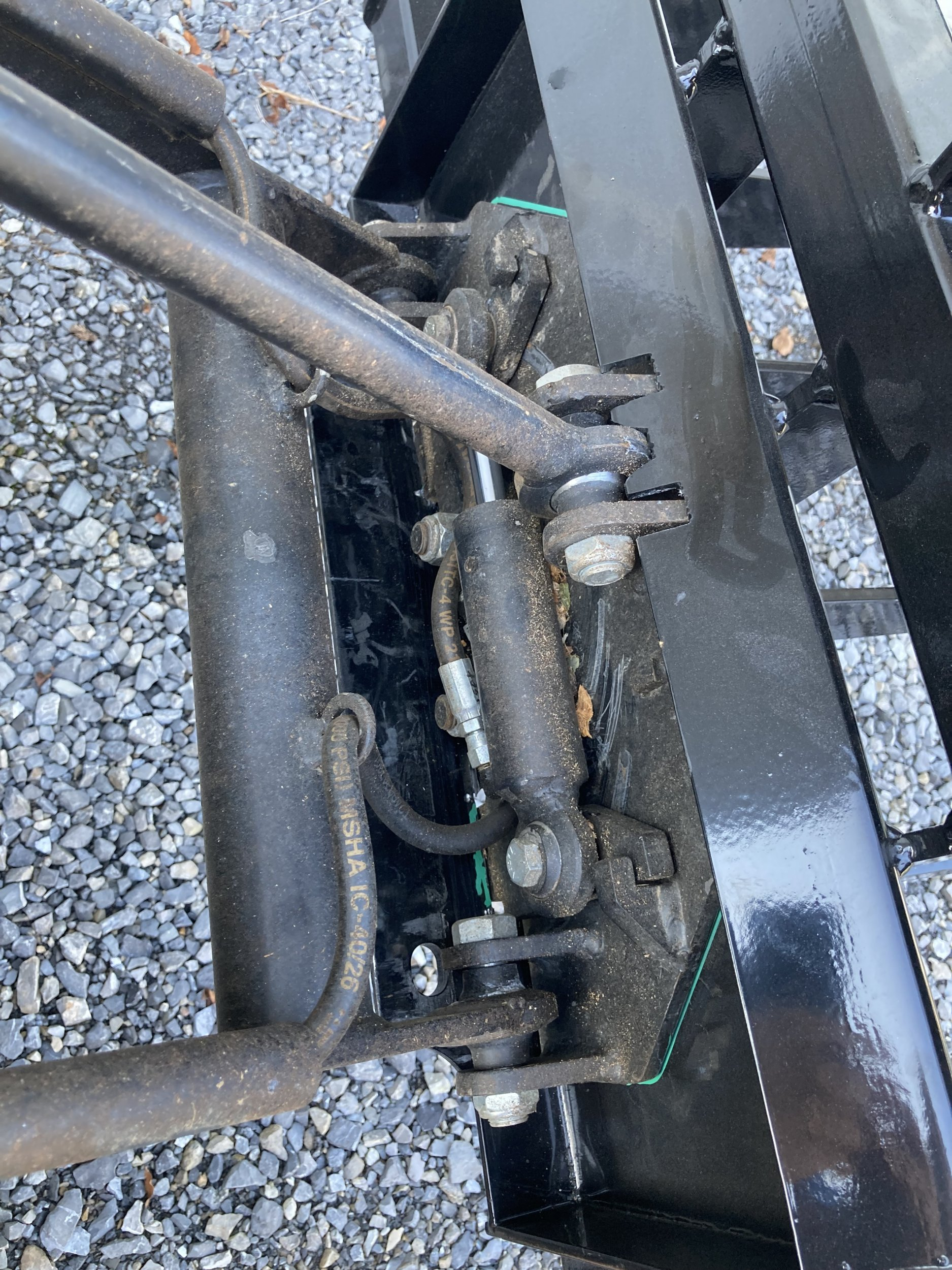

Power Trac PT425
I got a mini-skid grapple on Friday and it was an easy adaptation to the PT425 mount. Even with my limited skills and tools.
Still need to add the side stabilization plates to the mount.
Working on the hydraulics later this week or likely next.
It is 240 lbs so no big tree trunks but lots of brush and trash to be removed.
/ New grapple #3
You will love it. I use my grapple a lot. Just make sure you have a little clearance between the upper "dog bone" ball joint and the quick attach plate during ALL phases of movement and load. You don't want the quick attach plate putting load directly on the outside of the ball joint as it will wear quicker and could deform it. I am always surprised when I think I got it, then I make some odd move and then I see interference.
/ New grapple
I will pay close attention and likely cut out a little more of the mini-skid top mount. Thanks for the advise.
