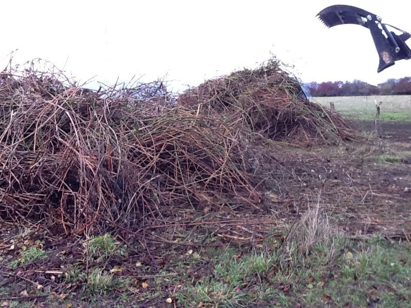

I have a rake style similar to Kytractor's in this thread but with not as long of lower teeth. Mine is great for what I bought it for, grubbing and burning brush. But I can't pick up logs very well with it. I can, but I end up re-gripping a few times. Kytractor's Anbo looks like it can pick up logs much better than mine since his lower teeth are longer. The "L" shape lends itself to getting under logs and general debris. If you are going to dig out heavy roots, then narrow is better as the wider you go the more chance of stalling out. So it all depends on what you use it for.
