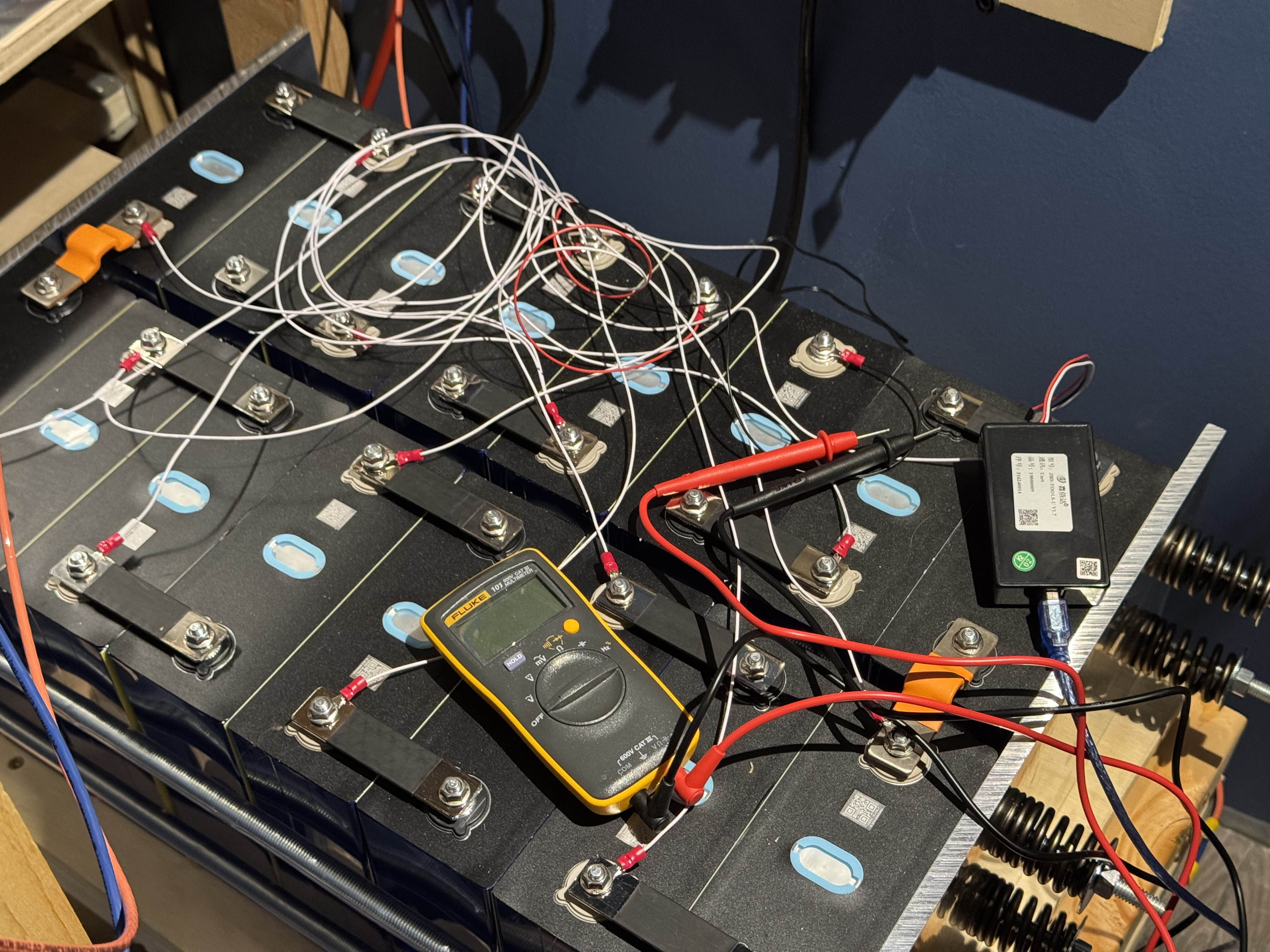

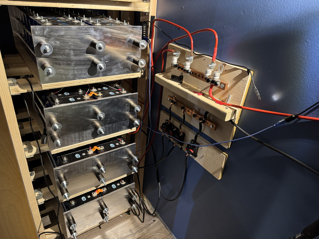

So I went to the pack and checked it with multimeter and it is checking at 3.63v, so something is wrong with the bms or crimped end or ring terminal that's creating resistance. I'm going to take it off and redo it.

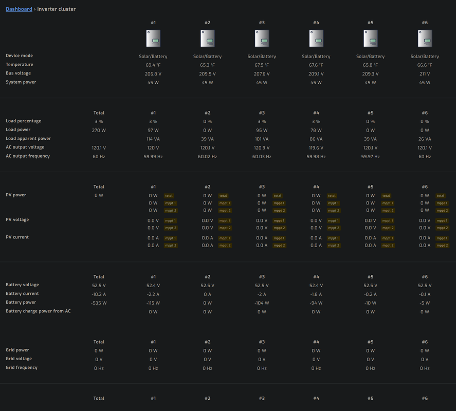

3 packs totaling 45kwh are in opperation, and the 4th pack is built and just about ready to start charging.
I have space for 2 more packs at the top, but I'm going to see how this does me for now. Once it's done, I'll start working on getting the other inverters online.

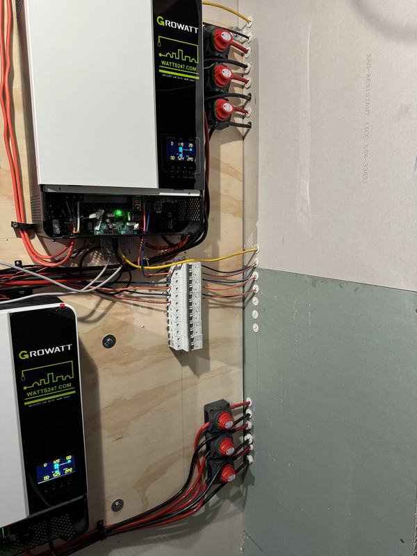

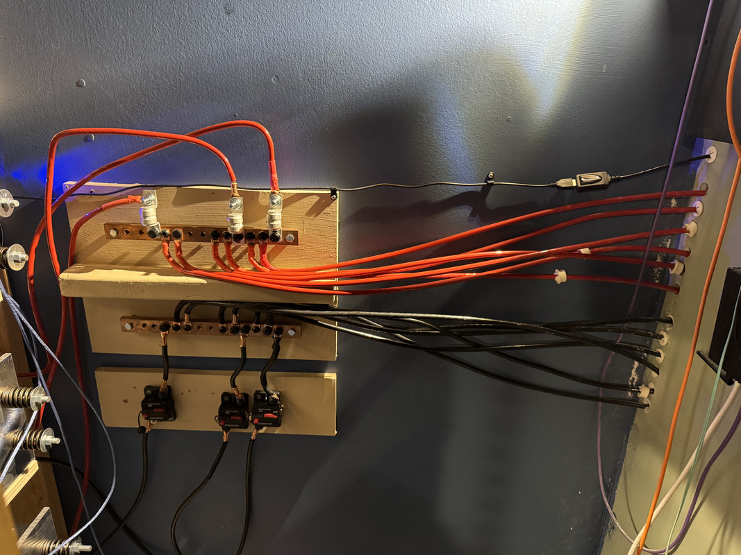

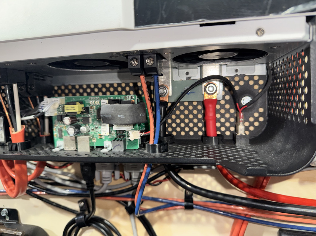

Now that 3 batteries are online, and a 4th top balancing, I can take some time to get more inverters hooked up. Got 2 more inverters nearly done. Cables run, ends crimped, heat shrink on. It almost looks professional.
I hate how the negative lug is behind the pv wires though.
   / New garage time!
#1,494

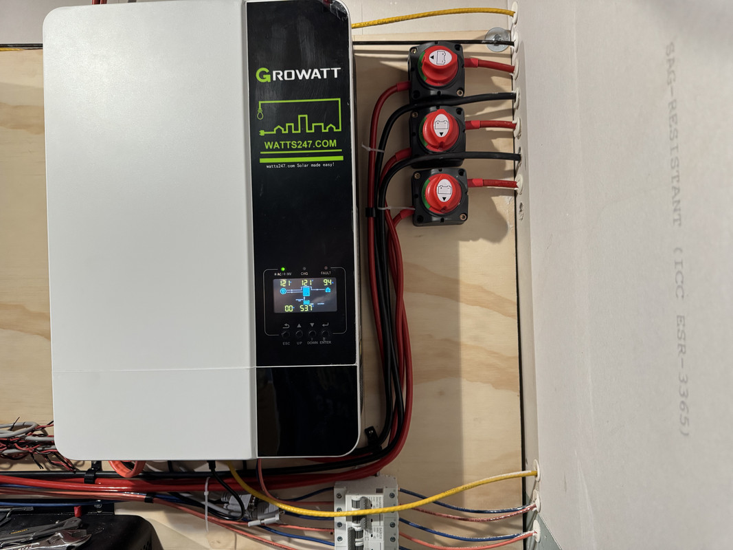

Aww yes...
So I can't quite figure out how to get SA to change the order of inverters, or be able to label them. It does what it wants. But I can infer which ones are which by looking at load.
Everything is online, split phase, cables wired properly, current sharing, 18kw total, 9k per leg.
Tomorrow, more battery work.

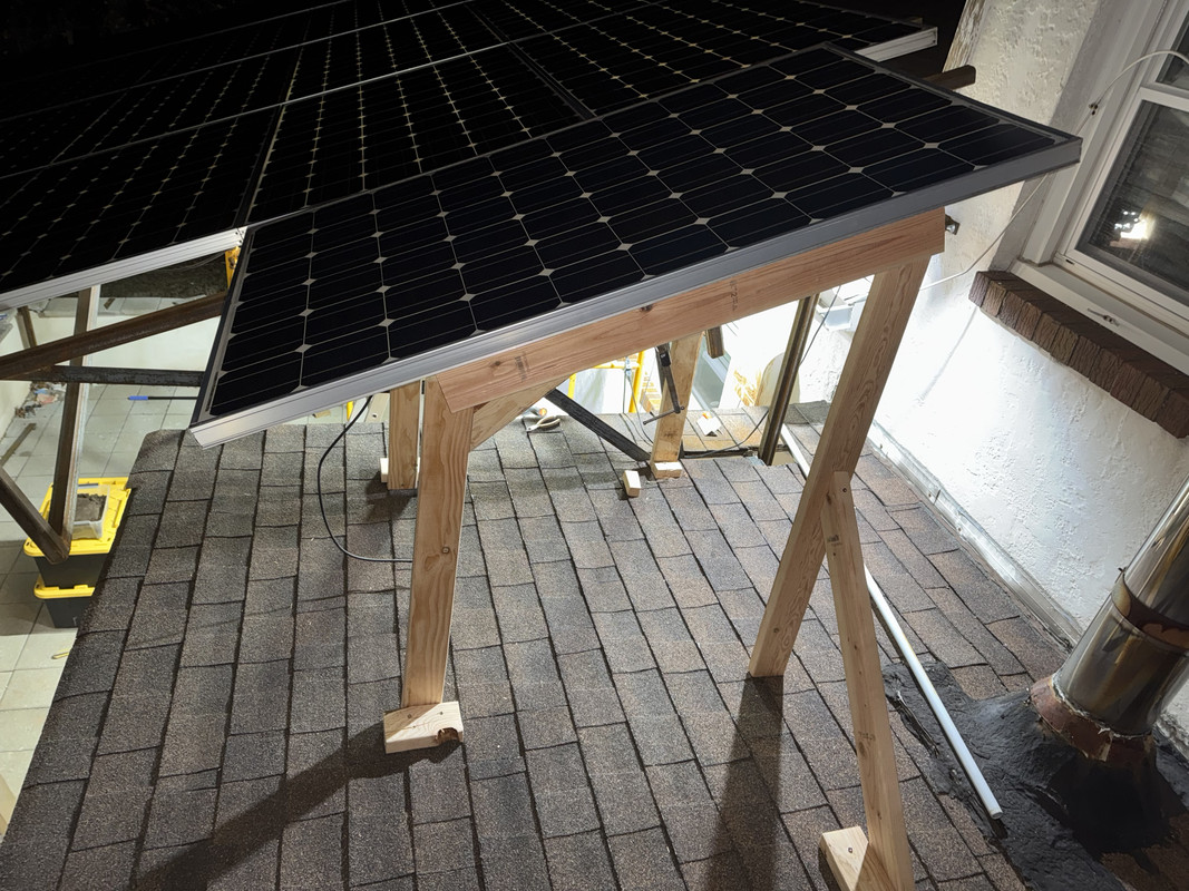

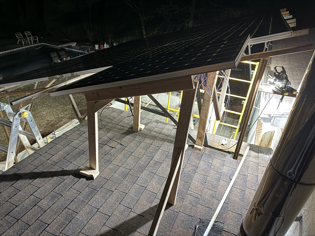

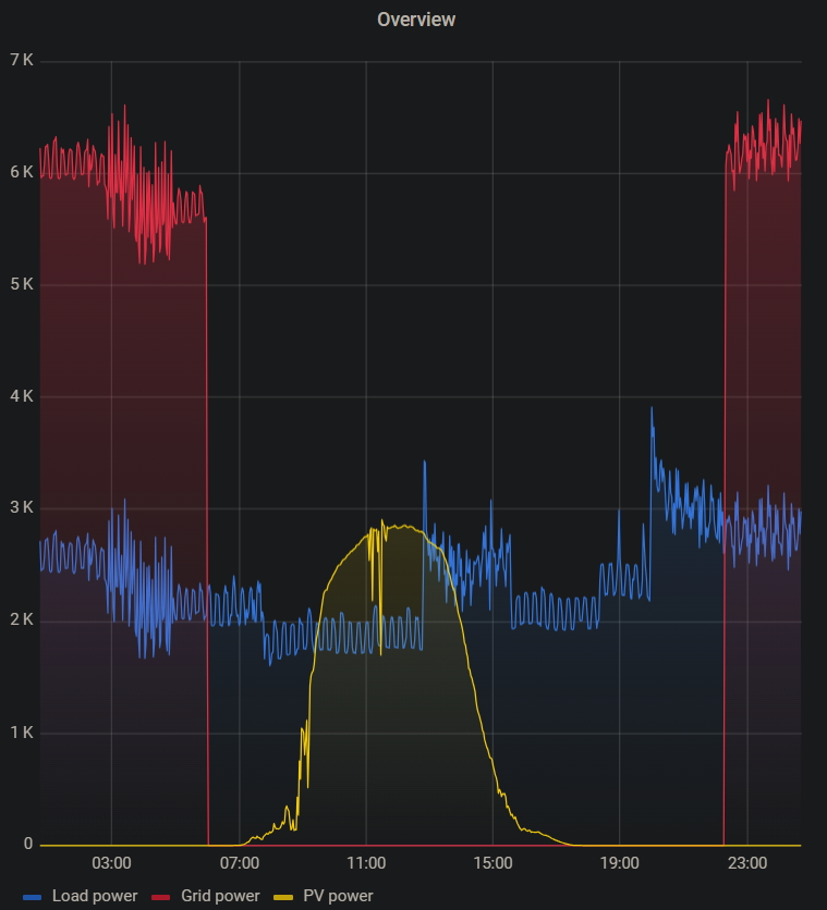

Well I cranked out 14.5kwh today from 15 panels, and there were some dips.
I have 24 panels up in a 6x4 grid, but I'm running 15 panels per inverter. Which means I had 9 up and doing nothing.
So I decided to put one more up, and wire them up in a 5s2p instead of 5s3p.
This is a very temporary setup. I rigged it in a way that it would not interfere with me putting up the rest of the racking for the second set of 24 panels. I need to drop the back end by about an inch.
All I am missing is some bus bars so I couldn't wire them into the combiner box. I'll pick them up tomorrow then hook up some wires and I'll increase my generation by 66%.

I filed plans with the township to get approval and the zoning was approved, but the one guy is looking for a structural engineer signoff. I called 3 SE's and none will touch anything they didn't design themselves. Which is really irritating.
   / New garage time! #1,497
Could be a challenge. Best of luck.
   / New garage time! #1,498
Is this for the solar array structure, or for the barn/shop/garage? Or both?
   / New garage time!
#1,499
The solar array structure over my patio since it's a "roof" for my patio.
