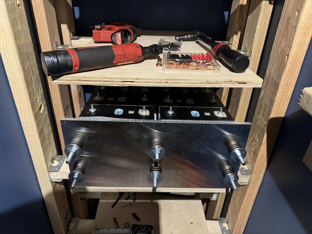

What are the springs supposed to do?
   / New garage time!
#1,472
Apply compression, while allowing room for expansion.
As the cells charge, gasses form inside, causing bloating. This causes the cells to expand in the middle. This is bad. With applying 700-1600lb of clamping force, the gasses form, but are uniform throughout the cell, not just in the middle.
Attaching a rod with bolts on both ends and wrenched down to 10ft/lb provides 1600lb clamping force. But when the cells expand, up to 3%, that clamping force increases with no where to go and can damage the cells.
Having springs allows me to clamp down and create pressure to have uniform cell expansion, while allowing for the expansion itself.
   / New garage time!
#1,473
New posts up, orientation switched. Problem solved.
Got a template made and banged out 2 plates. Ran the all-thread through, covered in 3/8" tigon tubing over it, mounted springs, and it's ready for cells.

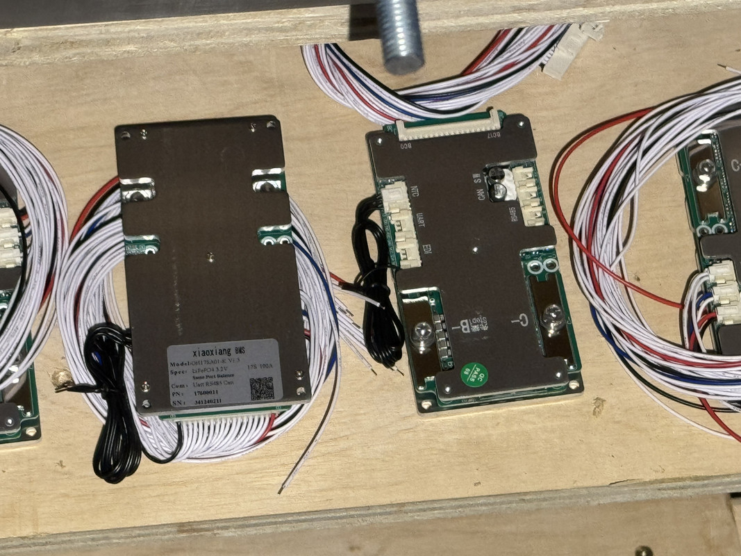

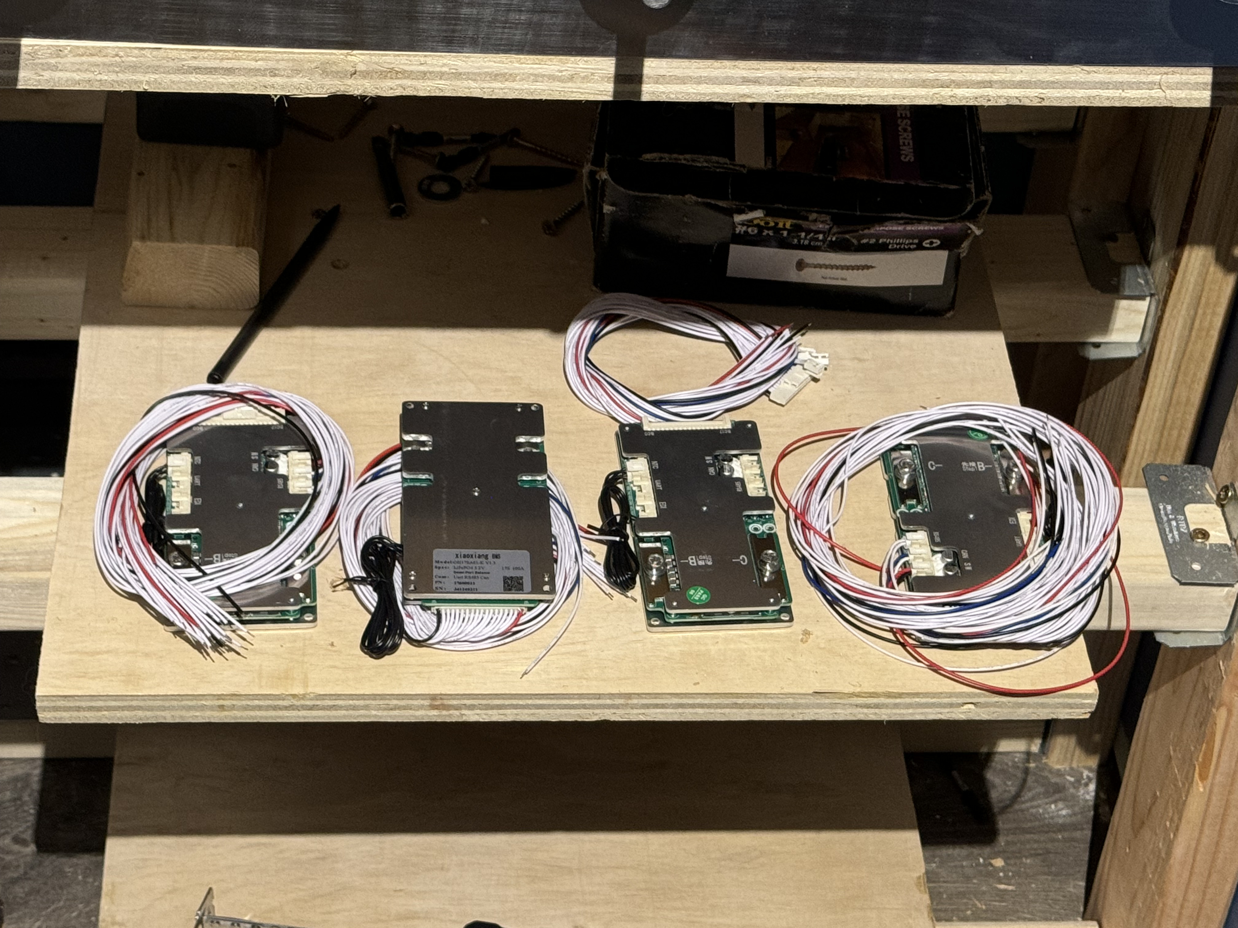

Got the first pack loaded and torqued to spec. I'm out of eyelets to create the top balance leads, so I'll head to the store tomorrow.
I also picked up 4 of the latest and greatest JBD 100a BMS. I particularly like these because they have ring termianls on B- and C-, as opposed to soldered leads.
Added bonus is RS485, UART, and CANBUS communications. Fingers crossed that one of them will be compatible with with the growatt inverters.

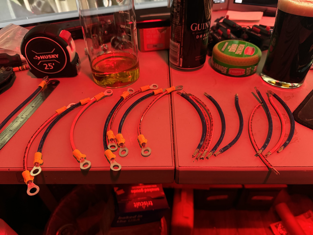

Step by step, top balance wires, made one by one.
