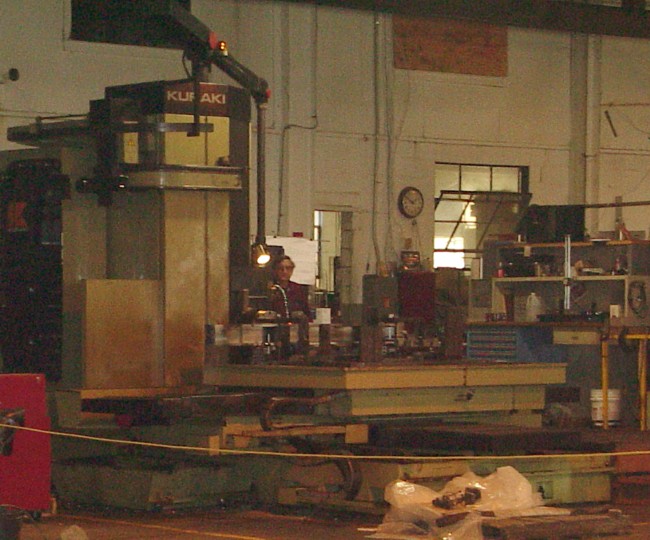

The machine will look similar to this one but the new one is much larger and is a 5 axis machine. It works into the thousandth's of an inch and can carve a name into an eliptical sphere if they wanted to. This company does a lot of projects other machine shops either can't or do not want to try. They do a lot of work for the Navy on Nuclear sub parts and parts for the reactors. They have two shops here and this will be the largest machine so far. They want us to build a new building for them as well that will have 30' walls and fill most of their parking lot for future machines since they have run out of room in the other two plants. I hope the picture shows up ok.

Yup it's a boring mill, or horizontal mill. Nice rig and a pretty good sized one. About the only way to machine large pieces. I'm trying to get a smaller one at work, can you come out and do the foundation? I know, you're booked solid with your current job /w3tcompact/icons/smile.gif

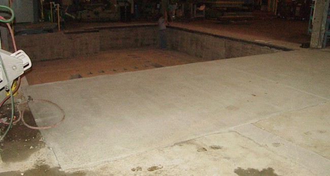

This is the foundation after the final pour and forms were removed. I will get one more pic once the machine is installed which should be next week. The upper floor is 8" thick and we sealed all of the concrete except for in the pockets.

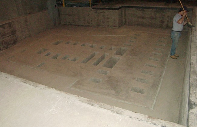

A view down in the pit
