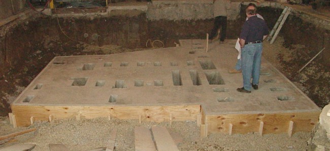

   / New foundation
#23
This is after the first forms are removed.

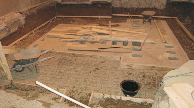

   / New foundation
#24
Lower floor formed and ready to pour.

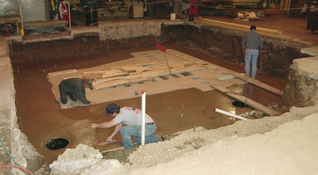

   / New foundation
#25
Lower floor poured.
