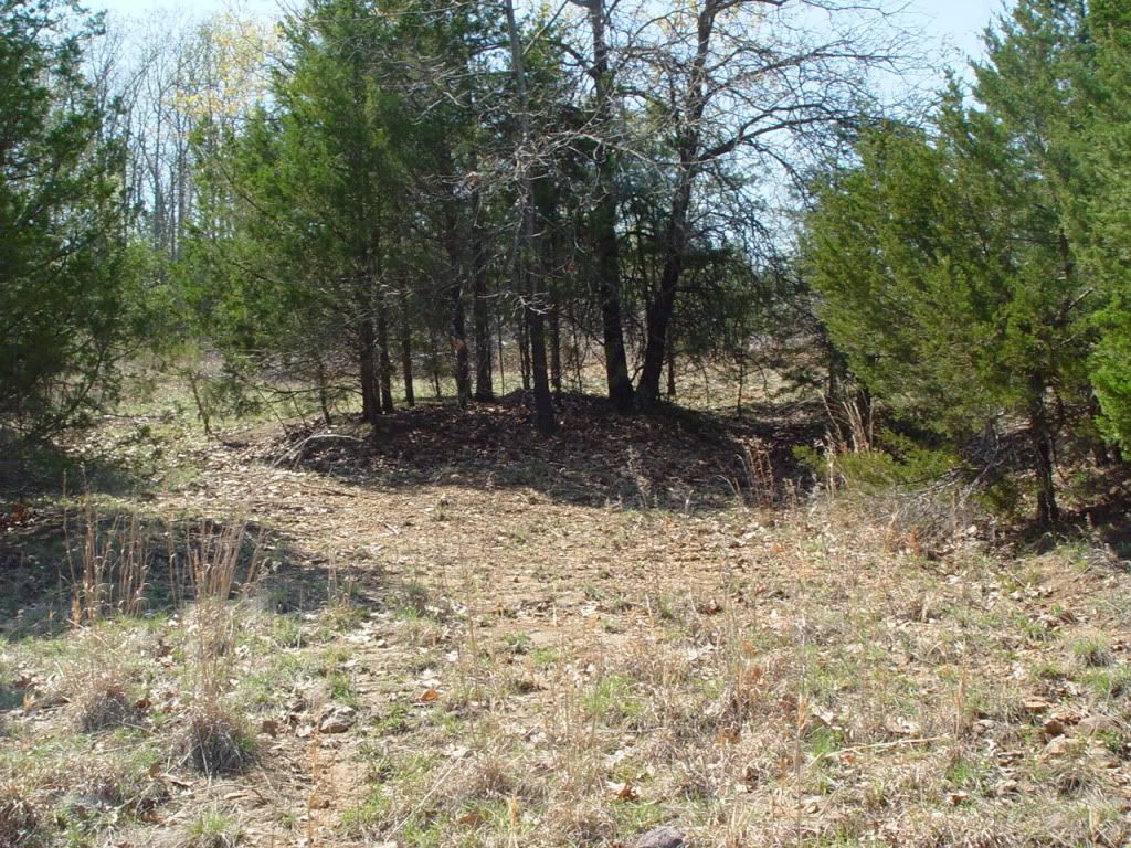

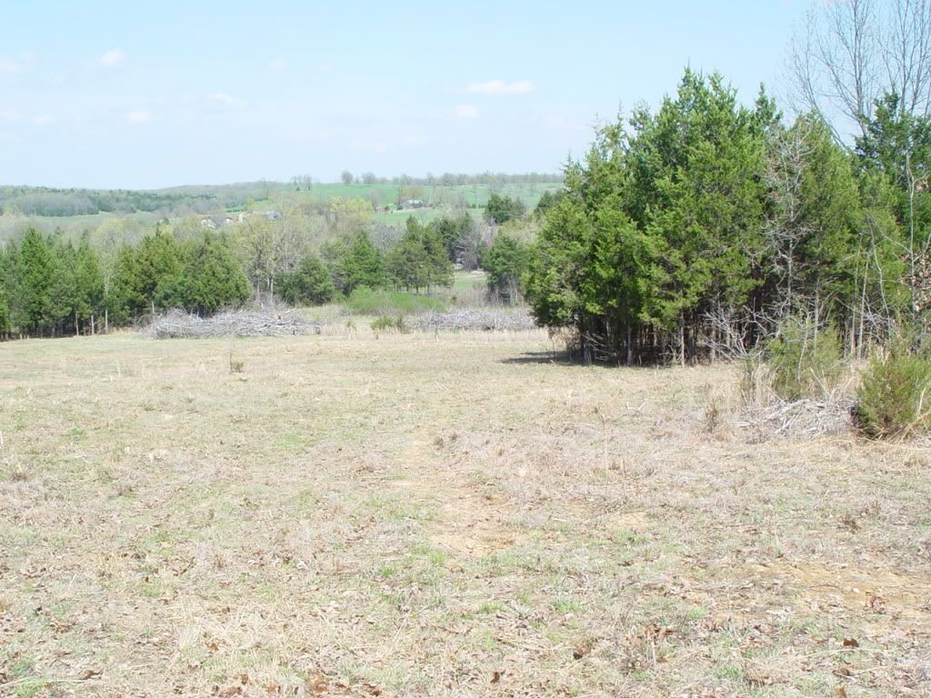

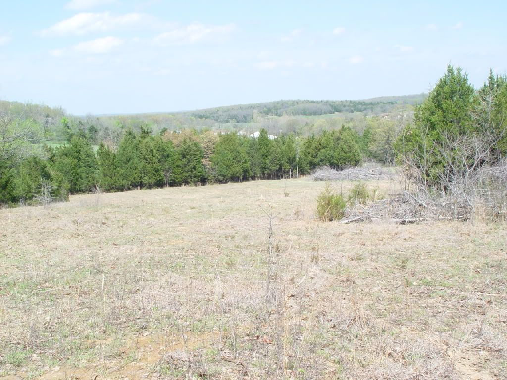

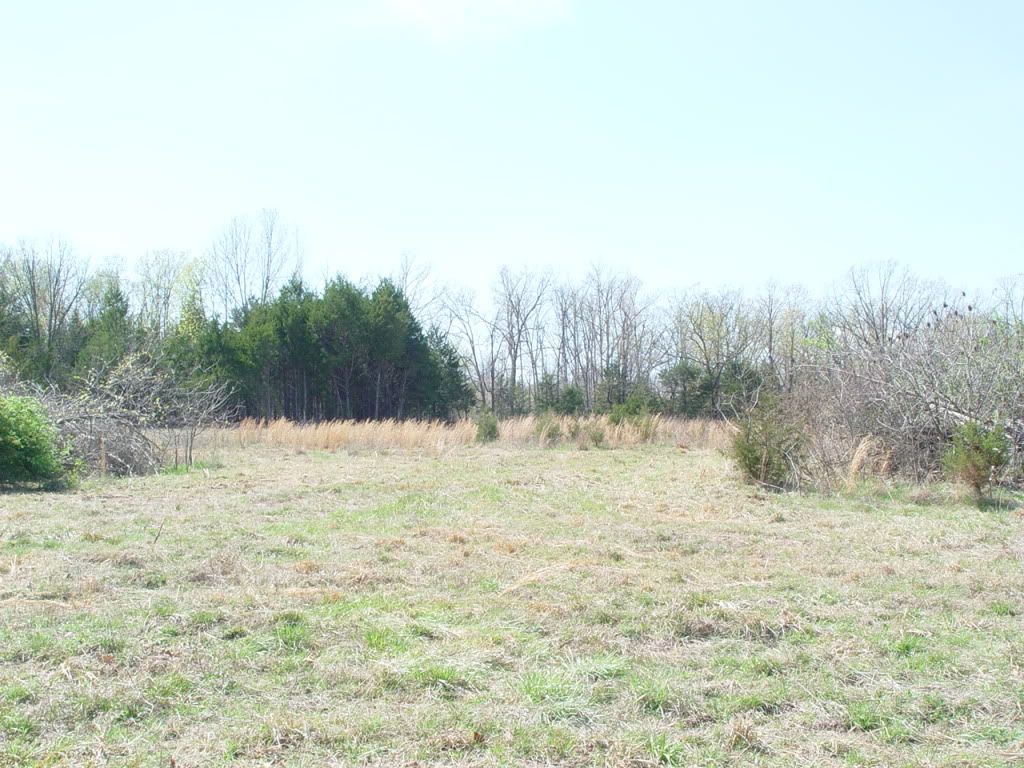

Have some property in Missouri, and approx 5 acres of it is/will be dedicated to a food plot. It was overgrown with weeds/grass/schmuck for the last 10 - 15 years, and I just brushogged it down to 5 inches. I'm wanting to prep it for a food plot but am unsure exactly how to do so. I'm thinking of spraying RoundUp on it this weekend, and then using a cultivator on it to churn up the soil in a few weeks. Then I would be planting Clover and turnips in raqndom patterns to prep for the fall. Here are a few pics of the area after I hogged it last weekend...
There is a LOT of vegetation left on the surface from the brush-hogging, and I need to know what I should do to correct the situation. I know that I have to churn the soil and return the nutrients to the Earth. But what tools do I need to do that?
Like I said before, I'm going to spray RoundUp this weekend to kill the existing weeds and non-beneficial vegetation. What should I do after the existing stuff is dead?

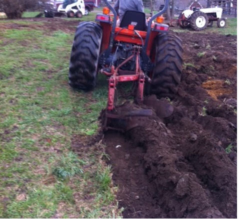

New ground like that I would spray it with Gly (roundup) hard! wait 10 days and the best way to do it is to use a 1 or 2 bottom plow. A plow will dig 8-12 inches deep and flip the dirt over. Then wait a few days to dry out and disc...
Pic of a bottom plow-

What horse power is that tractor? I have a 30 and not sure it will pull a two bottom.
   / New Food Plot Area - Need Ideas/Info.... #6
LoL- I knew I would get busted if I posted a pic like that.. Not my tractor just a pic someone sent me. :thumbsup:... I have the L3240 and like you I am not sure it would pull a 2 bottom very well. I have a-- one bottom and you know its back there when you are in brand new soil...
