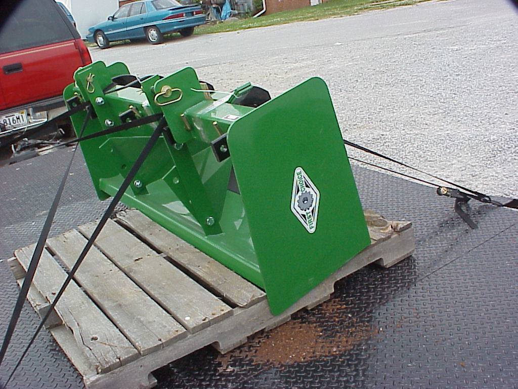

OK, Harv... Here's the pic's of how I assembled my box blade when I had a choice of which side to bolt something. Here you see both upright pieces bolted inside the attachment points.

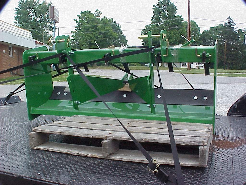

Harv, here's the other place where I had a choice and again you can see I went inside. Right? Wrong? Doesn't matter??

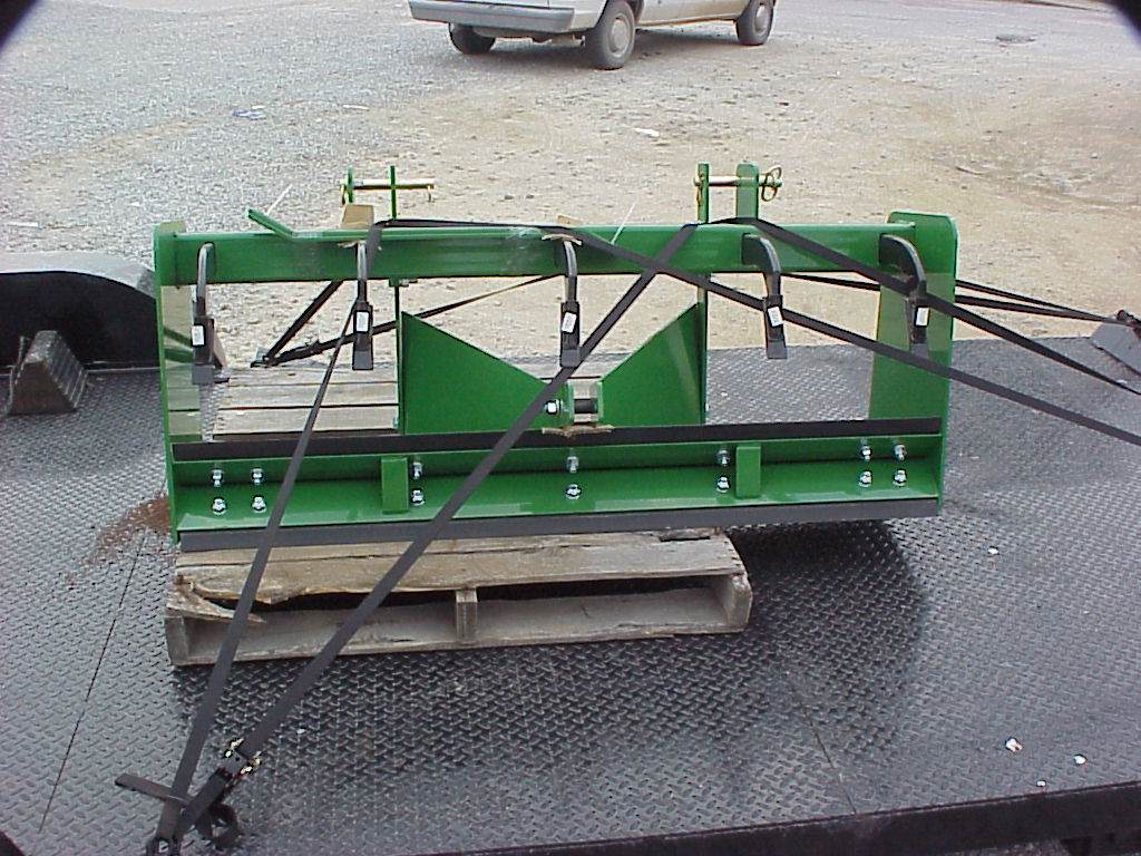

Here's the only thing I found thus far that I wish were a little different. Unfortunately, I don't see a real simple way to change it.
As you can see from the attached pic, there is a pretty tight space in which I need to reach to pull the clip from the hitch pin to allow me to adjust the depth of two or the five scarifiers on the 60" model I have. For me to get the clip out of the hitch pin I had to use a tool because I could only get the very tips of my forefinger and thumb in there and didn't have much gripping strength at that point.
Now, To be fair, I don't have the tiniest of hands (or feet, for that matter /w3tcompact/icons/smile.gif ), but I wanted to mention this in case there's a way to redesign it so that even those of us with big hands can have an easier time of it. Thanks for taking a look at this.

You asking me? Offhand I don't see what difference it would make to the general structural integrity of the thing. Seems like you'd want to leave the area where the top link attaches to the mast as free from obstructions as you can, but as long as there's no interference, I can't see the harm.
Then again, I'm waiting for one the TBN smart guys to tell us the real story.

Perhaps a different pin could be used, i.e., one that has a little ball at the end to keep is from sliding out, then there would be no need to have to get in there.

Congratulations, Gary!! You got it right the first time. We could use a few guys like you in our assembly department. Looking for a job?

That is a difficulty on the 60" models. Unfortunately, with the tine spacing as it is, most manufacturers compromise on the hitch spacing or reduce the number of scarifiers to avoid this. We didn't want to compromise on either point, so we ended up with a rather tight quarters on the 60" and 84". The 48, 72, and 96 inch models don't present that problem.
The ball detent pen is a good idea, though. Maybe we can do some testing to see if they stay clean enough to not gum up the detent ball and still work.

The pins at the base of my FEL supports are cotterless hitch pins, but it this area doesn't get as dirty as a box blade would. The only thing worse than a pin that's hard to get out is one that you can't get out. /w3tcompact/icons/laugh.gif

I understand completely. And I'd rather have five tines than four. /w3tcompact/icons/smile.gif Besides, I'll always have a pair of pliers with the tractor, anyhow. /w3tcompact/icons/wink.gif Heck, it'll be easier to pull the other three with pliers, too. I hate being forced to do something the easier way. /w3tcompact/icons/wink.gif/w3tcompact/icons/smile.gif/w3tcompact/icons/grin.gif/w3tcompact/icons/laugh.gif/w3tcompact/icons/laugh.gif/w3tcompact/icons/laugh.gif

have you thought of making a small hook? when i was little and couldnt pull pins off on my own my dad let me use and old metal boot lacing hook. it really did the job. you can use five fingers instead of two and can reach into tight spaces.

What is the possibility of getting a longer pin that would go all of the way through the bracing for the hitch. Then you could pin it from inside the hitch yoke. Just a thought.
