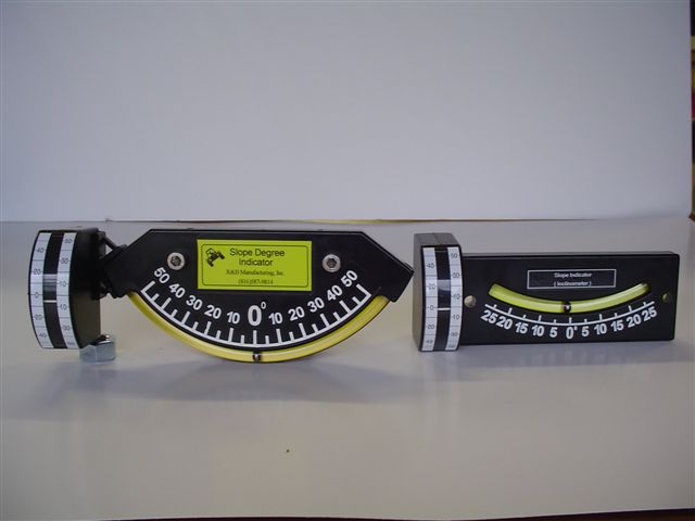

Hi Guys,
Here's the new model on left, and original on right.
I shifted scale 5 degrees higher, tilted body back 5 degrees,
and made numbers larger and X10.

I think the larger numbers will make it easier for old foggies, of which I am rapidly becoming one of. /forums/images/graemlins/grin.gif

/ NEW DUAL AXIS SLOPE INDICATOR #67
Rick, love the changes! /forums/images/graemlins/cool.gif
How will this connect to the tiltmeter? Still on one side?

Hi Mke,
I plan to offer two placement options for the dual axis part.
One on the side, and one on top. Not sure how to go about
it though. Two part numbers, and buyer must request
which one he wants? Confusing? I do not like the idea of
allowing customer to mount it himself. Needs to be done
correctly, or it will not be accurate. I have also dampened
the pendulum slightly more. Still swings freely. But can not
take much more out of it without causing a drag or hang-ups.
It will never work as well as side to side unit due to different
design. May make more elaborate design someday. Not
any time soon. Need to concentrate on selling for awhile, and
not so much on making new things. Hope everyone likes the
new dual axis changes. Thanks, Rick
