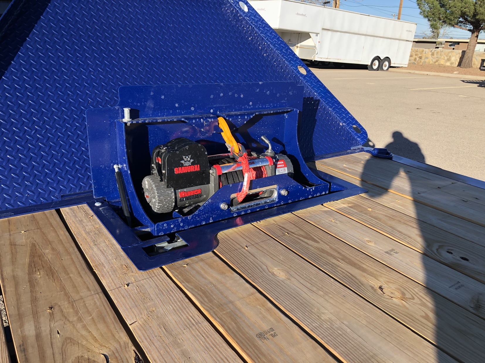

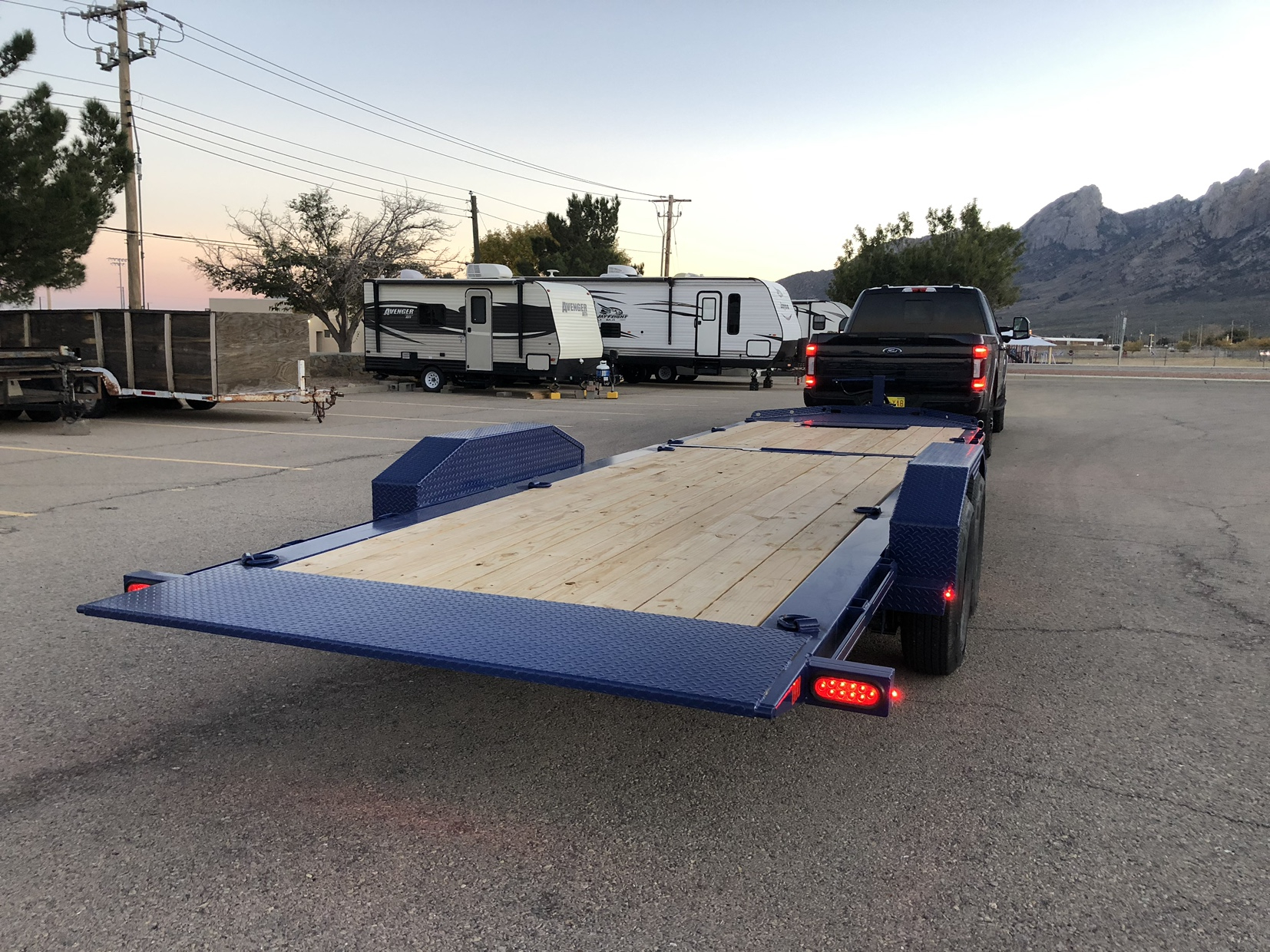

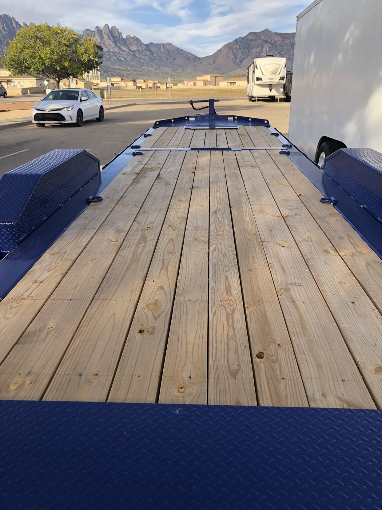

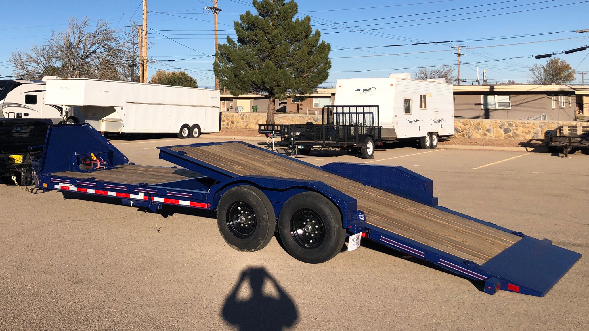

Special ordered a new 24ft Diamond C Hydraulically Dampened Tilt equipment trailer a few months ago and picked it up last week.
Options: 12K pop-up winch, 16ft tilt with 8ft stationary, dual 7K axles, 12 D-rings, full length stake pocket rub rail, 3/16” heavy duty fenders, solar charger, 12K jack, 8” I-beam construction, bed roller for winch line.
The tilt deck can be hydraulically locked up or down with a valve.
I had it de-rated from 14,900 GVWR to 14,699 GVWR to come in a pound under 26K GCVWR with my 11,300 GVWR F350. Weighs 4510lbs empty, 10,190 payload.

Never saw a pop up winch.

That is a super nice trailer, really like the set back axles. It will be easy to adjust the load for hitch weight. One thing I do question, is the stake pockets need spaced out from being counter sunk into the I-beam. Don't look like a 2x4 will fit.

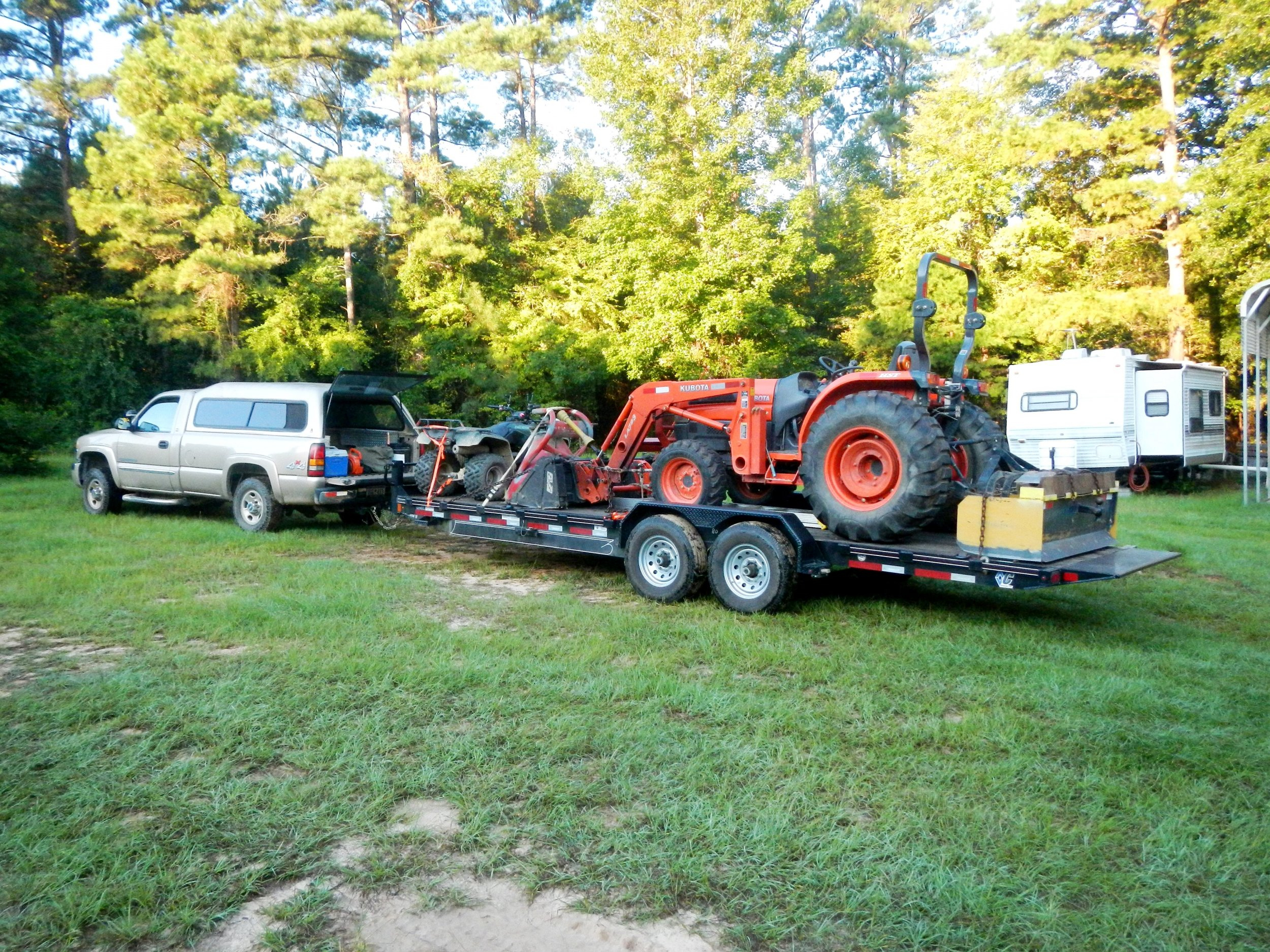

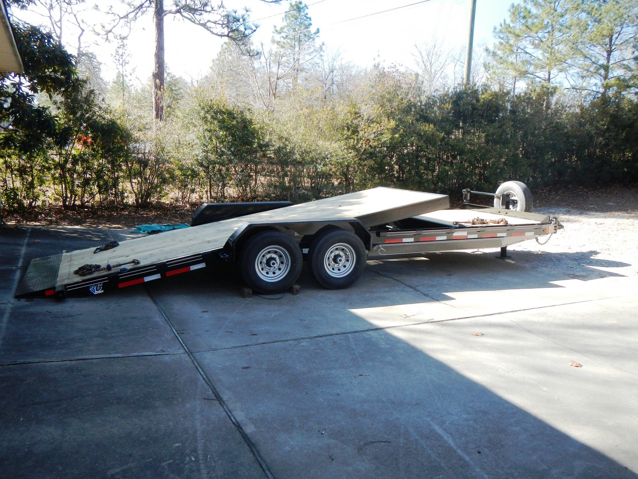

I have one of the older designs of HDT. Mine is 24 foot, (6 foot stationary), with the locking toolbox up front.
Question...using the winch to load a vehicle with the ramp down what method is used for the cable to slide over the lifted ramp? Pulley or some sort of Teflon/metal slide? I have thought about adding a winch to mine.

Recessed winch - interesting idea. Looks really good. Would like to know how that works out after a year or so.

Front jack looks setback somewhat - good.
Tilts where it should. With separate bed. also nice.

One question though, what good is a winch if you can't use it when the deck is tilted? Like, how would you use that winch to pull a dead vehicle on, on the side of the road somewhere? Also what keeps the winch from just trying to close its hatch under load?

To answer the question above, there’s a bed roller on the leading edge of the tilt bed that allows the winch line to smoothly roll across when it’s in the down position. If you look close you can see it in the pics.

Oh thanks, now I can make it out in the pics. Duh.

Thank you, I hadn’t noticed the stake pockets were recessed. I’ll have to get a 2x4 and see if it’ll fit.

The winch box has 1” steel pins that lock it in place and keep it from folding down under load. There’s a deck roller to prevent friction on the winch line while winching with the deck tilted. I’ll get some pics of the locking pins.
