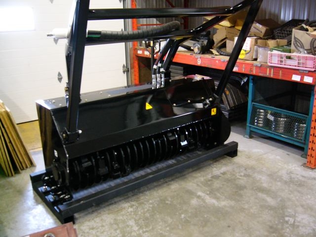

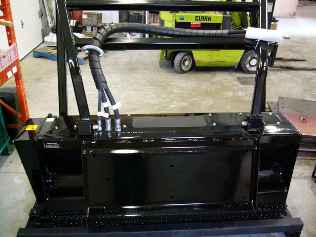

Here are a few pictures of the "limited editions". Black on black is a little hard to see.

I don't see the 500 on the DENIS CIMAF web site. What type of machine is it designed for and what material can it handle?
jmf
/ New DENIS CIMAF DAF-500
These are special series limited editions. Read the thread CIMAF head on supertrak 120 for how they came to be.
They are for high flow skid steers. Tracks or wheels and even custom units.
They have a 65" wide cutting width.
They require 30 gpm min @ 3000psi.
They will cut 8-10" material easily and bigger if needed, keep the rpm's up and 14" material will not hurt it. I can demonstrate if need be.

As for flow. If your flow is low it usually is only low on one. For example most tractors have 32+gpm at 3000psi or under. Or less then 30 gpm and as high as 4000psi like big cats. If we have one or the other we can compensate and tune to head and get good performance. Terra, with you having a little smaller machine you could still run one of these, they have the same specs as the Gyro HF-500. It WOULD be a good fit and your increase in production would blow your mind. Remember I used to have a Timberax and it's honestly no comparison.
Wt. 2400 lbs.
# of teeth 23
Cutting width 64"
I like to call these limited edition and the model is DAF-500's. They carry the same warranty as out DAF-180D's do. 6 month 600 hour. Parts readily availible.
