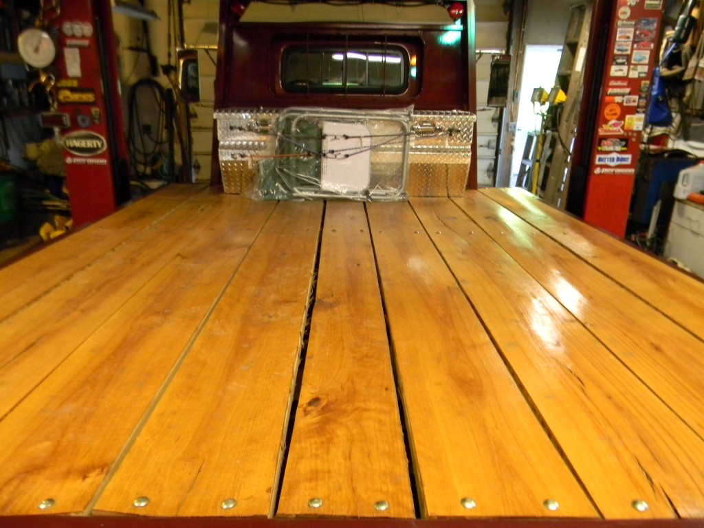

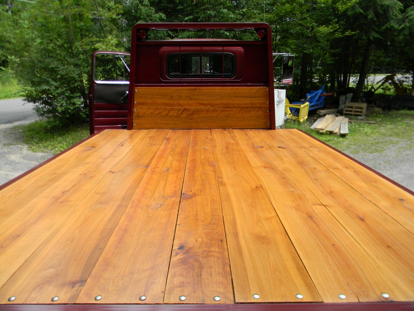

Looks good. Only problem I see is the wood is green and not kiln dried so it will shrink. I did the same thing last year. I installed freshly milled 2" x 10" x 12' hemlock on a classic truck bed. It was so tight I had to use a 4 x 4 and a sledge hammer to drive the last board in place. I fastened mine with Stainless hardware. Truck is a classic and hasn't been outside in rain since the install. Now, one year later the wood has dried some and I have 1/2" gaps between the boards and most have splits. Here's before and after pics.
And yes, you got a very good deal on the trailer.
