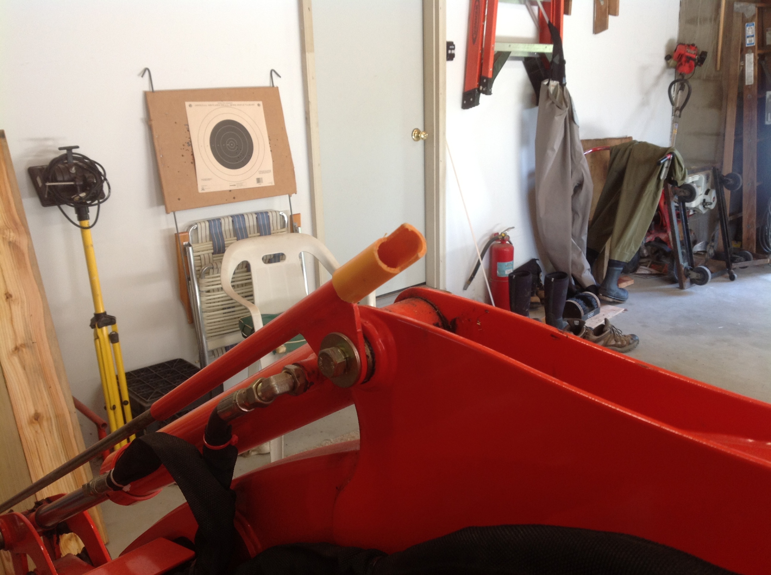

I just bought a new CK3510SEHC and on the loader level indicator when the bucket is level there is about 3 of rod above the indicator tube. Do I cut the excess off or is this the way it is supposed to be? I thought the rod was supposed to be flush with tube when level.
   / New CK3510SE HC question #2
That's what I did.
Just make sure the rod can't come out of the tube at full extension once cut.

   / New CK3510SE HC question #5
the rod should be even when the bucket is ON THE GROUND, level. If not, it's probably adjustable. As you raise the loader arms the bucket will not remain level on it's own, and the indicator won'd show level.

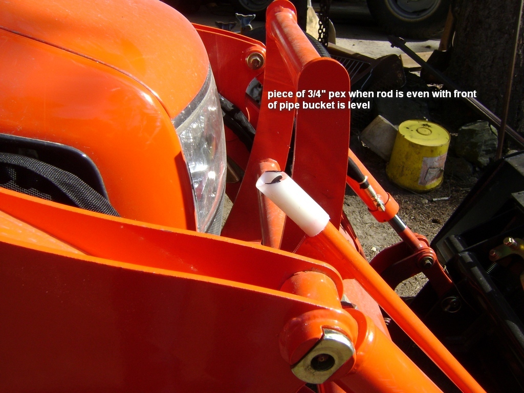

   / New CK3510SE HC question #7
I got the idea from Billrog. Bucket is level when the rod is even with the end of the pex. I cut out a section of the pex so I can now see how far below level the bucket is.
   / New CK3510SE HC question #8
I left 1/2" of rod outside the tube and cut it off there. It works for me.
Yes I should clarify that it is when the bucket is on the ground. I checked it on my cement shop floor.
   / New CK3510SE HC question #10
I personally just wrapped electrical tape for a level marker. The stock set up is pretty silly to me. But any mod that makes sense to you will work obviously!
