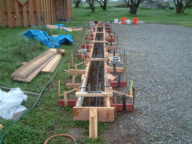

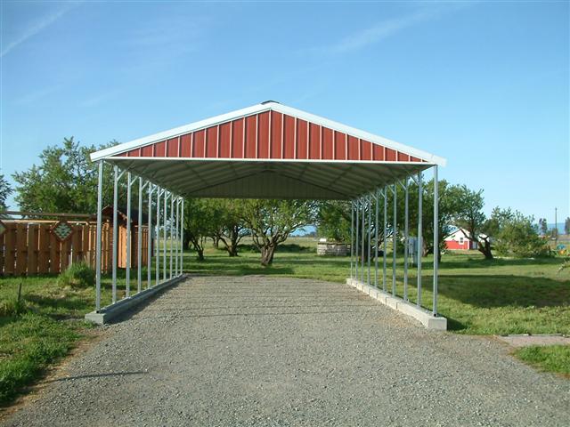

I've needed a carport for several years. So I finally got off my duff and started the project. It's 20'W x 35'L with 9' tall sides, A-frame style, gable ends, 12 ga frame. Vendor is American Steel.

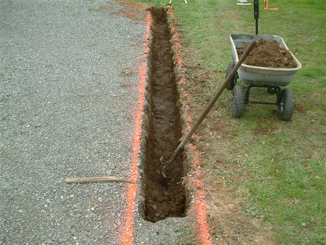

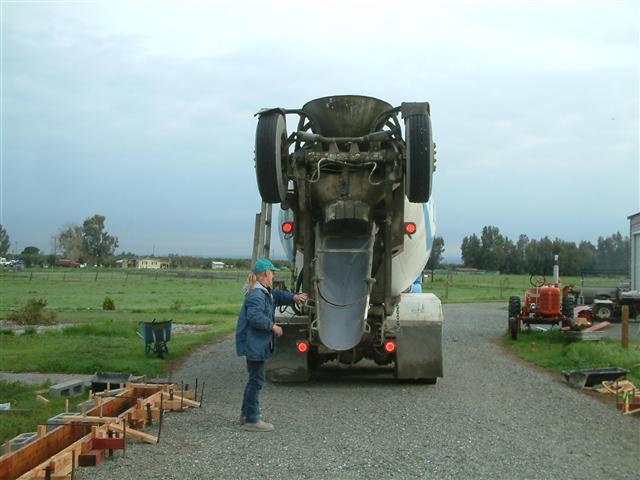

It goes at the end of my gravel driveway. Since I paid about $6K for that driveway, I didn't want it messed up with backhoes and/or skid steer equipment. So I dug the trenches for the footings (12"W x 12" deep into native soil, nominal) by hand. Installed forms and two runs of #4 rebar per code. Also installed pairs of 5/8" dia J-bolts for tie-down straps.

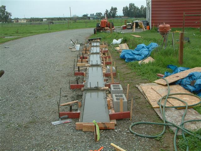

A neighbor who's a contractor helped with the pour--about 6 yards, 3000 psi, 5" slump concrete.

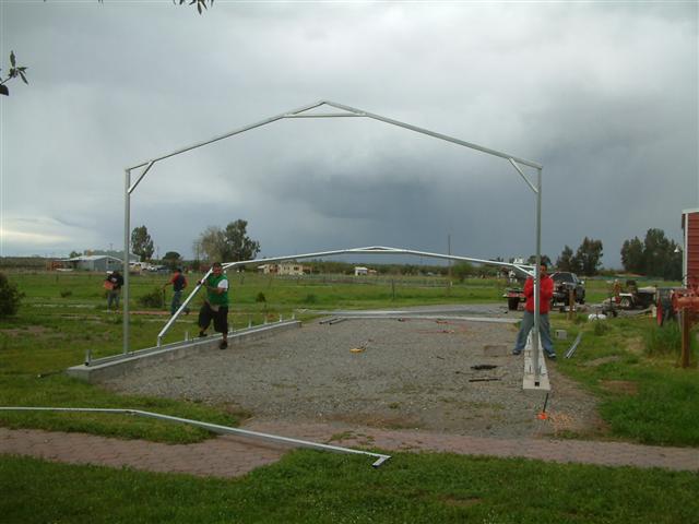

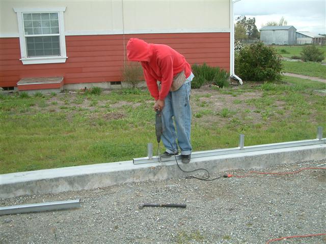

Being a belt and suspenders guy, I had the installer drill for 1/2" Redhead wedge anchors (12 total).

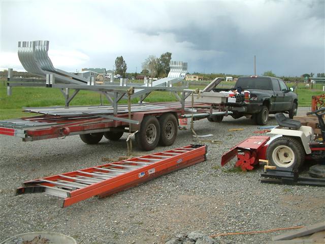

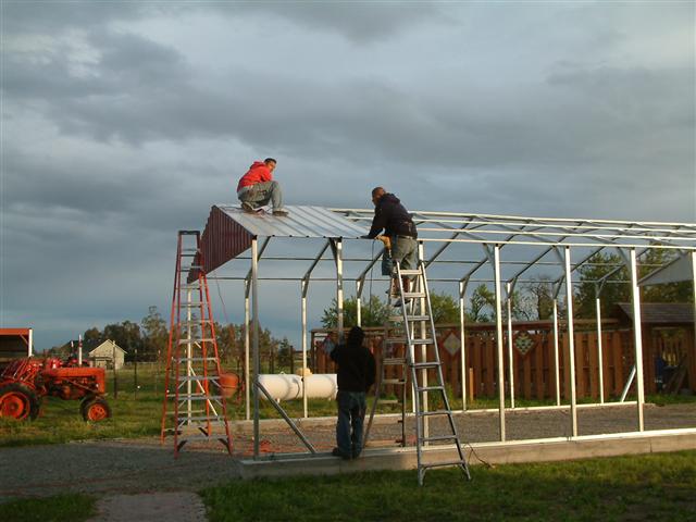

Four-man crew arrived 4pm and finished the installation by 8:15pm.

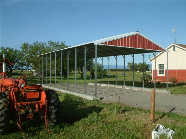

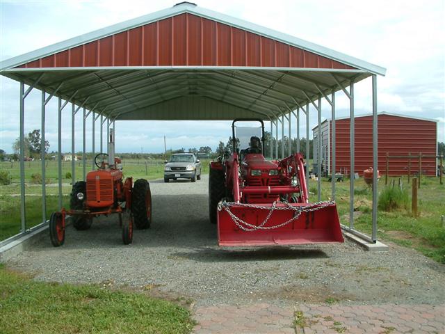

Looks OK to me. I'll add sides to the upper 6ft later.
Cost: $3600 for the carport, $600 concrete, $450 building permit.

For this size carport, the local building dept requires wet signed engineered drawings and concrete footings or a slab. The minimum footing size is 12" W x 12" deep (into native, undisturbed soil). The structure has to be designed for 85 mph winds, exposure C. One of the reasons the building permit is so expensive is that the plans have to be checked by a CA-licensed engineer. The local building dept laid off its engineers a few years ago so this work has to be outsourced (two week turnaround time for plans checking).
Because of the slope in the driveway (in both directions), I ended up with footings that were about 15" deep at the high point on the footings and 23" deep on the low point. You can see the driveway slope in the photos by noting how much of the footings are above grade level. The top of the footings are dead level--a requirement so the rain drains off sides of the roof instead of the ends. I opted for what's called "vertical" roofing which you can see in the photo showing the crew installing the roof panels. These panels are only about 11 ft long and there are a lot of them. You need to add purlins for this type of roof. Normal, cheaper carports have "horizontal" roofs which drain off the ends. The footing for this type of roof have to be sloped (1/4" per foot, IIRC).
