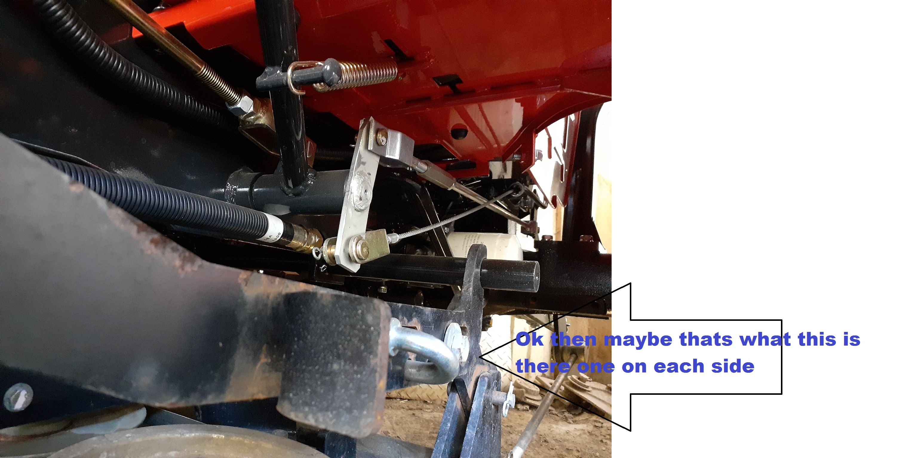

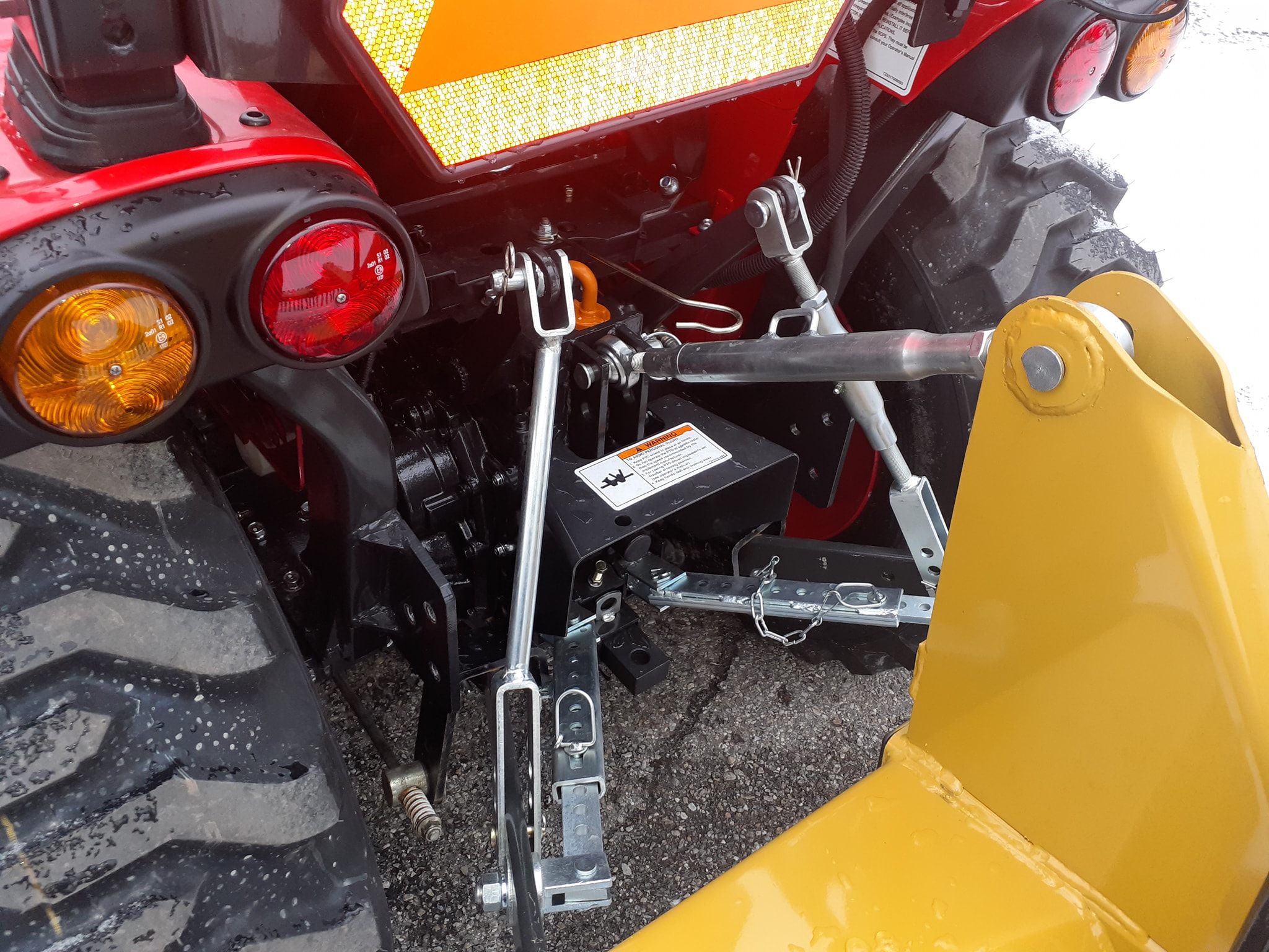

My new 2610H got delivered last week and I only got a little time to look at things over and with the weather being in the single and teens its made it tuff since it just fits into my storage shed. I went out yesterday to remove my mid-mount mower so I can get things ready to use it for snow removal but I can not get the MMM to drop down with the 3 pt hitch lever am I missing something is there a lockout for the underarms I didn't see one all I see is the flow control knob for the speed of the 3 pt. If anybody has any insight it would be greatly appreciated.

/ New Branson 2610H owner #8
Are you trying to do this with an implement still on the 3 pt?
I was checking some of the pictures you posted on FB. And noticed the lift for the MMM consists on a rod coming back to the 3pt and 90 degree plate that sits on top of the lift arm.
If there is an implement on the 3 pt, the 3 pt arm won't go down enough and the MMM might no drop fully to the ground.

There no Implement on the 3 pt. The MMM doesn't seem to move at all I even tried to bring the 3pt all the ways up and then lowering it and nothing. I don't know of any photos that I have on Facebook that show the MMM arms or linkages. What photo shows this I for some reason can not get photos to upload onto the forum. I'm going to go out now and see if I can see what you speaking of and I will take some photos of the underside of the tractor and I'll see if I can get photos of the back without having to start it and move it. To start it I would have to plug the block heater in I would think since its 8% here with the wind chill

Ok I went out and I see what you're talking about way down at the bottom of the lift arms they go around the arm and the arms ride on them they are losing I can move them and they're a lot of slaking in the rodes going through them to the mower. I wish I know why my photos won't upload I just took photos of it all

/ New Branson 2610H owner #13
This is the picture I was talking about.
But after your last post, it might be just a lock or height adjustment being overlooked.

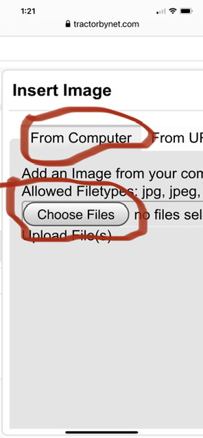

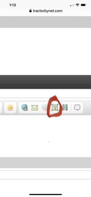

To upload pictures click on the picture frame icon.
Then click on From Computer tab and click Choose File button.

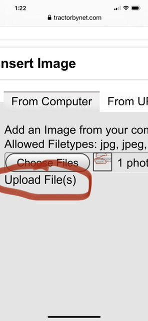

Select your picture from where you have it saved and hit add button. Then you should see the thumbnail and then choose upload. This might take a moment so be patient.

I went out and there are u plats that go over the lift arms and the same shaft for the arms go through them. I have to say these are what lift the mower and there got to be a lock somewhere to keep the mower up going by the slake in the rods going from those arm under to the mower linkage

I think you are correct I went back out and looked under the tractor at all the linages and took pictures and on both sides, there are what looks like U-tab but I can't get under there enough to see everything they are going through to see if something they go through is solid and I didn't want to pull them with the 3pt in totally down. I believe this u-tab is going though both of those arms so it cant lower

While I was on here and in the Branson owners FB group asking about this I did send my Dealer JC Tractors and Restoration a message and spit it being Sunday and being closed he did just get back to me and stated "" There is a pin that locks the mower in transport, up position. This needs to be released"" I also want to put a big thank you out to my dealer for tsking the time on a Sunday to get back to me and verifies I need to pull that pin so the deck can move

Here some photos of my 2610H
