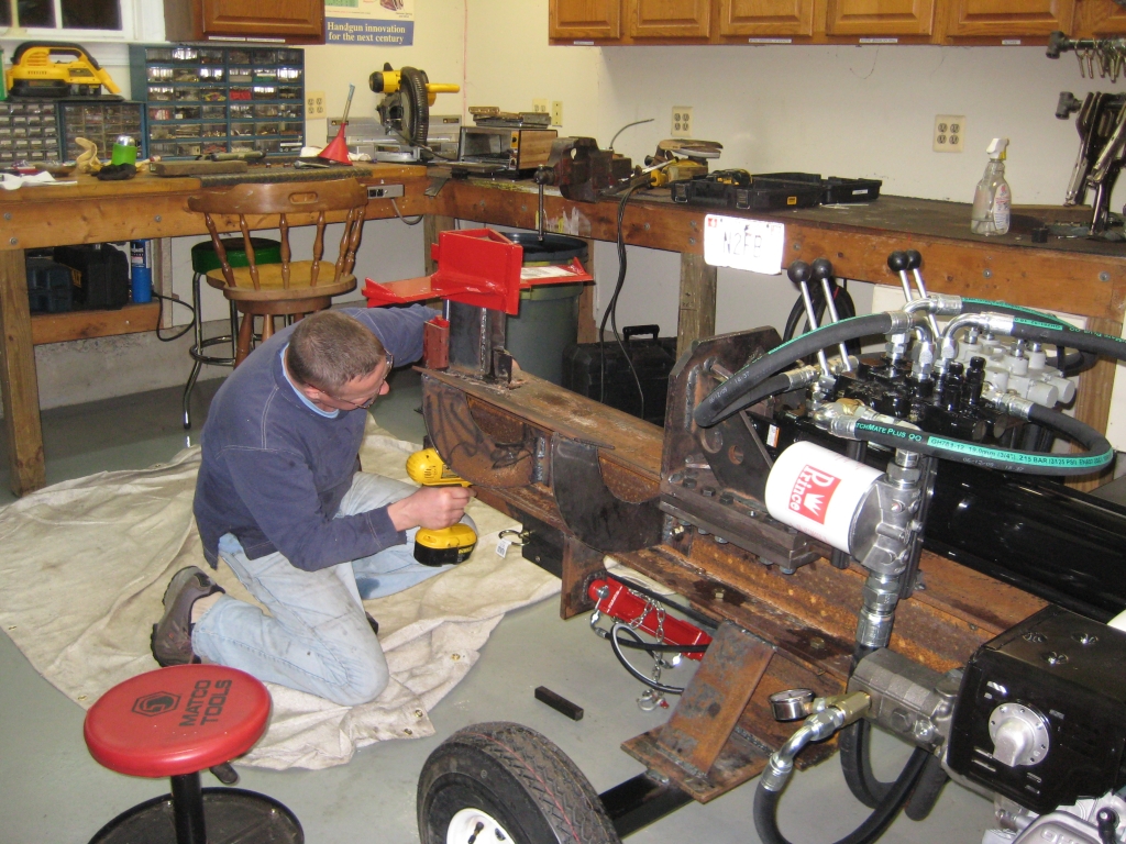

That is a good question! The two levers on the left go to the log lift cylinder and the wedge lift cylinder. The right side valve is an auto cycle valve. If you pull both levers once, they stay pulled and the wedge will go all the way forward and back with your hands off the levers. If you want to run it like most splitters, you pull the right side one and then push it back to retract the cylinder. I thought a lot about that valve, it is more complicated, more hoses, but after looking at some of the better splitters like the Rayco and timberwolf I decided it was the way to go.
Wayne
/ new BALLS
#32
Here is the manual for that valve. On page three or four is shows the plumbing and how the thing is supposed to work. I need to snug all the connections and loctite the NPT fittings, but may not get that to this weekend.
Wayne

With regard to the hoses, I work during harvest season on a large grain farm. The farmer I work for got tired of the inconvenience and cost of having hoses made, so he purchased a used hydraulic hose crimper and bought bulk hose and fittings.
/ new BALLS
#34
I did a lot of research on the auto cycler valve. When you think about it, on a vertical splitter you DO NOT want an auto cycler valve. Where do you put your hand to hold the wood? Same place the wedge hits... On a horizontal machine, your hand is on the bark of the log, not where the wedge impacts, so as it turns out most of the wedge to hand/finger chops happen on vertical splitters.
I am so glad I went to the hydraulic shop for the hoses. We used five different hoses, and tons of fittings, elbows and stuff they had in stock. It was fun to work with somebody who could look at it, know what fitting to use, get it from the right bin, and have stuff work. Doing this online would have taken at least three or four orders, and I would not have been able to use any of the crimped on 90 degree JIC's since you can't twist the two wire hose to compensate for the orientation of the 90 degree connectors.

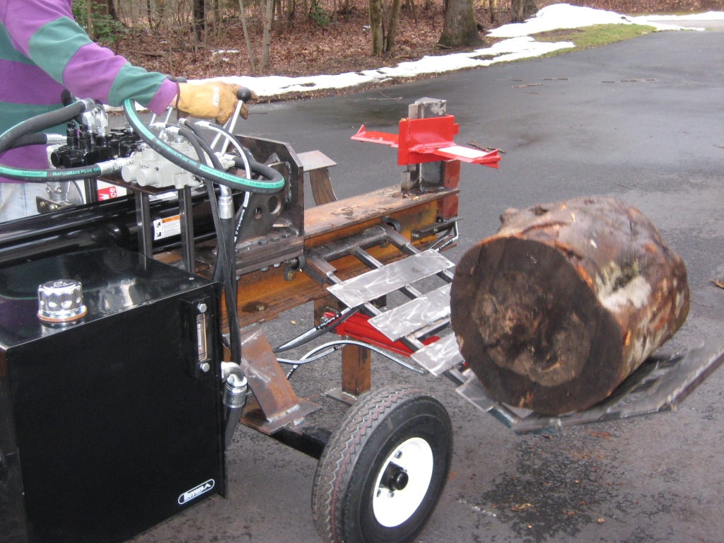

OK, we're all plumbed up. The Honda 13 HP engine started on the first pull. No kidding. The log lift works great. I learned that it is probably not the best idea to weld the four way wedge to a large nut that goes to the lift cylinder. As wood jams under it, it wants to lift the wedge, which after a few splits is exactly what it did, it tour the weld right apart. I was happy to see the weld penetrated both the nut and the plate and did not just pop off.
The first video shows the log lift. About half way into the second video what the four way wedge jump up and the wood go flying, that is when the weld broke. Apparently no problems, stilll works fine.
YouTube - MVI_4507.AVI
YouTube - MVI_4509.AVI
/ new BALLS #40
Looks great Wayne, I guess you need a ball or clevis type joint from the wedge to the cylinder to allow movement? At lead it did no bend the rod on the cylinder!
