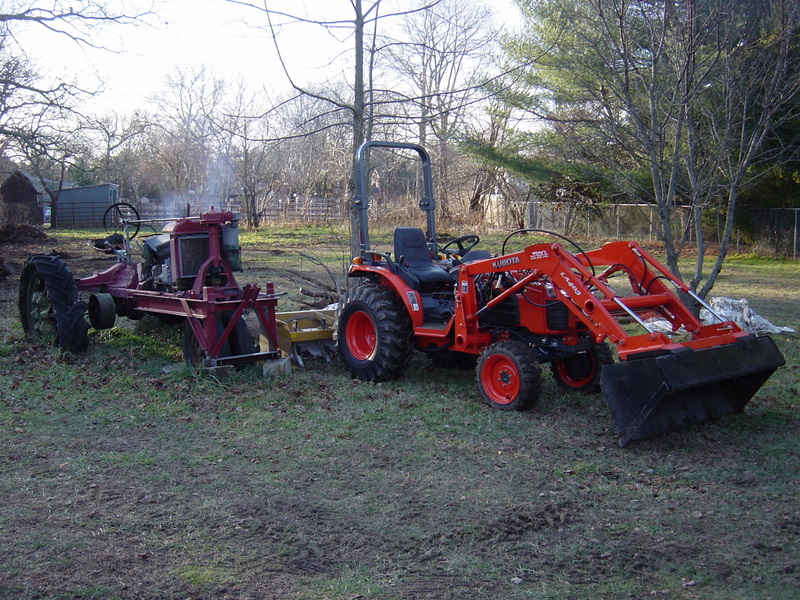

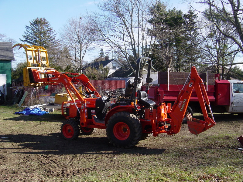

From bucket to grapple in 5 minutes or less with the ATI tach all. Although most skidsteer attachments are to heavy for the B2630/3030, I like the idea of the industry standard attachment. I can share attachments with my L3830 with common sense limits.
