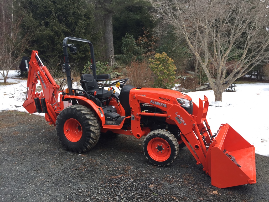

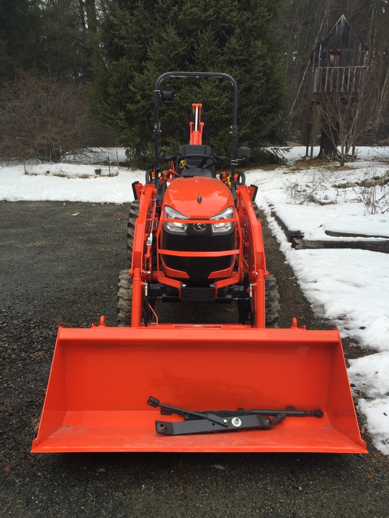

Looks great.

Nice looking tractor. Have fun with it.

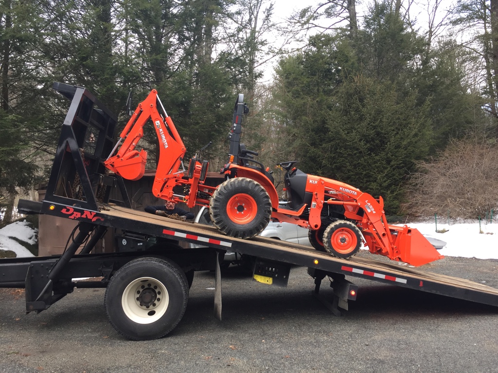

Gotta love new TOYS!!! :cool2:

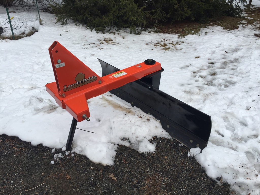

Tom, looks like you have a great new tool there! Nicely fitted out. Would you say that these B's are sort of equal to baby Grand L's in their features? I'd guess that a 72" blade will be fine for snow work, and as someone else already said, if it is too big for dirt work, just take lighter bites. Now you'll want some LED lighting? SSQA forks? Filled rears? Bucket tooth bar?

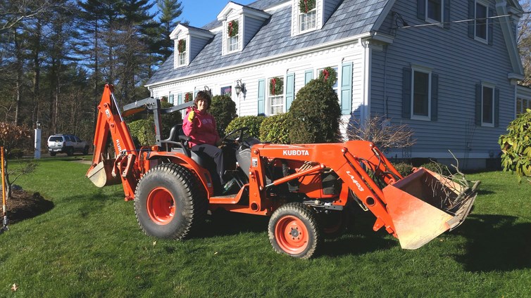

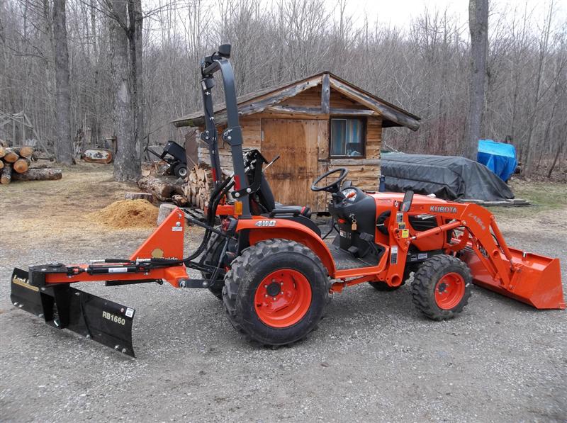

Verdemont.....nice machine!! Just in case you are interested, did you know you can get hydraulic angle for that blade? Mine is the 60 inch.

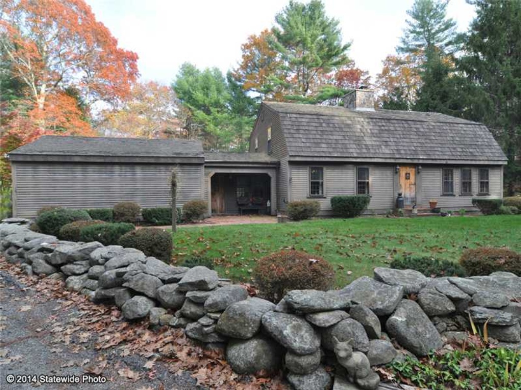

I relocated from Colorado to the east coast reluctantly. I divorced in 2012 and retired from my company of 25+ years (Hewlett Packard). I decided to move back to the east coast where I lived until 1992. I grew up on a farm in Maryland and selected New England as it was someplace I've visited a lot but never lived. And I have family all along the east coast. After two years in Massachusetts, I determined the commute, housing prices and taxes were too waaaaaaaay too high for me. Along the way I met a wonderful woman from Rhode Island and then found a great new job in Providence and then bought a house 25 miles away in the country just a few miles from the Connecticut border. My property is just a few acres and has a house built in 1971 as a replica of a Colonial home. Lots of work to do in the yard and woods over the next 5 years. And as many of us know, a tractor with a FEL is your best friend for just about any project around the house. Since this picture was taken we've already had the roof replaced and will now begin the next 5 years to make it our forever home. The tractor will come in handy as I turn 60 this July and I want it to do the heavy lifting.
