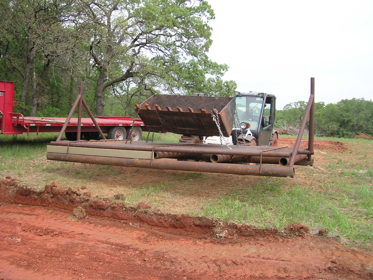

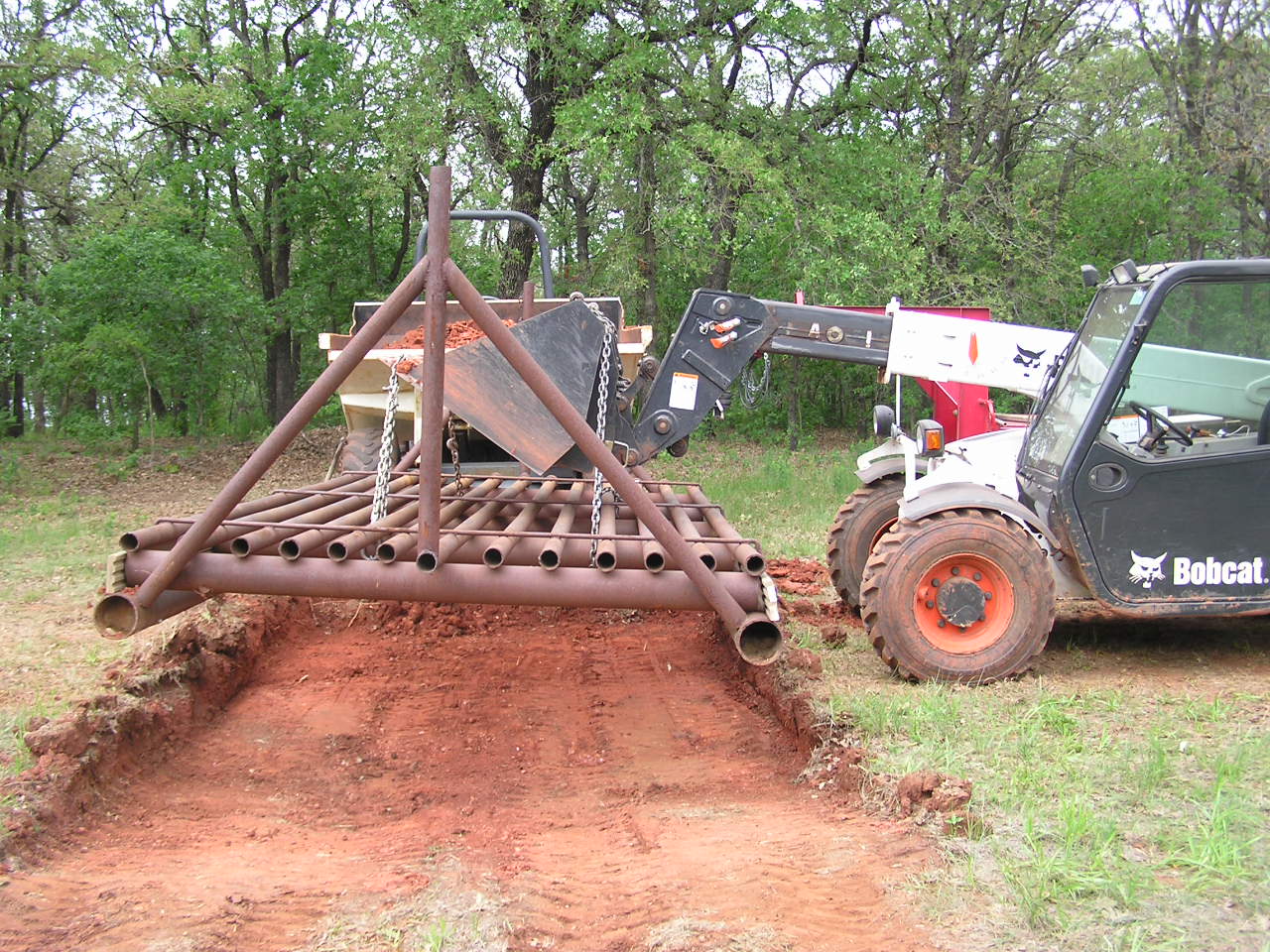

Here's how I moved an 11ft Pine Log Bench. (see pics). This one was much lighter than the full log I moved earlier. No pic on that. I have a Skid Steer type Bob-Tach quick disconnect bucket & loader and I need to be careful if I weld hooks on it. I also probably should have used a larger set of straps.View attachment 391584 View attachment 391583
