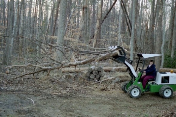

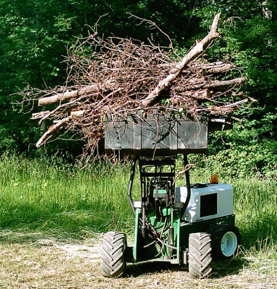

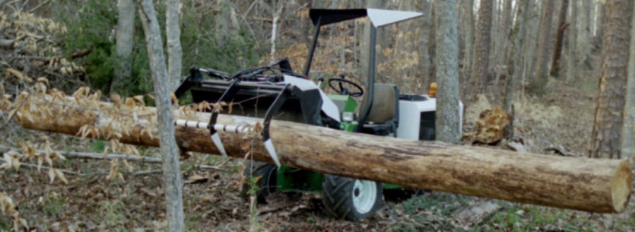

3238dpw said:
For those of you who haven't seen them yet.
New- Fall 07
Thanks for the post. I hadn't seen these.
BUT, after using my Grapple Bucket for about 250 hours and my MiniHoe for about 50 hours, my impression is that both of these new products are for V-E-R-Y LIGHT DUTY use. I wonder how much that Thumb can lift way out there! Even when digging, the MiniHoe doesn't work very well when fully extended. Lots of stress at the mounting plate!
"Good for leveling out dirt & gravel"
Maybe, but most attachments can do that! (I often used a wood pallet with nice results!)
"4" teeth to pry out bushes, roots, rocks, etc."
Could be easily bent out of shape. How about side loading? Even the short stiff teeth on the Grapple Bucket or the strong Front Forks aren't much good for prying out of clay soil! Even the Potato Digger sometimes has trouble!
"Thin bottom makes it easy to slide under debris."
With the Grapple Bucket the preferred method is to compress the pile going forward, then bring the fangs over and down to further compress it, and then pinching together and lifting.
"Great for handling logs, brush, rocks, fence post, etc."
But not the 600-800#, and up to 20' long, logs that I carry out of my woods! Those 'logs' in their pictures are called 'branches' at our house!!
Only two fangs, not three! How wide? For suburban subdivision use only!! I realize that the Grapple Bucket at $1350 is 50% more money, but it is at least 200% better!! If you really need a Grapple, don't mess around, buy a Grapple Bucket!! (Remember, with every Grapple Bucket you get a 5 cu HD Bucket [$350], and a set of Rock Teeth [$125], for free!!)
