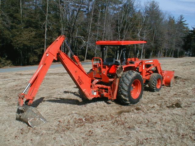

Hi John - thought I'd toss in the picture of my L5450 again - I've been sorta waiting for more people here to "discover" the bigger L-series models. Kubota has ventured into this power range in the L models before. My rig is a five-cylinder with a 15 gpm front pump, 60 gross hp, 11-foot hoe, and easy-detach 1150 loader. Lots of grunt.
And on the subject of pto speed, I added a 2-speed pto ( link here ) so my engine can loaf at 1800 rpm while the finish mower hums along at 540.
Take care and have fun with that nifty 5030. /forums/images/graemlins/laugh.gif

What a nice rig. Really like that Bradco Hoe, puts my little BH90 to shame.
Wonders to himself....."i wonder if that hoe will fit on my 5030"?
   / New 5030 #28
The Bradco's subframe is very tightly integrated to the 5450's loader and rear axles, so this one wouldn't fit the 5030 - but they must have one that does.
Wonders to himself......."i wonder if my wife would notice if i traded the 5450 in on a new 5030 HST?"
