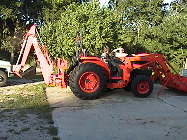

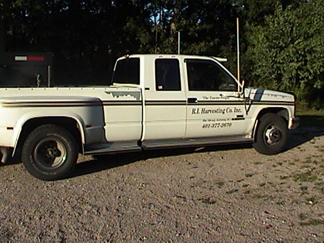

A plug for the dealer. This is the rig he used for delivery. The nice thing about the Kubota is it's light enough to be towed with a HD pickup.
Whenever i wanted to move my Case i had to hire out a much larger rig ( 9 tons (ish) ).

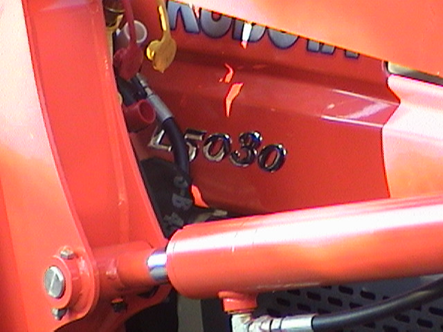

another

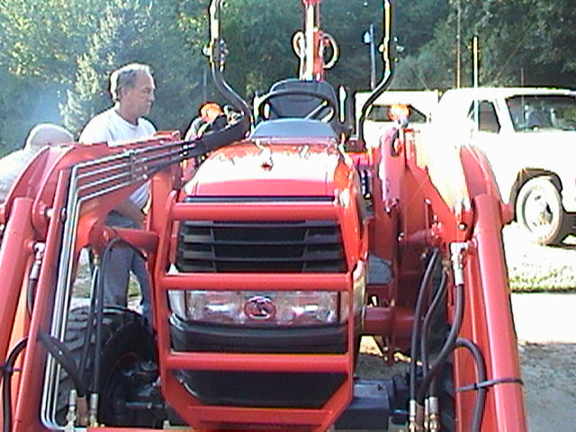

and another

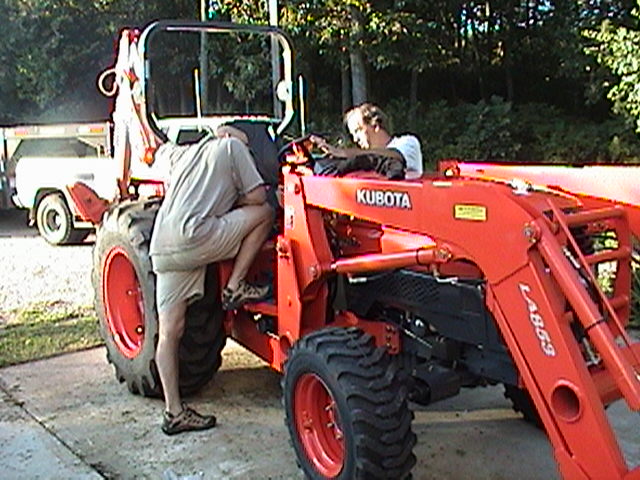

yet another

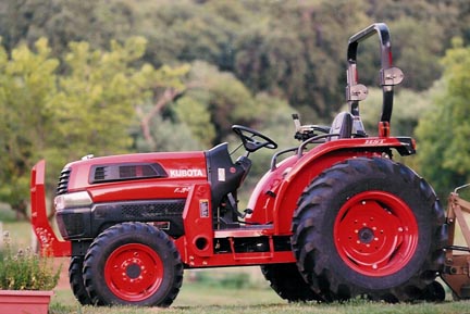

I still don't run my L3830 at PTO speed when mowing. For one, I just can't tell the difference in the cut. I run mine at about 2300 RPM sometimes less. Your 5030 is the same engine as what I had in my L48 and it had all its torque at about 1700 RPM. The L3830 is also the same engine just one less cylinder. I would try operating it at a lower RPM and decide if the cut is satisfactory for you. My RFM is a 84" Landpride. I enjoy my L3830 HST tremendously. I now have almost 100 hours on it and have had it since May 2003.
