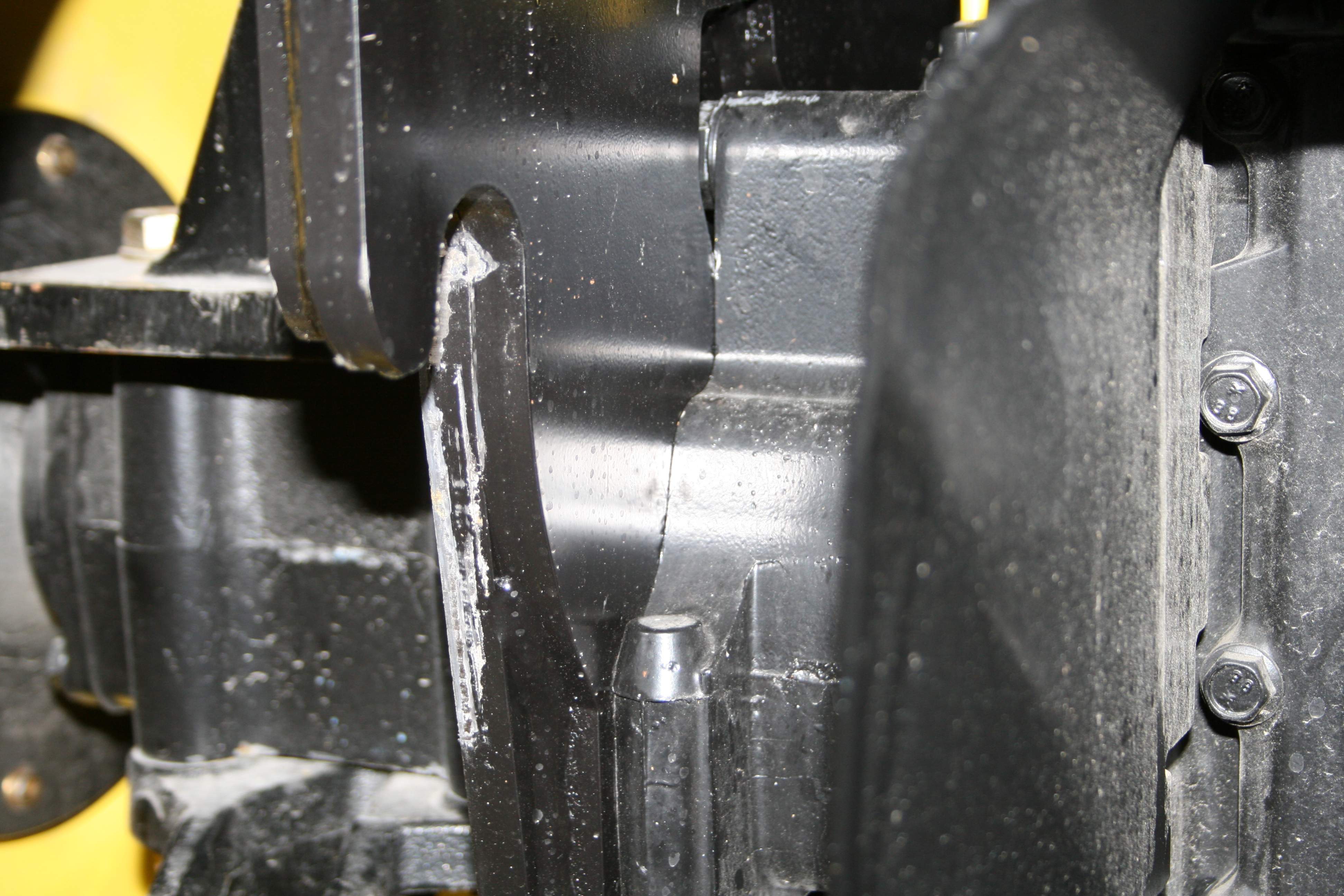

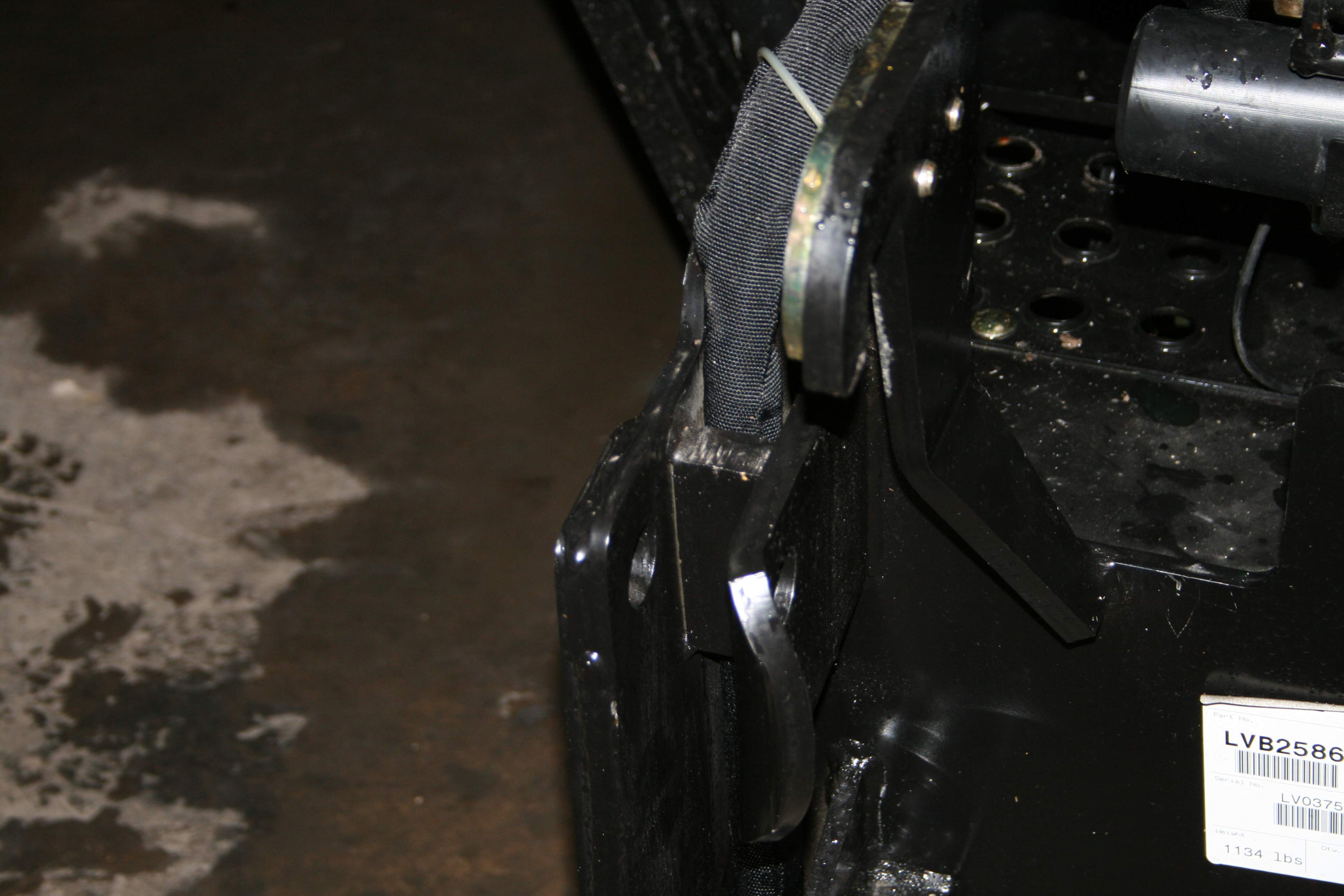

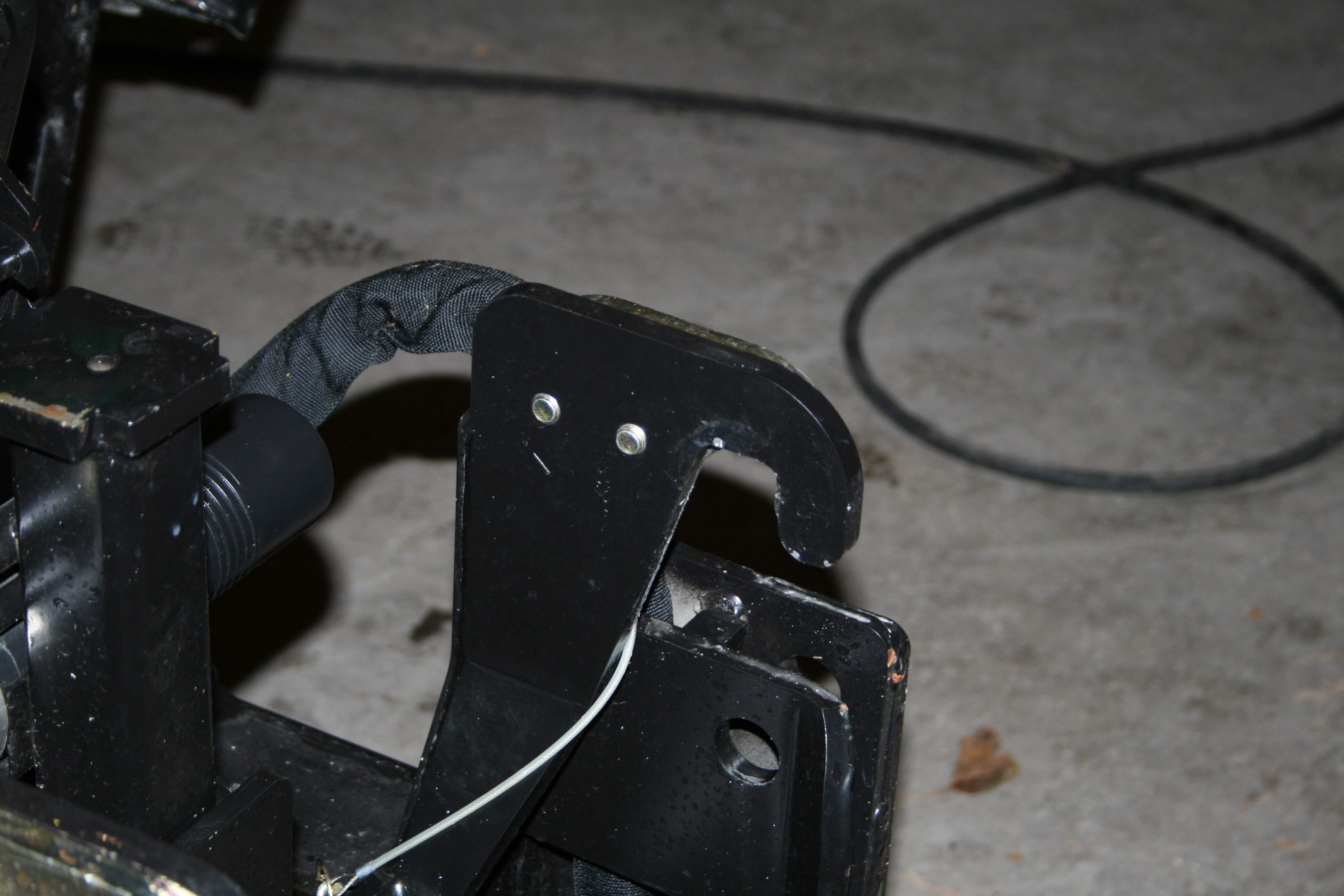

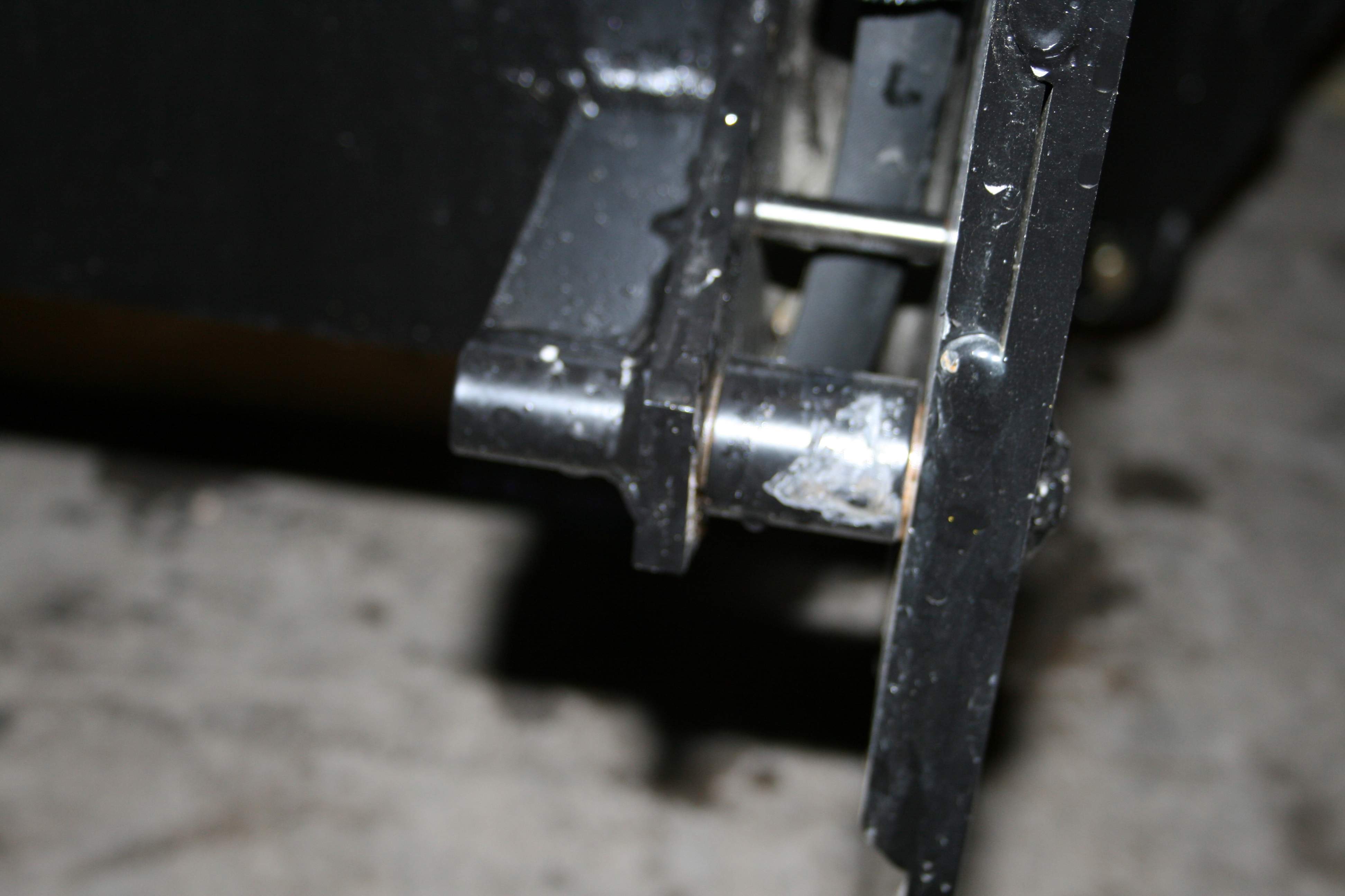

If you go to the beginning of this thread you will see pics of how my new hoe mounts. What you see on hoe are the hooks where it hooks to frame of tractor. I'm not sure it is a "subframe" of old in that the only add on to tractor frame are some steel plates (from the limited time I've spent looking) that hook downward so that as the hoe is drawn up it simultaneously sandwiches in the steel sides of the platform then draws two pins on the hoe's frame itself up into the downward pointing hooks on the tractor frame - then the holes at top of hoe frame and bolt on frame on tractor line up so you can insert two big pins at top - it is then secured at 4 points direct to tractor. I think I remember seeing hoes of yesteryear that have "subframe" that nearly runs up under the front axle of tractor. I don't see any evidence of that. I've only spent an hour or two with new ride.... I know, pathetic, I've been wicked busy. I'll post some pics here....

here are some pics - will explain them in next post
first pic- where your rockshaft hooks to lift hoe
second pic - where pins go in hoe can see the "sandwich" part where plate of metal goes in big groove - built real heavy.
third pic -bottom pin or whatever, permanently on hoe to fit in hook on tractor as hoe is lifted up
fourth pic - hook on plate bolted to tractor frame.

Not that different from mine where the 3pt lifts the hoe and it's pinned to the side plates, not like the older units that stayed attached to the lift arms, mine was sold without any extra undercarriage, don't even know if it was an option at the time (2004) now they recommend/require the extra pcs for my 48.
I guess some machines came in with serious damage like splitting in half in some cases, they say don't lift the rear wheels off the ground with the stabilizers like some including myself tend to do.
