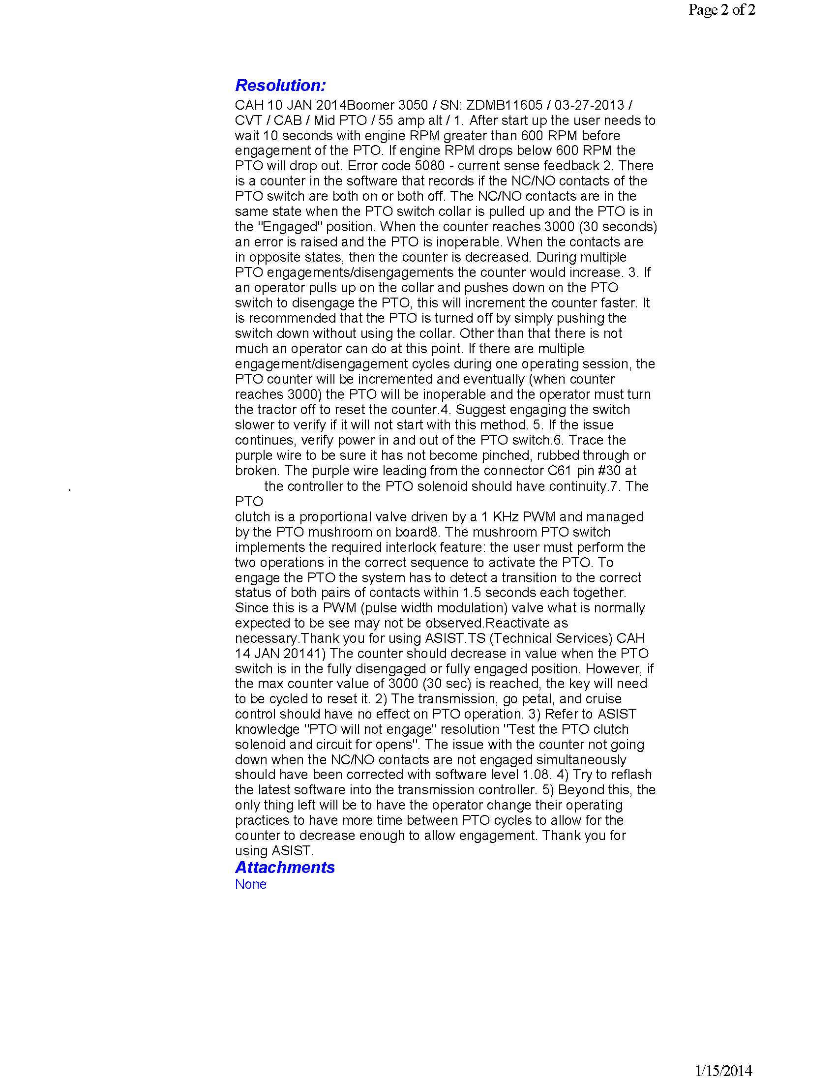

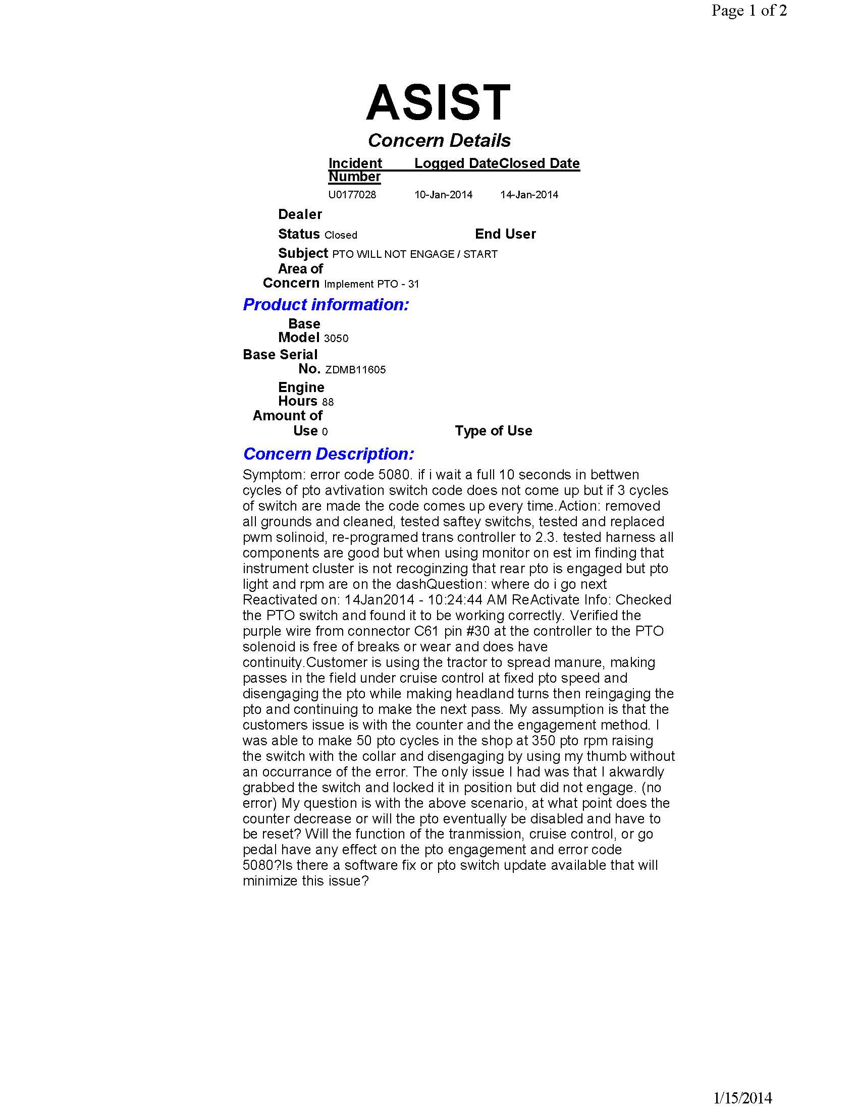

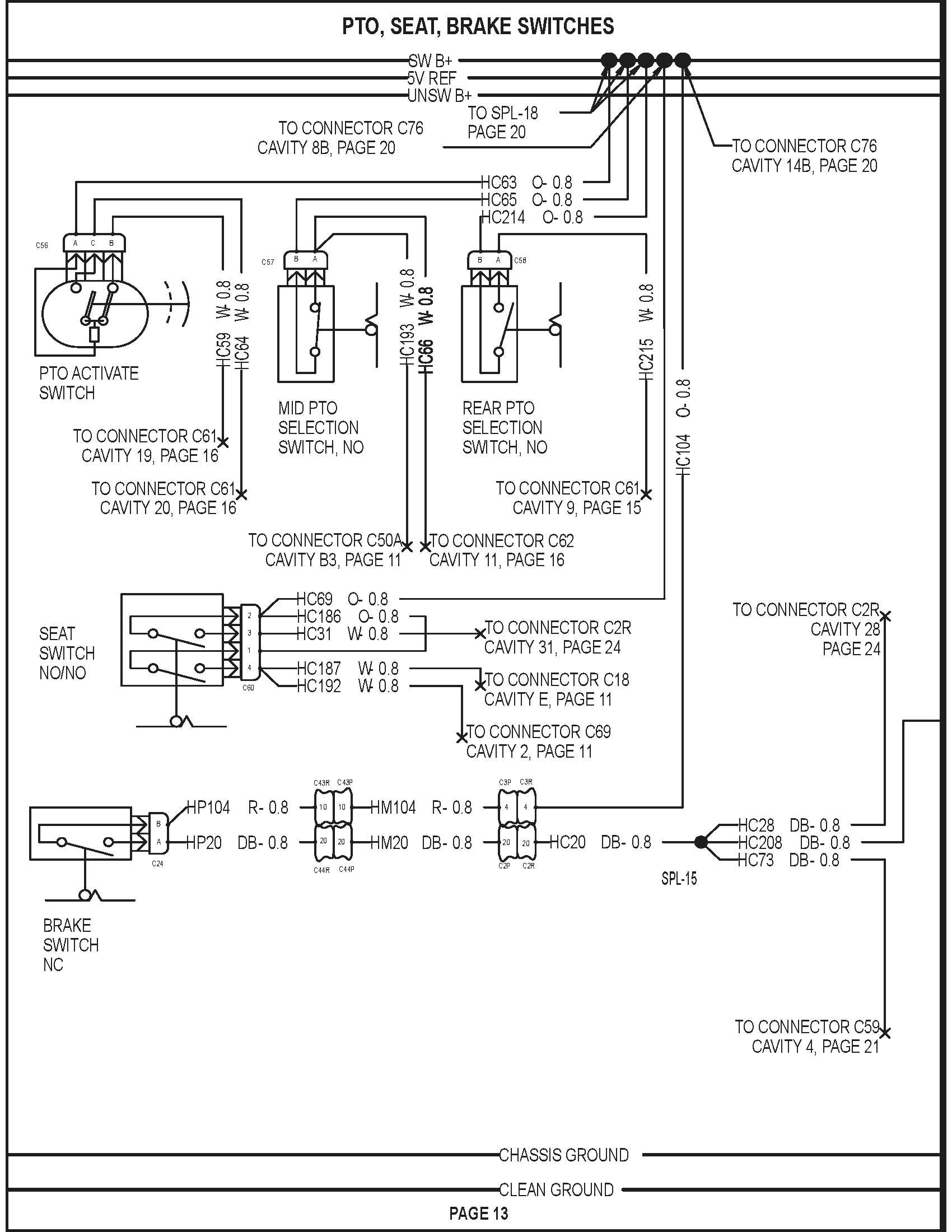

PTO wouldn't even turn on just before major snow storm Saturday, so I used a DPDT (on/on) switch that I had (spare for snow plow) cut off the plug off one of the other bad pto switches I had and attached it to the toggle . It works most of the time with no problems other times if the pto doesn't turn on I cycle the switch quickly it will turn the PTO on and amazingly since I put the toggle switch in no 5080 codes yet just the same intermittent problem where it won't turn on sometimes (cpu issue I think) which I can get around by quickly cycling the switch.

Utopia
Well, At least that is a improvement and will get you by for the time being but a customer should not have to go through so much on a new unit. Hope you eventually get things fixed by NH. I wonder if the OEM switches you have installed are not built to spec., throwing off the voltage and causing the computer to flag a problem?
/ New 3050 CVT Update
#49
I agree I also think there is a problem with the OEM switches, but I think there must be a problem with the cpu, software or both because sometimes it still won't turn on unless I cycle the switch quickly a few times. But what really amazes me even cycling it there is no 5080 code/lockup and that's what the ASIST's said would happen if I moved the switch to fast/soon. I didn't have one code 5080 lockup all day yesterday and I had to cycle the switch a few times. Hopefully they will get to the bottom of all the problems when it goes back or maybe I'll get real lucky and the field rep will fix it when/if he he comes here to see it. I hope to hear some decisions sometime this week of when and what is going to be done.

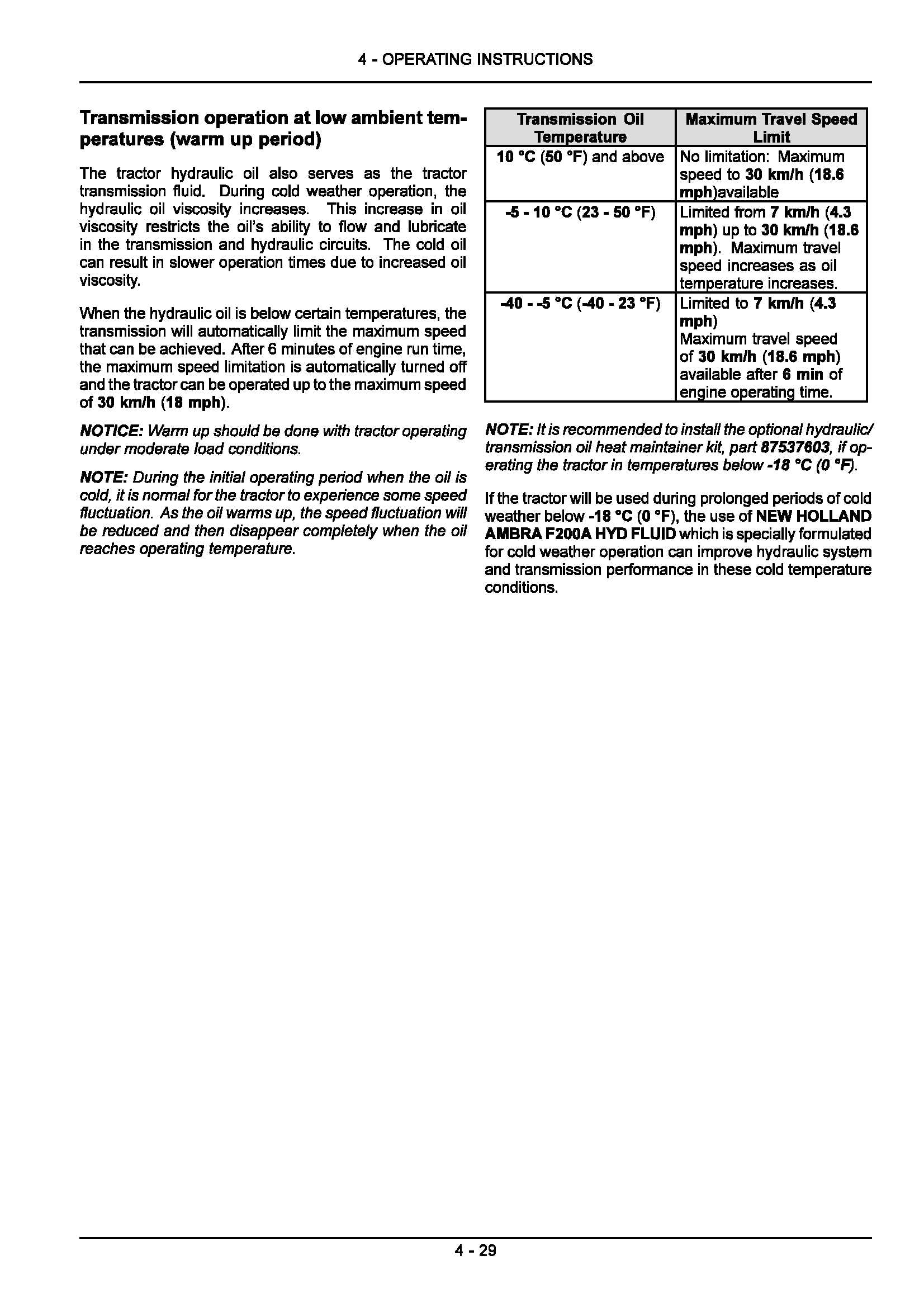

While you have the transmission drained you might want to add the transmission heater it goes in the lowest point of transmission. I have one ordered $85 from my dealer so next time I change the trans oil I can install it. That way on those real cold days I can use it to rid myself of the "snow flake":) restrictions. Local power company is going to love me block heater and trans heater.:laughing:

My Boomer 8N with the first generation three range CVT has the same low ambient temp warm up period. In East Texas it's not a big issue. I have not had any issues with the transmission or PTO. The only time I use high range is for the preset cruise control which I have set at 3 MPH. One thing I did learn early on is to always run the hand throttle up to 1500-2000 RPMs. It makes for much better foot pedal throttle response with less jerky motion.
