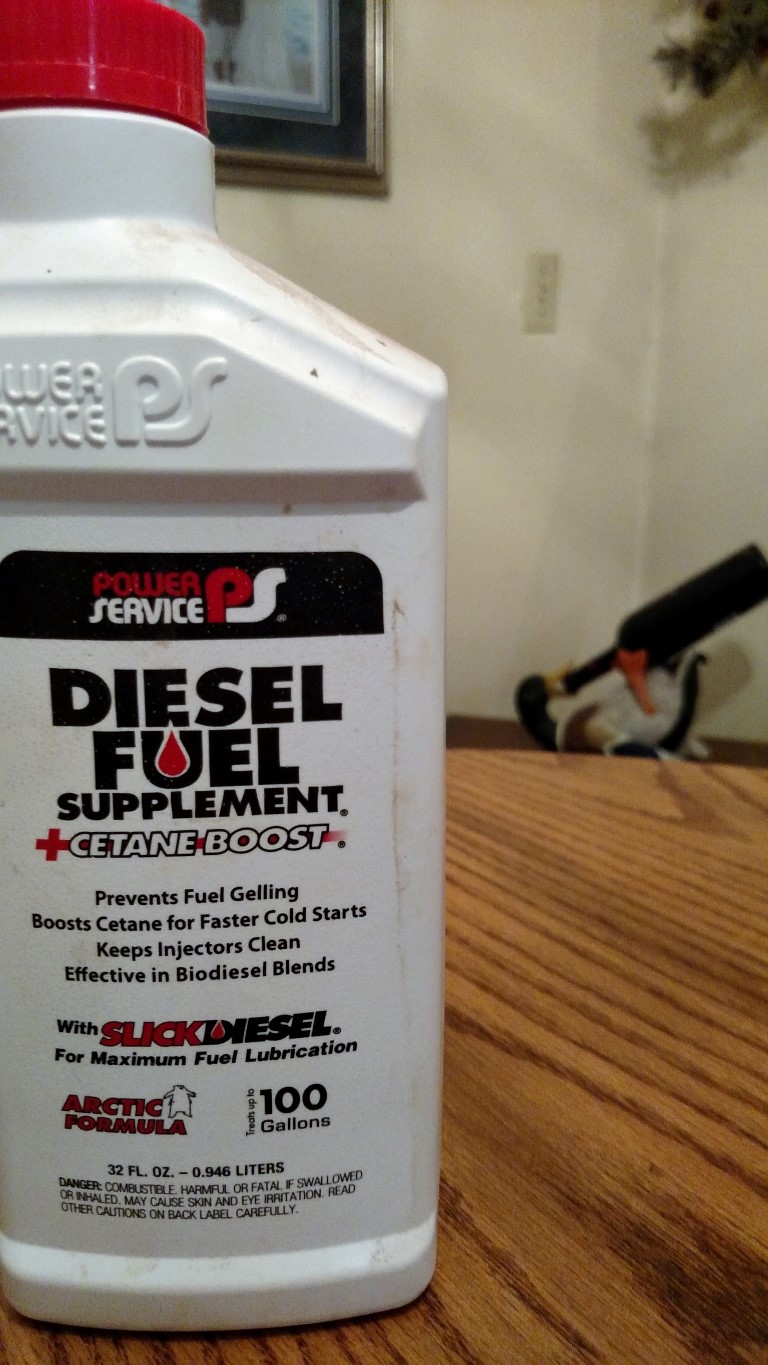

Airbiscuit, I drained all old fuel as directed. I just had to purge the system of what was already in the pump and injectors. Any suggestions on injector cleaners or fuel treatments that actually work?
/ New^2 Holland Owner...Almost #12
Here is what I use. You also see it in all the truck stops. Power Service Diesel Fuel Supplement (Medium).jpg
#13
Here is what I use. You also see it in all the truck stops. View attachment 457404
Thanks!
