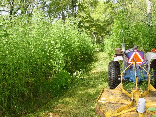

It is easy to overheat a 1700 while brush hogging, especially if the brush hog is too wide or the stuff your cutting is too tall. Overflowing antifreeze is a sign of overheating. The gauge should run at mid point. 5' brush hog seems to be max size. The wobble in the water pump pulley is a sign that you need to replace the water pump. They are not servicable. On ebay they have a new pump for around $95. If you wait too long the shaft will seperate and flail into the radiator. You don't want that to happen. 1700's were made in 79 and 80.
Check the screen in front of the radiator for grass and dirt blockage. Air cleaner is an oil filed and servicable unit. Take it off, pour out the old oil and clean it with diesel fuel. Refill to line at bottom of the canister with clean engine oil and put it back on..

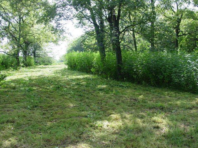

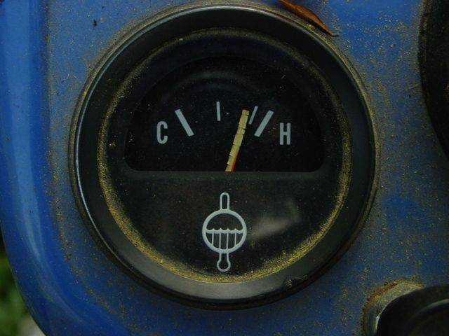

The key is to measure the temp and not just the dial as they all don't display the same and even if they did it does not mean the same temp. Get yourself a non-contact infra red thermometer and actually measure temp of t-stat housing, hoses and block. Refer to thread below and you'll find more info that you'd probably like to read.
JC,
http://www.tractorbynet.com/forums/...179639-how-much-temp-too-much.html?highlight=
Below is where the temp needle on my 1700 in the heat of summer, brush hogging brush as tall as 8 feet and covering an area of 3/4 acres.

As to what you wrote, I will have to get my gauge fixed *(REPLACED). It is exactly like the one in the photo so I'm going to go ahead and replace it with one that actually has the temps marked on it. As I understand, the temp should stay around 230 to 250. My other gauge RPM/batt and stuff works and I now suspect that my alternator doesnt' work or is faulty. I hadn't noticed a weak battery because of how dad-gum well this lil' 1700 starts up but it is definately missing a charging while using it (which may be why they unhooked the lights). The horn still works and I intend to make everything work and look more like it did when it rolled off the assembly line. SAY....I was in the TSC (tractor supply co.) today and came across some Diesel 9-1-1. Would this and other such products be OK to use when winter comes on. I was afraid to buy it or use it cuz it says that it does not harm 2007 + model tractors......which to me meant that it could harm my OLDER tractor.

Now, let me ask you a question, what would happen if you had access to your temp gauge front glass, let's say it was removable and then you went and bent the needle toward the left or rotated it just 10 degrees? would you think your engine temp would be any different? all I'm trying to say is that there was no need for me to change my gauge because my t-stat housing never went above 210, well within operating temp of my diesel. Actually that is about optimum. Now if the needle stayed right in the middle and I measured the temp and it was over 215 then I would worry about as the gauge appeared defective or out of calibration. There is sensitivity factor with a thermocouple such as no two thermistor show exact and identical out put when they are exposed to set temp. That hold true for the gauge that is supposed to show the temp. there is a slight variation of calibration in all analog input and or outputs. if the input or out put is digital then it is zero or one same as on or off and there is no in between. Don't change your gauge , only figure out what temp you read based on needle position and analyze it from there.

Anyway, your mention of the gauge reading in the middle and (not really reading at all) is EXACTLY what mine is doing. I started my 1700 just GREAT this morning (after the flat, the flooded and then dead battery from trying to start it yesterday on a severe angle from the flat tire). Used it a bit and quite because a little "burping" was going on due to the wet grass, up-hill grade and the overly fast speed that I was pushing the tractor. Anyway, if I'm to replace the faulty gauge, I believe I'd prefer to have one that read the actual temp. Who knows, I may even get lucky and it read EXACTLY what the engine is. I've seen a thread on that very thing so I'll try and look at that again.
