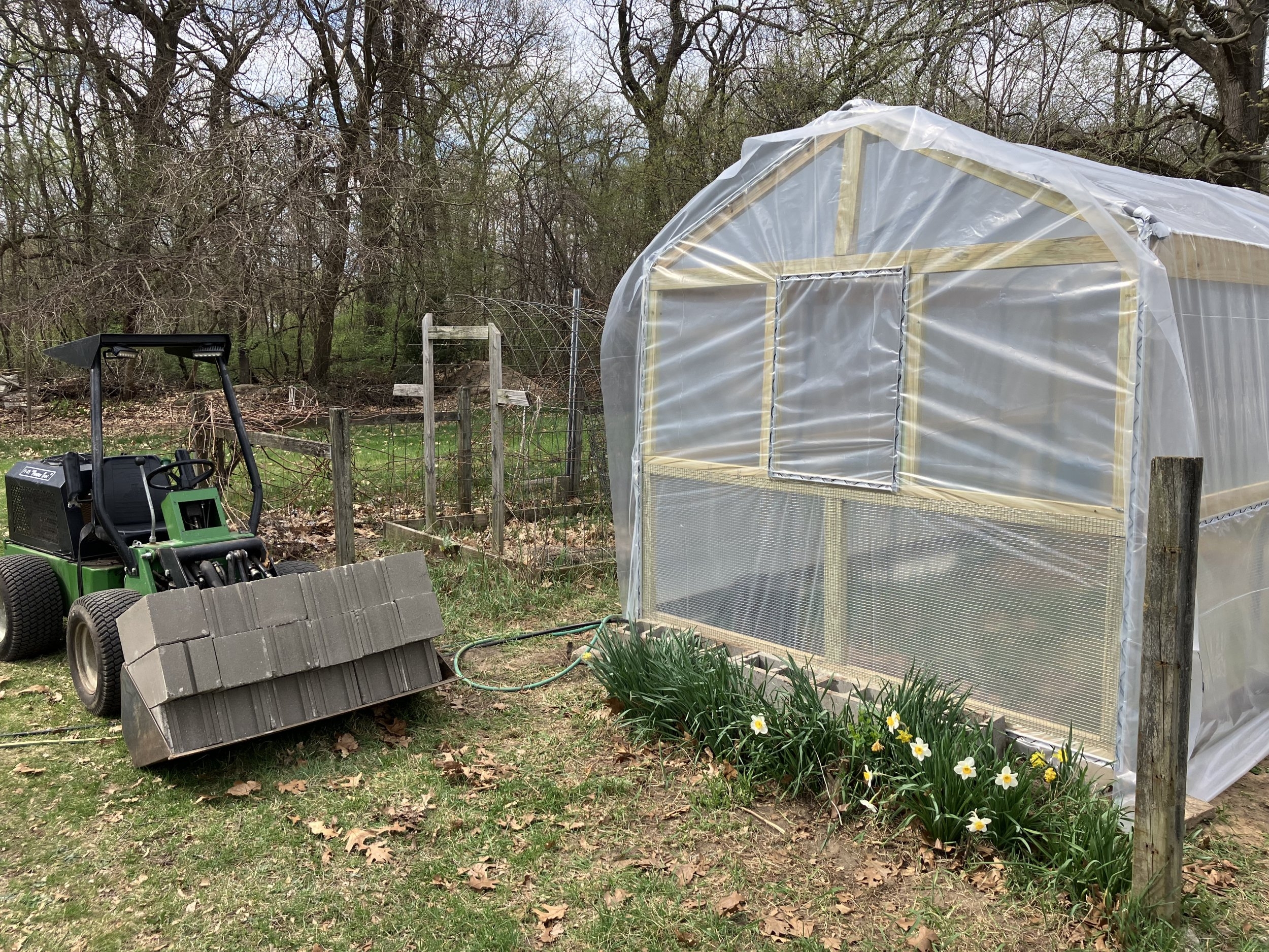

Neighbor had a very old shelter logic structure for his car. The cover finally wore out and he said it was cheaper to buy a whole new one than replace the cover, which he did. He offered me the frame of the old one. So I shortened it up lengthwise so I could put the vertical poles closer together, built some solid ends, got some greenhouse hardware and repurposed it.
So if you're looking for what to do with a portable shelter once you have a permanent shed, consider a greenhouse. (y)
