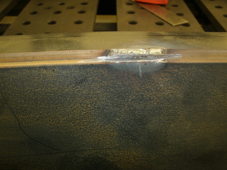

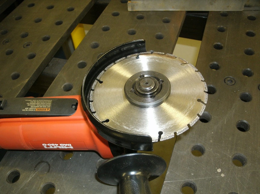

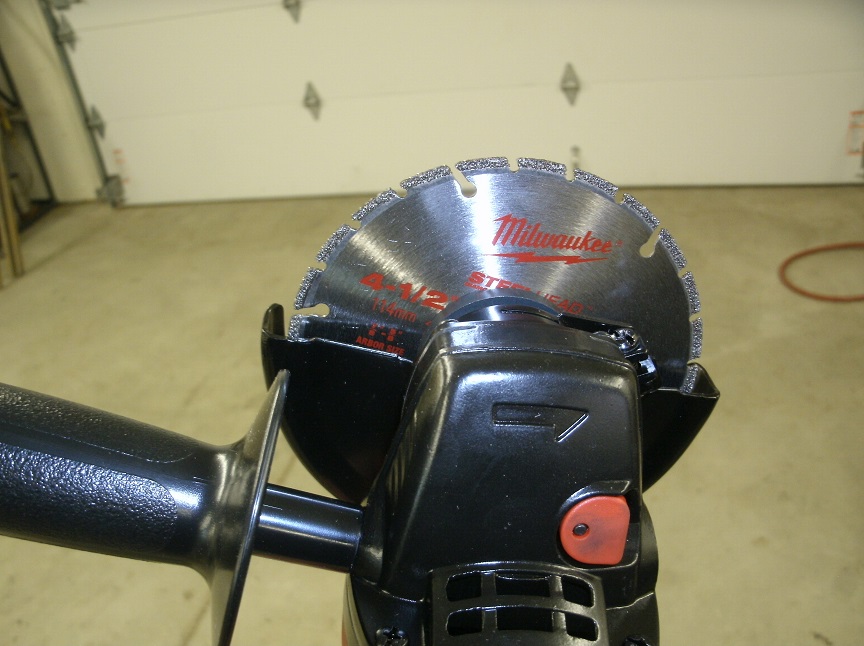

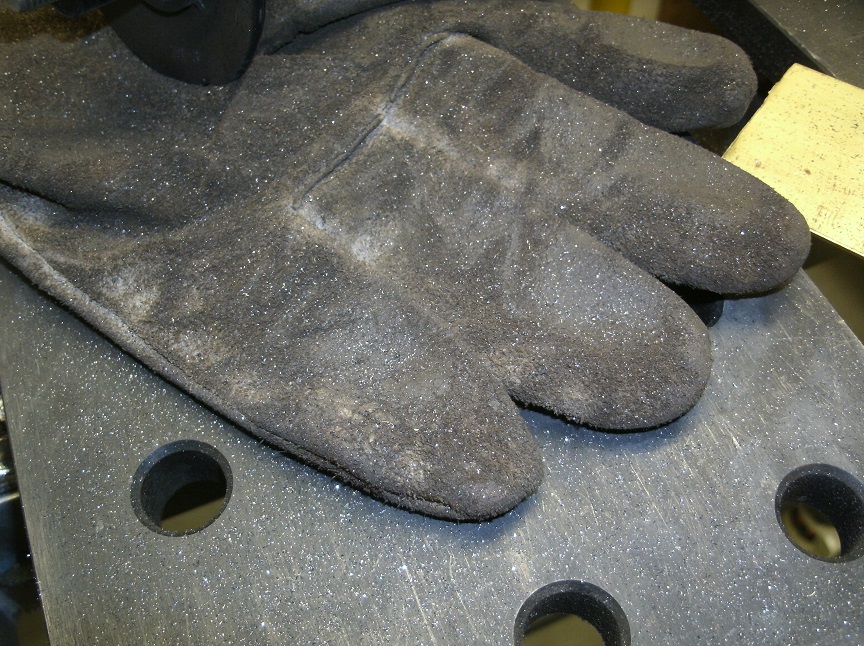

Thought I'd post a few pics for your reference. The pic where I cut through the weld took about 30 seconds and I was leaning on it really hard. Again I'm surprised at how smooth it cut with no catching. One thing I'd like to see different is a 'dished' wheel because sometimes you want to reach in a spot and the retainer nut ends up hitting. Also to note, instead of producing grit it produces small chunks of metal which could end up being a sliver factory. You've been warned! Keep in mind this wheel is brand new and only time will tell how it falls off.
