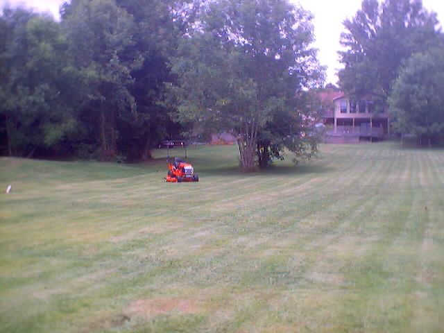

Re: Never thought I\'d be asking this, are the BX\'s...
Yeah, it cut grass pretty well /forums/images/graemlins/wink.gif /forums/images/graemlins/grin.gif
I'll try to be subjective but I'm sure my bias will show through so what the hey, at least it won't be smoke /forums/images/graemlins/grin.gif
I have the BX23 w/the 60" MMM and the cut is as good if not better than any of my previous riding lawn mowers and I'm still useing the std blades. I've read where some have modified gator blades to work on the BX MMM and have reported even better results.
The lower ground clearance is actually a benefit when mowing on inclines and the power steering & HST make it just about effortless to operate. It's hard to convince teh Mrs that it's work when I highly enjoy the seat time /forums/images/graemlins/grin.gif
I don't have the Kubota grass catcher so someone else will have to report on that.
I use a Cyclone Rake. Since I finish mow 2.5 acres, I don't vaccum when I mow per se as it would take way too many trips to dump the clippings. I mow to where I blow the clippings into several windrows and when I've finished mowing I hook up the CR then go back & pickup the windrows. This setup works well for me as I can knock out the mowing and pickup in less than 2 hrs. I also enjoy the resultant mulch the following spring.
The BX & MMM run so smooth that ear plugs are not needed.
The fuel economy is very good also. My former 23hp Kohler Vtwin w/48" cut would use nearly 3 gals to mow & bag the same 2.5 acres my 22hp BX23 uses about half that, and the BX23 weighs in at nearly 1k lbs more!
I mow with the FEL & BH dismounted as it not only makes manuvering around my many trees and other obstacles easier but also lightens the BX23 up by about 1K lbs which makes it more nimble on the grass. I have done some small patch type mowing with the FEL and BH on but not often. They are so easy to mount/dismount that I take them off to mow.
The fully floating MMM reduces gouging and gives an even cut on uneven land. It's also easier on the mower since it doesn't ride on ground contact wheels. The pic is of my former garden and pasture and it's still pretty rough but the cut makes it look much smoother than it really is.
Go give one a test and see how it feels.
Good luck
Volfandt
