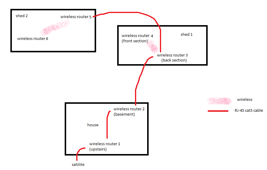

attach image is my setup...
the distance between house and shed 1 = to far apart for generic cheap wireless router
the distance between shed 1 and shed 2 = to far apart, (no real area on same common wall to place routers easily to have a wireless connection between them)
the distance between house and shed 2 = to far apart.
do to distances being to far apart, i ran RJ-45 cat5 cable (cheap generic network cable) between the 3 (house, shed 1, shed 2)
house, upstairs router, and down stairs router, house has alumin siding, a/c duct work pretty much chops house up, not to mention not able to get a good single from front of house (out on deck), to back deck. so 2 wireless routers in the house. cable is fairly cheap already have excess of it, so easier to run a cable between the routers. also a tad safer when consider "network security"
shed 1, router 4 is more for convince, have a printer that can connect to a network, but only by cable. ya i could possibly use a "wifi extender" but router cheap enough. and the router has a "bridge or wifi extend" like option in the settings of it. meaning i do not need to run a cable between router 3 and router 4. and if another router went out that i really needed, i could pull router 4, and swap it out for one of the others.
shed 2, eventually router 5 and router 6 will get a cable between them. but not in no real rush, to run cat5 cable up and around trusses to get to the other router.
the 6 routers spread things out to a point a cell phone, laptop, etc... can connect to the internet via satellite at the house. vs using the cell phone internet if you have cell phone internet. making emails, uploading pictures, videos with cell phone, or just browsing internet faster via the satellite connection. kinda nice being able to open up a laptop in the machine shop, looking up some part manuals, and have it all there were i need it. vs at some desk some place.
being able to hook up some some network cameras. almost demands Rj-45 cable connection between routers due to faster speeds vs trying to send data over wireless connection.

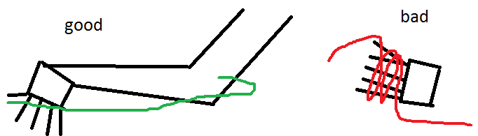

keep in mind rj-45 cat5 cable you do not want to fold it, always try and keep some bend in the wire. the individual 6 wires inside are a solid wire, and if ya bend/twist them to much, you may end up causing the wires inside the cable to break. ruining the cable. also keep in mind, try to reduce pulling hard on the wires, when snaking them through house or a pipe, the 6 wires in the cable can stretch some. ya really don't want the stretching it could reduce your overall speed of how fast data is sent/recieved through the cable. granted most cables can take a good amount of abuse during insulation. but the cables are not regular 110v or 220v electrical cables that are bigger diameter wire. so try and keep from going white nuckle on the wire as you pull it through the house or through a pipe if possible. and try and keep from wrapping the cable around your hand so you can get a better grip as ya pull on it.
pulling wire = GOOD = grab cable with and, angle wrist down some, and then loop cable around just above your elbow.
--other words, i am sure ya all seen some TV show, were folks are going down some steep wall or climbing. and they have a spotter (not sure technical name) that is holding the rope and they route the rope around their arms/back. vs wrapping it around there hands. this is basically same idea to pulling wire/cable. granted the small amount of wire i have had to pull, vs other experience is very small. but *shrugs*
--granted, when pulling wire and/or cable, ya end up using dish soap, or some sort of wire pulling stuff to slick everything down to make it easier to pull through say a pipe. and you will get messy this way... but... there is a difference.
--pulling this way also keeps "kinks" from happening if you tried to wrap the wire and/or coil around your hands.
--other words use your body, vs killing your hands and possibly the cable.

That's very close to how my setup started. Two Linksys wireless routers and a Linksys wireless access point. Now I'm using all access points with management. The funny part is that the price isn't much different.
   / Networking Woes #23
NetGear
This is a possibility. Get it set up and hook a small switch to the Ethernet port.
Daver1963, thanks for that. I've searched for 'Access Point' and couldn't find what I wanted. 'Range Extender w/Ethernet Port' sounds like a good chance.
   / Networking Woes #24
When looking at devices like this I'm not sure whether it is for a single device or not. I want to hook it to a switch or router and plug several Ethernet devices to it. Then address any of these devices from anywhere else on the network.
If it only appears as a single device, that won't work. And the product descriptions (blurbs) do not clear up this point for me.
Thanks for the suggestion. :)
