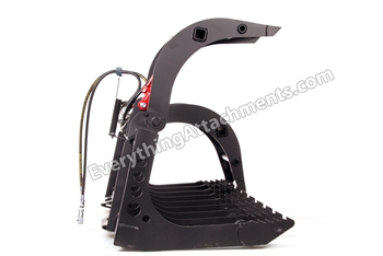

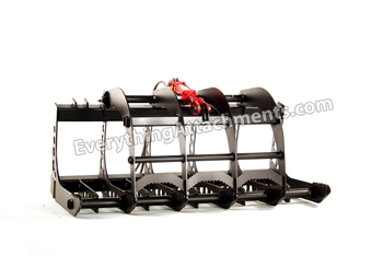

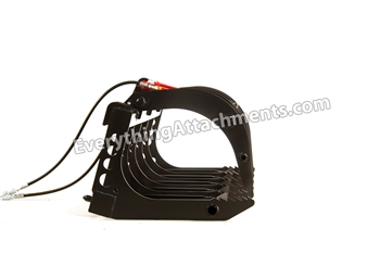

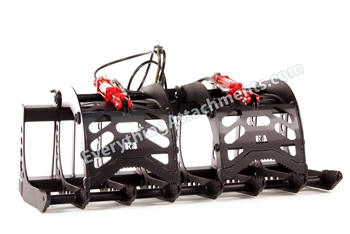

Have you looked at the best strength to weight ratio grapple? Everything Attachments Compact Utility Root Grapple 50"
And: Everything Attachments Wicked Root Grapple for Compact Tractors

It would be too heavy for your tractor. I would look at a EA wicked grapple like xfaxman linked.
Yes I agree on my L3400. I'm hoping to upgrade to an LS XR4046HC sometime this year and want the grapple for it, but I'd still worry about the weight for even that tractor.
