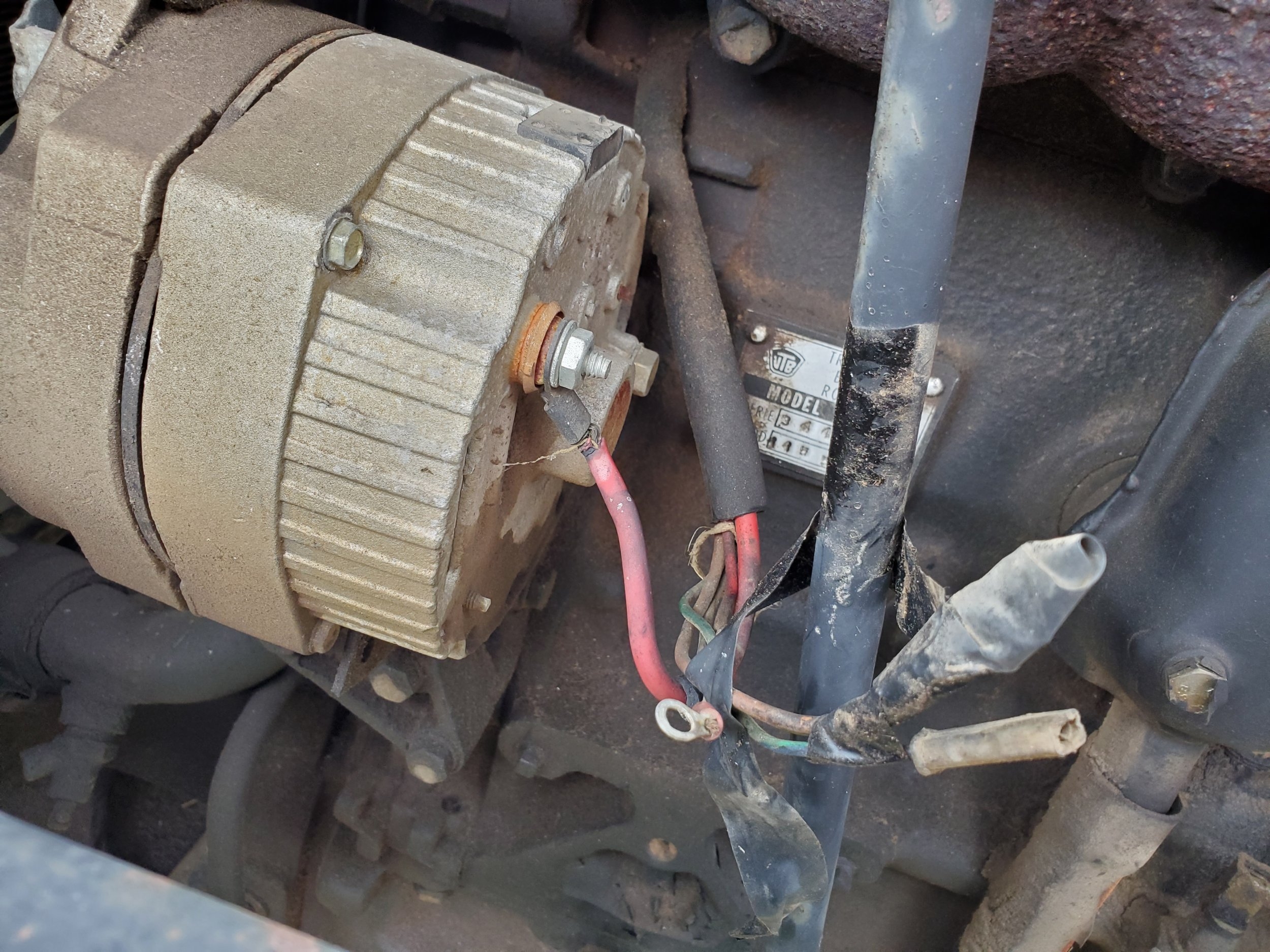

Hello,
I have a Long 2460DTC 4x4 tractor. My late father in law owned it before me. Sometime in its life the alternator was replaced with a standard old school chevy alternator from a late 80's Camaro or similar. It has a built in voltage regulator from what I can tell. The factory regulator is still on the firewall but I do not know if it still works. There are wires going to it.
The problem I have is that my fuel gauge is the only gauge working with any of the switch functions. The gauge lights and headlights work under the specific switch functions. I have checked the fuses under the hood and they all test good. I have the service manual for the 460 series but it does not have the same RPM/hourmeter as the 2460. The 460 was controlled by a drive gear for it.
None of the indicator lights on the right work either. I am thinking they don't have all the wires connected as the new alternator does not have terminals for them. I may have to buy an original alternator. Not sure at this point.
I have the 2460 parts manual but a few pages of the Instrumentation section are missing. If anyone has them to share, let me know.
If I can figure out how to get the gauges working, I am thinking about putting a blade style fuse block in place of the ceramic fuses.
Any insight to my issue would be greatly appreciated.

   / Needing some help with the electrical system. Long 2460DTC
Winterdeere,
I took some pics of the alternator today and noticed a plastic plug covering the internal VR of the chevy alternator. I would presume the factory VR is still being used. There are 3 wires not being used at the moment. You can see them in the pic. The charging system seems to be working correctly. Any ideas on how to get the tach/hourmeter and temp gauges to read correctly? The tach sets at 0 RPMs and the temp sets to the far left as if the engine is cold.
I do not have a wiring diagrahm for it so I can't determine what the wires go to or they monitor.

   / Needing some help with the electrical system. Long 2460DTC #7
The old voltage regulator should be totally disconnected. I suspect those extra wires were between old voltage regulator and alternator to control the field. This function is performed by the internal Chevy regulator.
The output of a modern excited-field alternator is controlled by the strength of the field. Regulate the field and you get 50-100 times more out of the alternator than you used on the field. These alternators do not have magnets, they use coils to create an excited field instead.
   / Needing some help with the electrical system. Long 2460DTC #8
Winterdeere,
I took some pics of the alternator today and noticed a plastic plug covering the internal VR of the chevy alternator...
I'm an electrical engineer, so with a wiring diagram I could probably help you figure this out. But since I don't normally do automotive electrical system work, I really have no familiarity with what the various wires there are doing, you'd honestly be better off with any good mechanic than me for that. My work with alternators and automotive regulators was all when I was young, fixing my various old cars, so I've never really looped back and applied what I learned later to any of it.
That said, if you've confirmed the power is being taken off a regulated output from the alternator, you should completely disconnect the tractor's regulator.
As to the gauges, we just need to trace the wiring, and see where it's terminating. Are you sure the gauges aren't already receiving power, but just broken?
