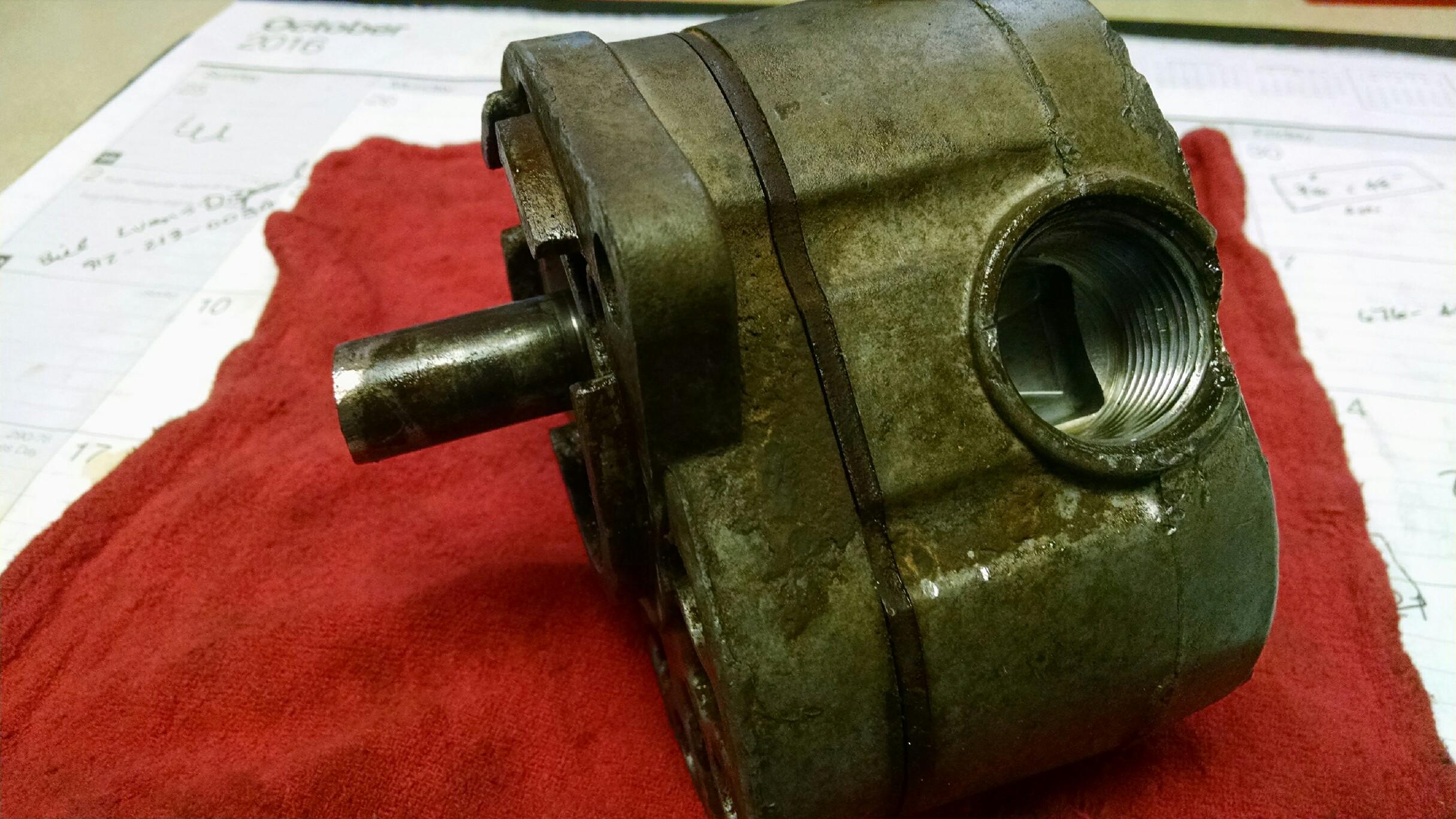

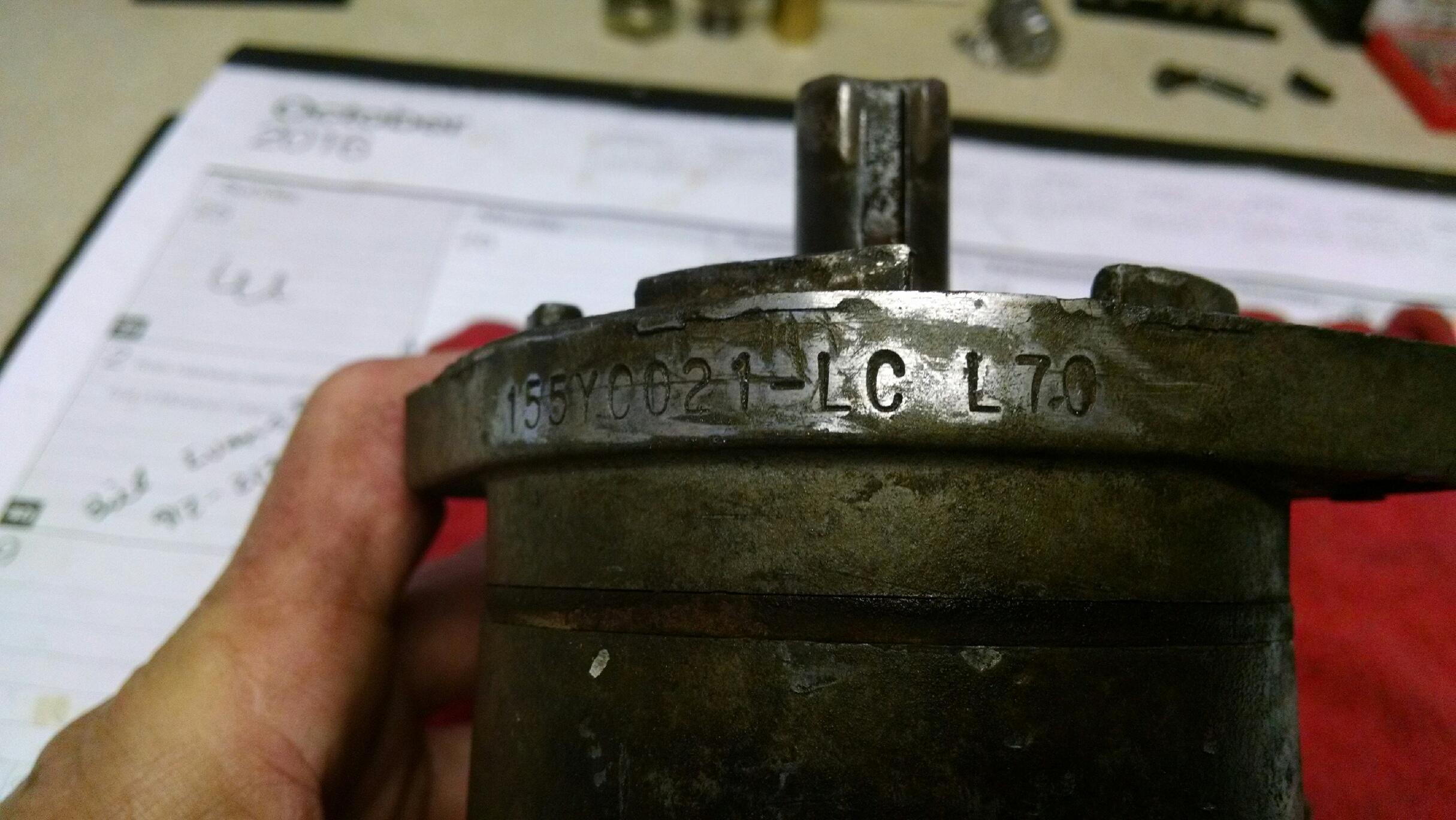

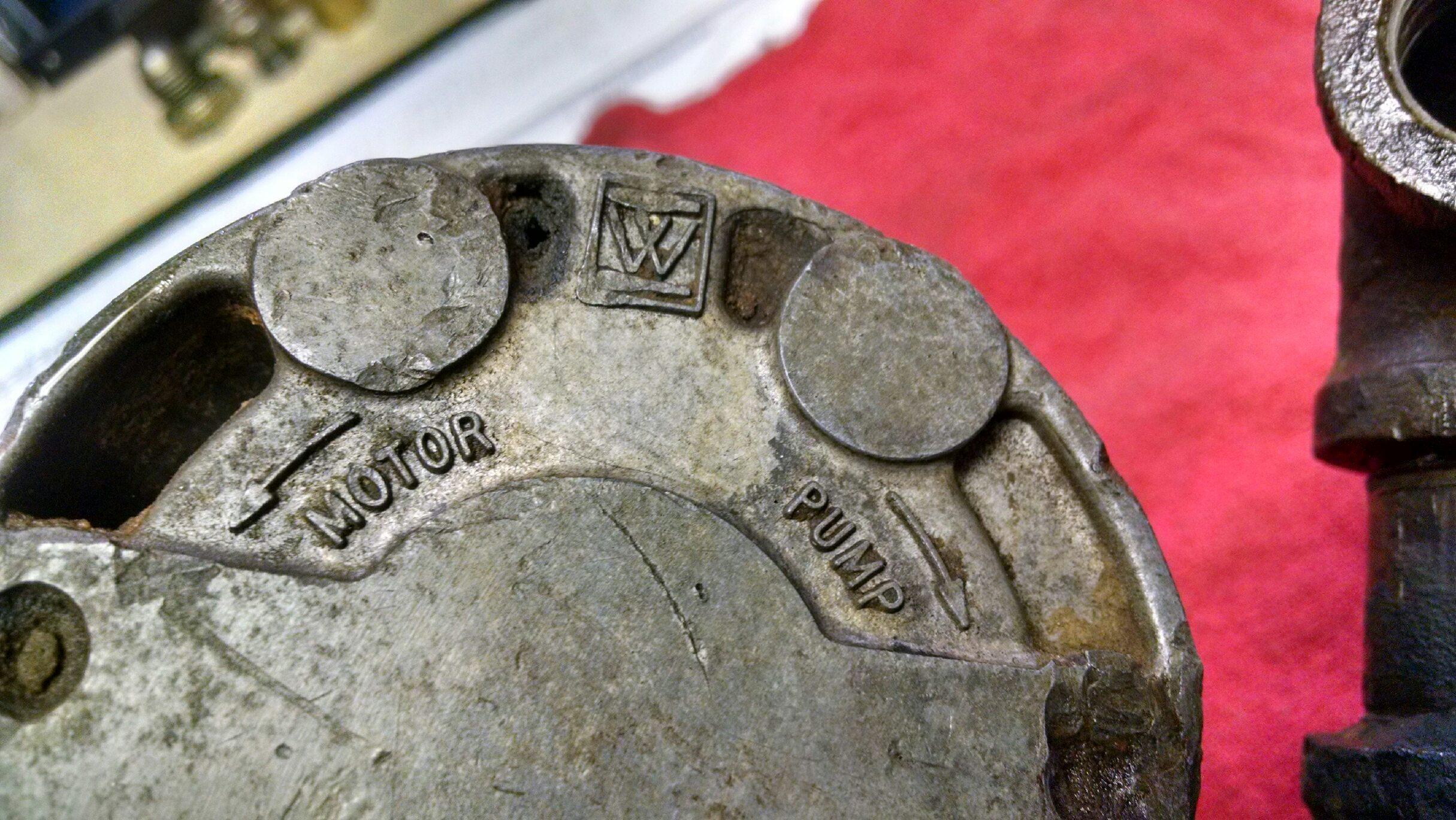

I decided to take my front mounted pump in for rebuild due to leaking/decreasing lifting capacity. The shop informed me that the pump has to much internal wear for it to be repaired back to spec. Part number cast into pump is 155Y0021-LC L70. Also has a "W" cast in back of pump(see pic). I was told pump manufacturer is believed to be Webster although not confirmed.
I am looking for a source for a new or used pump. Including pics.

Funny the shop couldn't cross reference the pump to a newer number. The series could be long past production though and finding the same pump may be difficult at best. If you had the specs, a replacement pump should be easy to find.
Here's a similar pump on Ebay: 2.8 Cu. in. Webster Hydraulic Pump 28KB1ASX-R | eBay

I found this item this item on EBAY and purchased for $65+shipping($27) Not an exact replacement but appears to be a suitable pump. Risky...I know. Ships from Canada so it will be a couple weeks before I get it. Will keep you folks informed. Link to follow...

If the shaft size and mounting holes match you should be OK

Got the Danfoss pump in today. Its an exact match as far as configuration is concerned. Plan to install it in a couple days.
Question: what type Hydraulic fluid should i use? Its a Kelley FEL with the front mounted external Danfoss pump.
