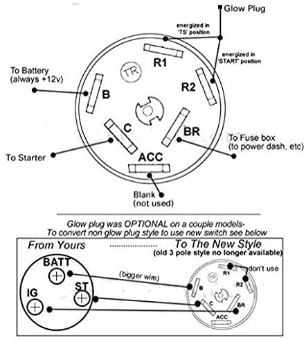

Bought new ig switch. Thought I copied the wire color scheme but ended up with a solid red wire and ran out of terminals. This is a IH 284 diesel .

I looked through many of the wiring links that Alan W provided.
At most I see ignition switches with 5 terminals. Does yours have 6 terminals or is it that you have 6 wires and 5 terminals?
Many switches have more than one wire per terminal.
Can you follow your red wire to see where it originates from. I suspect it is either power to the ignition switch or a connection back to the charging system
How are the terminals on the back of your new switch marked or labelled?
Dave M7040
   / need wiring schematic for my IH 284 diesel ignition switch #5
I did find this pic. Once again hope it helps.
The new switch can be greatly viewed from ---->https://www.amazon.com/gp/product/B07Z7HZ8YM/ref=ppx_yo_dt_b_asin_image_o00_s00?ie=UTF8&psc=1
   / need wiring schematic for my IH 284 diesel ignition switch #7
Did the old switch have more terminals than the new? If not then how was it ever connected.
At this point you are going to have to get a meter and or test lamp and start tracing the wires and see what they go to.
Then you can hook them up correctly.
