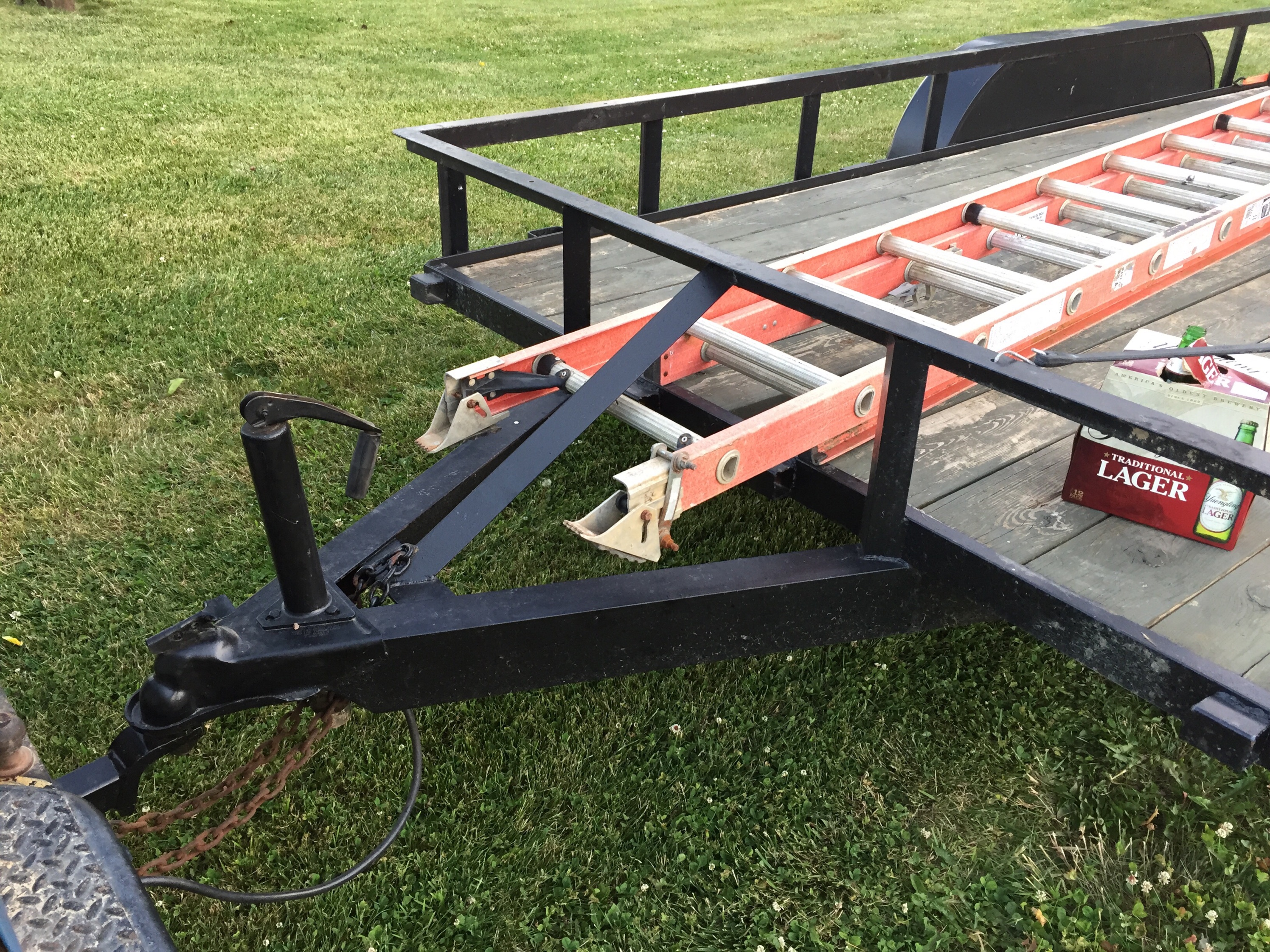

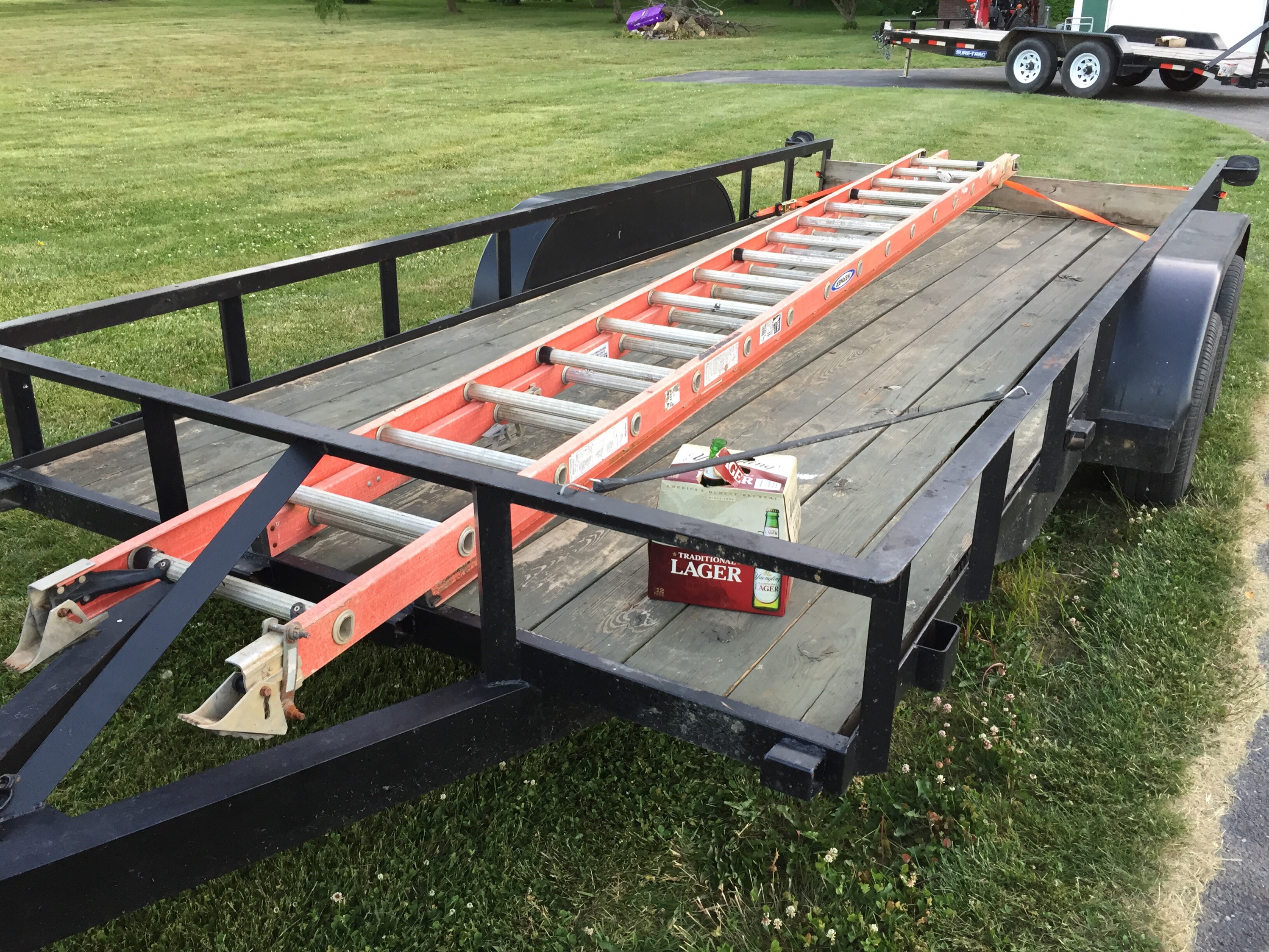

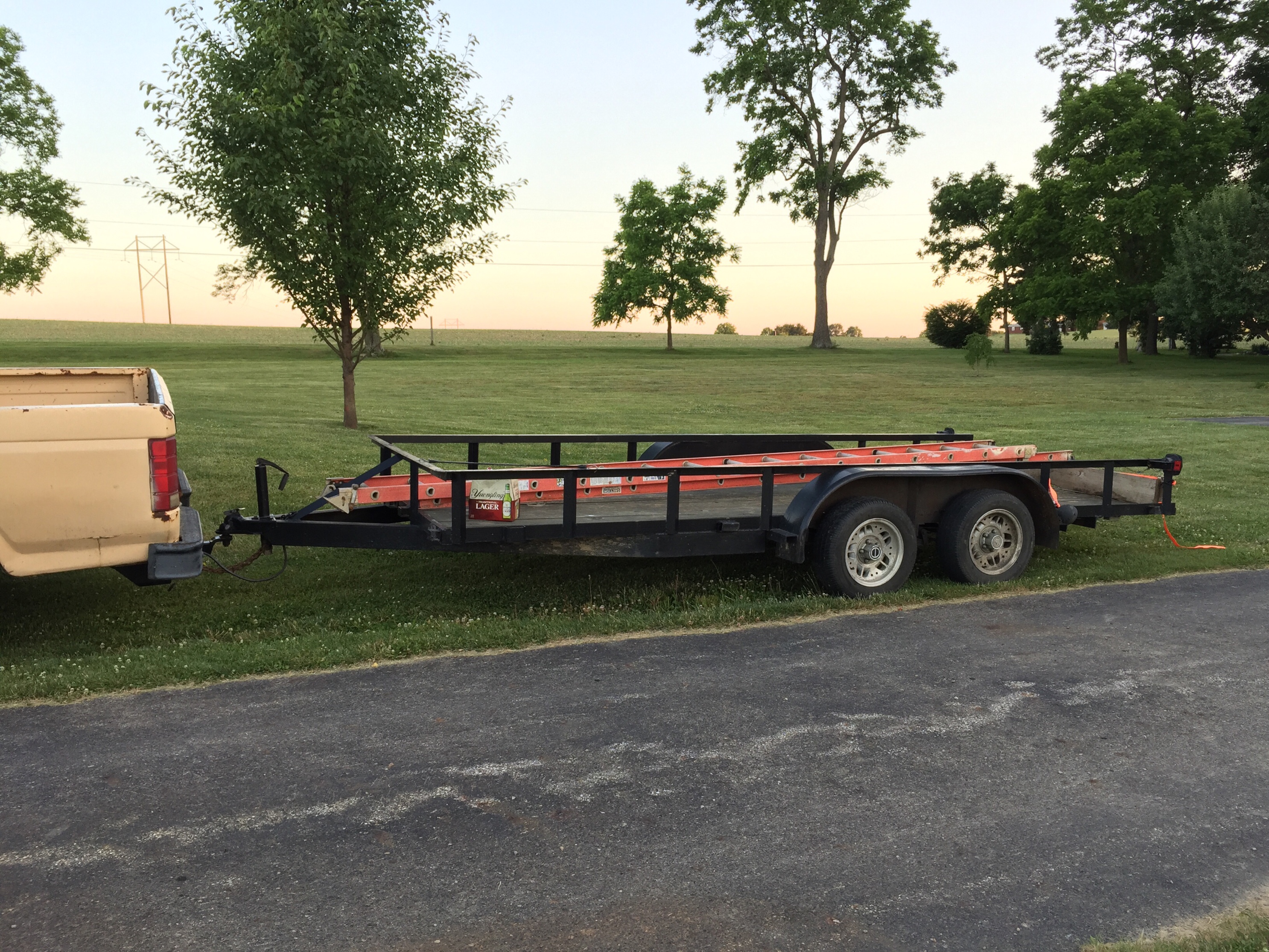

A buddy of mine bid on this trailer for me, so I bought it site unseen, I'm debating if I should keep it or send it down the road.
It's a 80" x 16ft 8000lb trailer with 2in ball.
Wheels look to be aluminum, one tire is less than 50% tread the rest are in good shape, it's got cooper tires on it.
It has a 7 pin round plug but doesn't look like it has breaks, it's got reversing/ spot lights wired on the rear. Idk what do you guys think she's worth?
Edit: we measured the deck, it 75in x 16ft

If it has brakes there will be wires going to the backing plates. If so easy to hook them up. If not send down the road.

$950 without brakes, ramps, or a spare. $1200 if it had them.

It really depends on what your needs are, and how much you're into it already. It should have brakes being that large. 2" ball means it's probably light on the weight capacity, what does the sticker list as max? That would be the biggest thing for me, is it rated to carry the weights I need, and is the deck big enough/wide enough? I personally don't like above deck side rails on a trailer, but that's just me.

You are a victim of a bad deal on a used trailer!
I do not believe in buying any used equipment trailer.
You are usually getting 8 wheel bearings that have likely never been repacked, tires that are usually at least 1/2 worn out (I note that in your case only one tire is an issue),
tires that may be under rated for the rated trailer load, and electric brakes that do not work properly.
I am certain that your trailer does NOT have electric brakes, as there is no emergency electric brake battery shown in any of your pictures.
No brakes for an 8000 lb. rated load, would actually make the trailer illegal in many states.
I note that you believe the trailer is rated for 8000 lbs.
That would seem to mean that the axles are rated for 4000 lbs. each.
4000 lb. axles are somewhat of an oddball on a trailer like that.
Are you sure yours are not 3500 lb. axles?
SELL IT !!!!!

I purchased a very, very similar trailer from my brother's boss after having borrowed it and while I had it, it burnt up a wheel bearing. I called him to tell him that I would need to keep it a couple more days in order to get it repaired, depending on what I found when I opened it up. He asked me what "worse case scenario" was on cost, which would be axle and hub. Told him about $350, and he said I could buy the trailer for less than that. So I paid $300 for the 16 foot trailer, no brakes, and used it for a few years, then sold it for $600. All I had to put on it was a wheel bearing. Wooden floor was approaching end of lifespan when I sold it.

The tongue of the trailer is stamped "Cat 4 8000lbs max, 1250lb max tongue weight".
I'm more leaning towards selling it, it was a bummer when I saw it didn't have breaks or ramps. I have ramps I can use but not that I will sell with the trailer.
