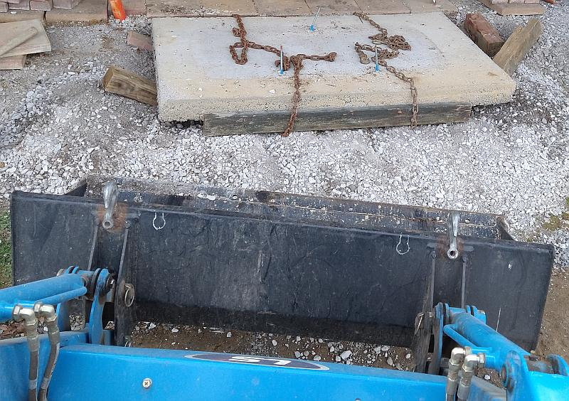

This wouldn't be much of a project for most of you, but remember, I only have a pipsqueak of a tractor.
Slab is a little less than 3' x 5' and roughly 3-4" thick. As I recall, it took either 10 or 11 80lb bags. I know I can't lift it fully off the ground. Not even gonna try. Might be possible with the 3pt if I had the right rigging, which I don't. Specs say 966 pounds, but I don't know how I'd rig it to lift.
Plan is to lift a corner (FEL should handle that) enough to get a steel cable under it; repeat on the other end. Use the cable to drag the slab. Not sure if I can do that with the FEL or if it would risk torquing something. Will probably try using the rear drawbar.
It only has to go about 15 feet, but has to be turned 90 degrees. New location is set, series of concrete blocks as a perimeter. They're partially filled with concrete, then leveled with crushed rock and the center area is filled with crushed rock.
Plan is to position the slab to one side, then set 2 x 4s to use as slides to drag the slab into place. Lift and remove the 2x4s.

I definitely go with the chains instead of cable or rope. I've had the sharp edges on the cement eventually rub and cut them. The other thing rather than use 2X4's, go out and get some schedule 40 pipe for rollers. It's how the Egyptians move blocks for the pyramids. I've done it before, get one edge up on the piping and then you can easily roll the thing wherever you want and even pivot it to some degree.

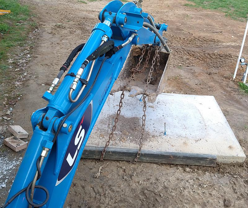

It's 15-20' so I don't see steel cables chafing and breaking, nor do I see an issue dragging without rollers since it's soft sandy/clay mix soil. The 2xs would only be to elevate to get the cables or chains under it and then to help position.
But I found out the cables I have are lighter than I remembered ... only 3MM and rated for 1,350 lbs, so I guess they're out. I have a chain that should work and some old clothes/rags to cushion the corners to help prevent cracking.
But as I stated above, I intend to try it with the backhoe as a crane as suggested. Since it's such a short distance and has to be rotated 90 degrees, I may try, lift, swing, set, reposition, repeat as necessary rather than trying to drive on soft soil with a slight slope. That way I can leave the outriggers set for each move.

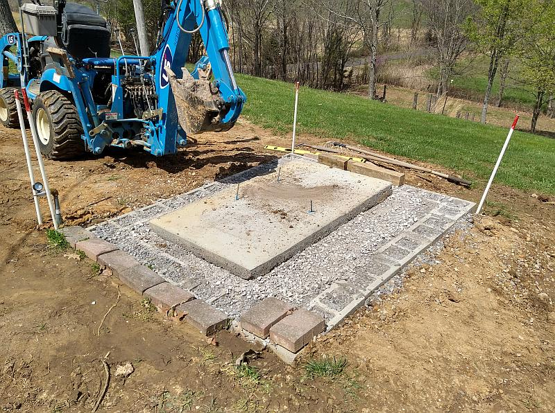

Moved. BH lifted it, but didn't really want to. Had to coax it a bit. Combination of FEL and BH, couple of chains, a few 2x4s and 4x4s, lifting, dragging, pushing got it done.
Had fresh (at the time) loose crushed rock under it when I poured it, so it came out quite easy.
Slid fairly well across the open soil.
As it sits, it's within a half a bubble down hill. I'll probably try to tweak that a bit, but it may work better this way for drainage. Dead on side to side. It should settle down into the new crushed rock a little bit with rains, but I don't expect it to go off level.
No cracking. Chipped a couple of underneath corners is all.
Not easy, but no where near as difficult as I expected.
