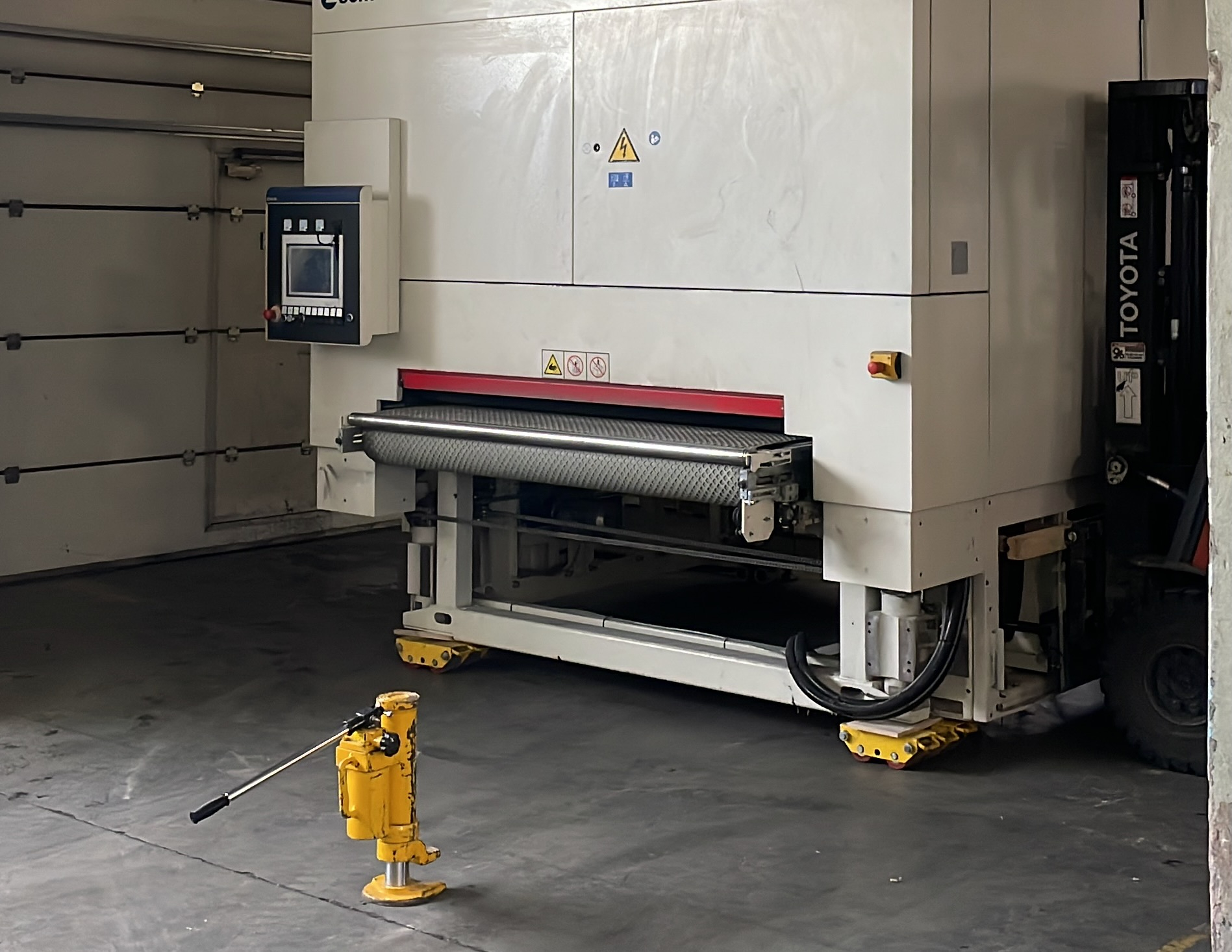

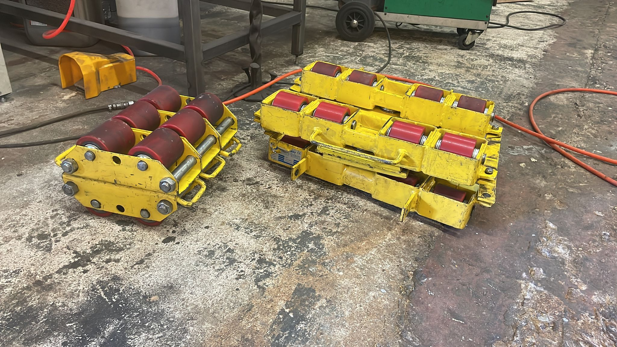

We are using those things to move heavy metal 🤟
This one is 6 tones
That will not help OP, as those rollers work only on hard surface.
To equalize weight long round bars has to be used. Like fence posts
