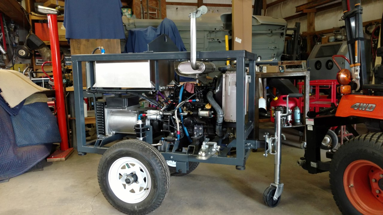

Yes, I rebuilt it, new rings, bearings, gaskets and valve job. Got the parts from JD, the engine was a warranty job out of a JD compact tractor with only ~50 hours on it, and it's identical to the engine in my JD430.
I used it to build a 10KW genset, and it works and runs great.
