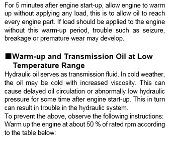

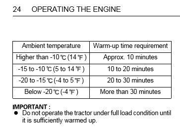

It takes a bit of re-wiring one's habits of engine running [I still refuse to start a cold engine and race it immediately at 2000+ RPM for warm-up, which is what one Kubota mechanic told me to do: "Man, soon's you let go of the ignition key, jam that throttle up to 2000 or even 2500 for 15-20 minutes." I gradually bring it up from 1000 RPM to 1500 over a period of five minutes or so. So far this is working ok.
I can't believe some of the crap supposed "experts" throw out there. Start the tractor and immediately floor the throttle?? That's looking to destroy your tractor right away!
Here's some relevant snips from my Kubota's owner's manual:
So the tractor needs to be warmed up at about 50% of rated rpm for 10 minutes before operating. With my Kubota that means at about 1100-1200 rpm. Idle speed is 900 rpm so it is to be warmed up at just above idle!
The mechanic who advised you to run your tractor at full rpm right after starting it is obviously hoping you'll be bringing in more work for him to do!
