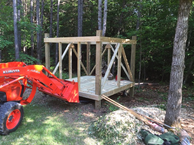

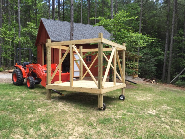

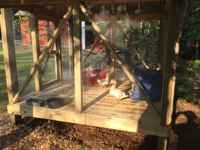

It's been raining so much here I figured the ducks would be full grown before I got to build the house. So I started building it inside my barn where I could stay dry. Got the frame done yesterday.
I was planning to put in a Trex floor so it would clean up easier, but it would have cost about $300 for the boards/screws, and that was not in my duck budget. Ended up using #2 grade 1x6 treated deck boards, much cheaper -- about $50. I spaced the boards 1/2" to help with cleanup.

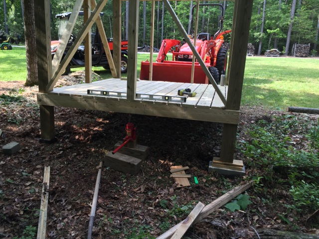

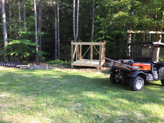

With clear weather today, I moved it out of the barn and down to its new home. I had to cut down a few trees to make room for the duck house, but that went pretty quick.
I had some cheapo harbor freight wheels/tires that my dad gave to me, and bolted them to the rear posts to move it while I used the tractor forks to lift the front. Worked well for such a rigged up arrangement.
I got everything leveled off -- ended up digging in the front posts about 6" and put blocks under the rear posts.
This is a good location, since it is mostly shaded throughout the day, with only filtered sunlight in spring/summer months to keep cool. In fall and winter it gets more sun and should be a warm spot.
Next step will be to frame in the roof later this week, then throw on some galvanized panels. Then build a door and put 1/2" hardware cloth on the sides.

Still raining a lot here. Today was the first chance I've had to work on the duck house since the last update, and I still got rained on a couple times during the day! Managed to get the roof framed and put in the door.
Tomorrow is supposed to be rain-free, so I hope to put up the roof panels. Rain returns tomorrow night, supposed to get about 2" through Sunday, then off and on rain next week.
The ducks are big enough to hop out of the big tub we've been keeping them in (in my workshop). My wife has been putting them outside in a makeshift wire pen with a kiddie pool for a roof during the day, which the ducks love. But I caught a raccoon sniffing around the pen at 4pm yesterday! Hopefully I can get the duck house finished by next week.

Weather was great today except my eyes had a hard time adjusting to that bright object in the sky. Got the roof panels and ridge cap on, and was able to put siding on one gable end before it got dark. I used scrap pine siding (rough sawn) that was leftover from my barn.
Since this was such a small roof, I eyeballed the panels instead of checking square and setting up a reference string to align the eave edge. On one side, the panels came out dead perfect. The other side was off by about 1/4" but not really noticeable. No way I'd try that on a longer roof, but for just 10' of eave length, eyeballing works fine.

Well, the duck house is up and running, though I still have a few odds and ends to wrap up. Ducks seem happy and wife is very happy, since it's a lot easier on her.
I want to put some trim over the edges of the mesh to neaten things up, put in a more permanent swimming tub with drain, and then rig up some sort of trough to catch runoff from hosing the floor and drain it away. The big thing is to build a ramp for the ducks so they can get in and out of the door without help.

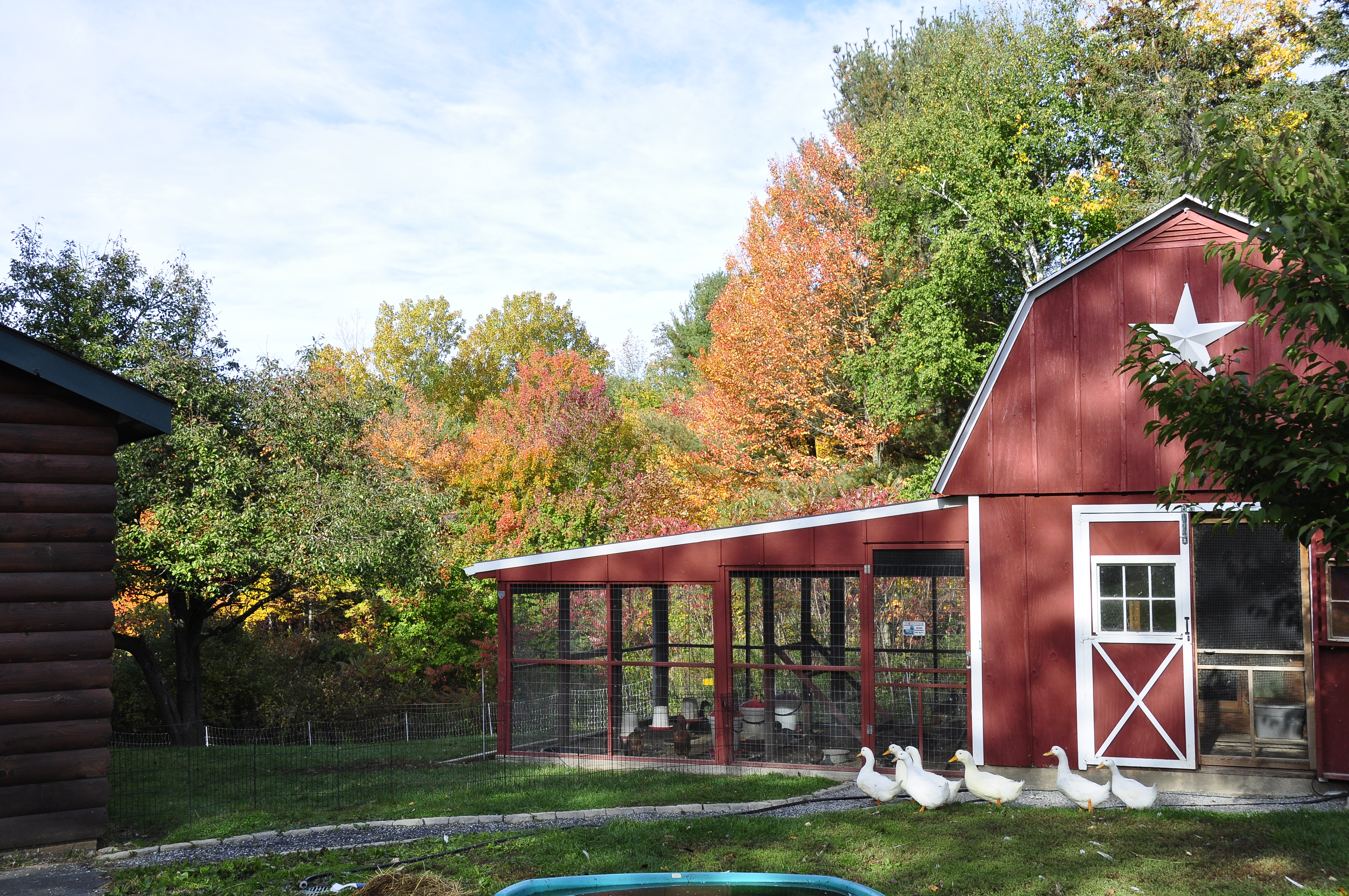

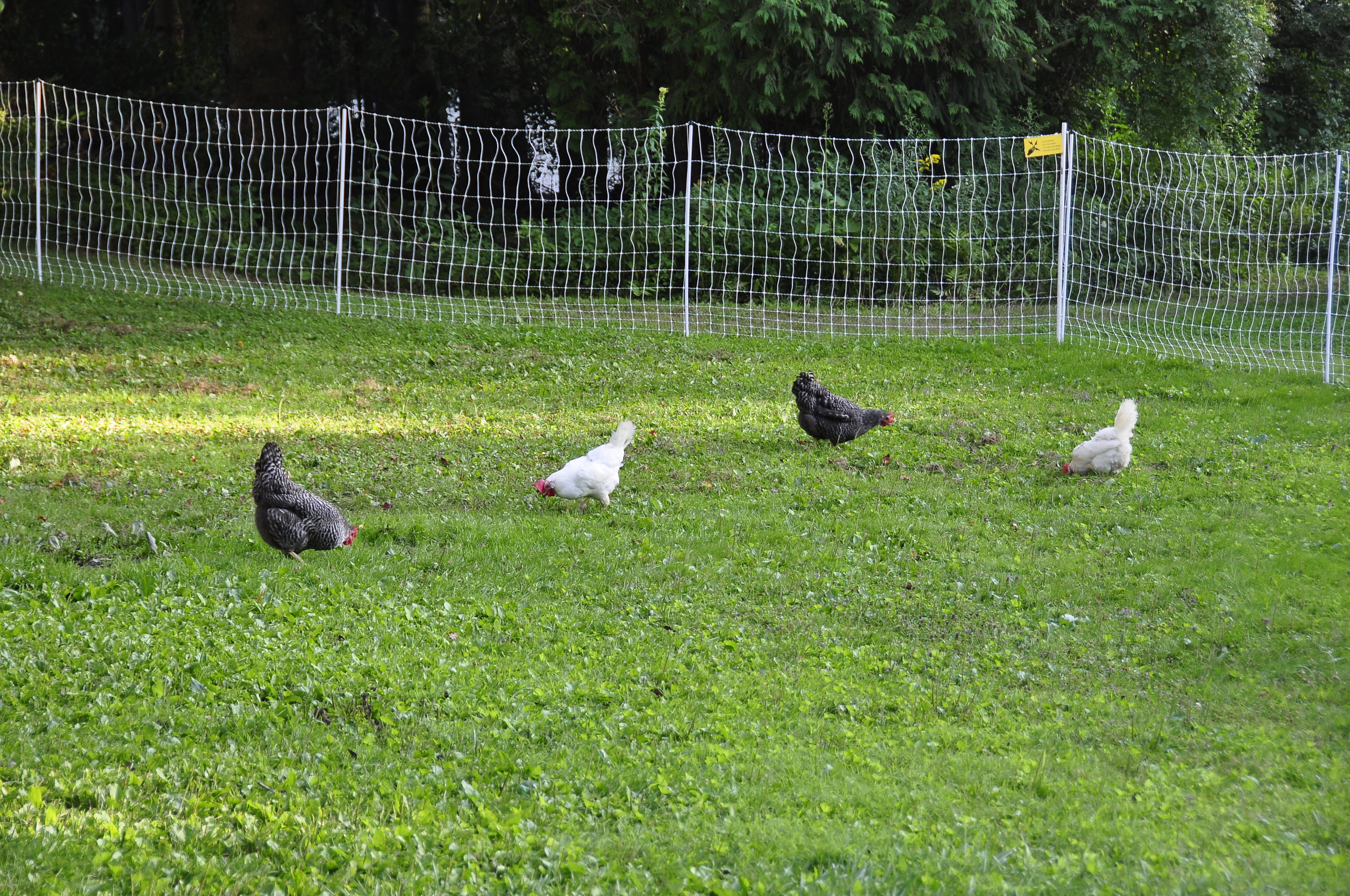

I raise chickens and ducks, and built them a house and covered run, and then I use electric net fence from Premier1 fence (online) to enclose a 1/2 acre yard for them to enjoy. I used to lose 2-3 a month to predators, but once the fence went up, all of my losses stopped.
I still have predators, but they stay on the other side of the fence! Here is a resident cat looking longingly at the chickens and ducks. The camera is 6" from the electric fence.
