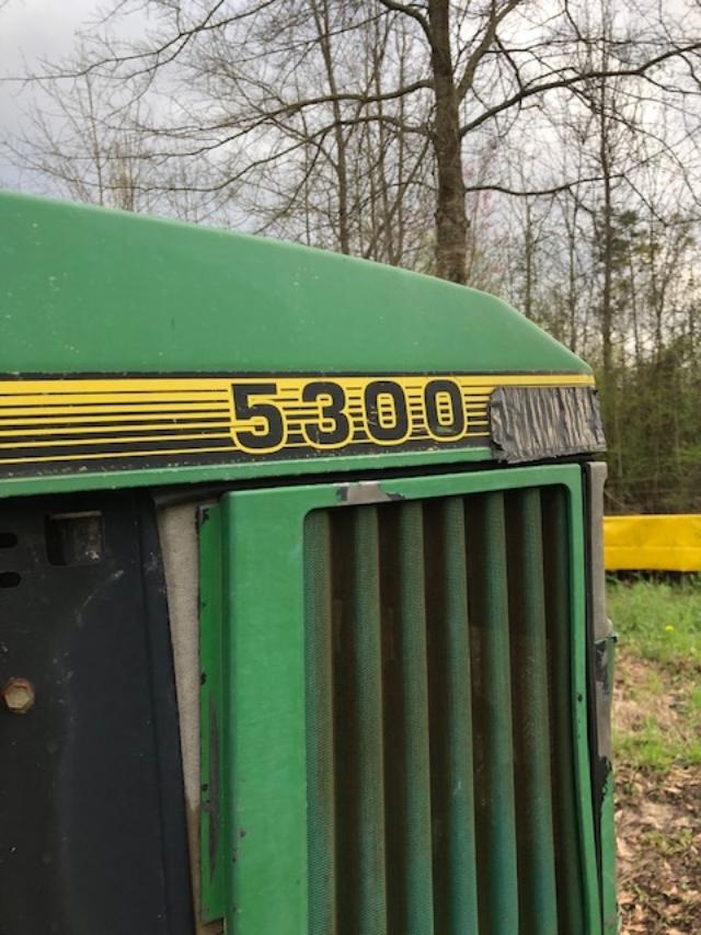

Need to add two rear remotes to a John Deere 5300

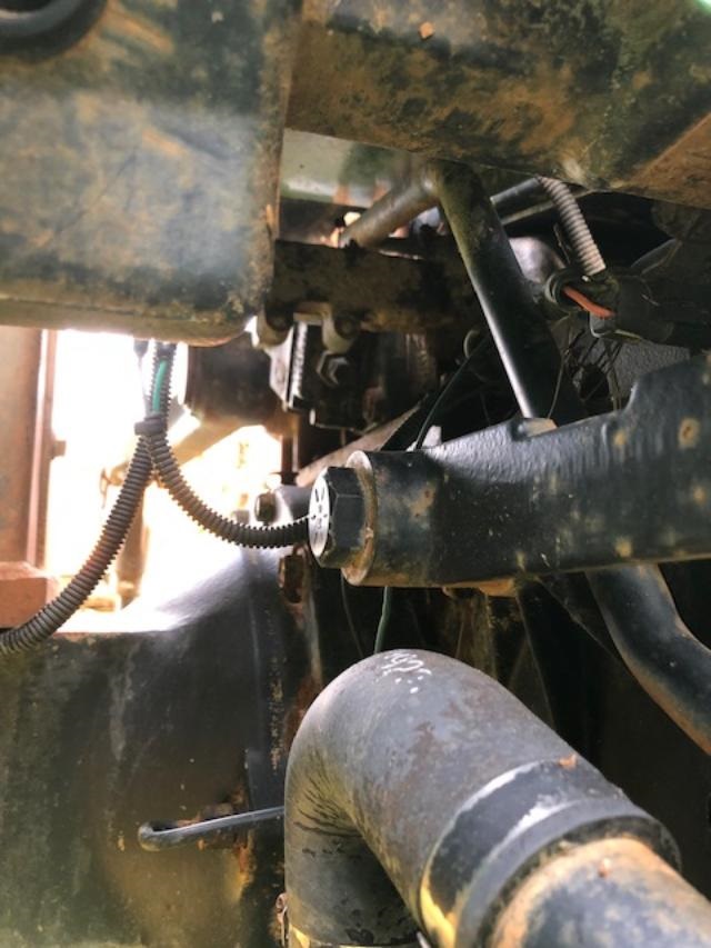

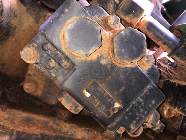

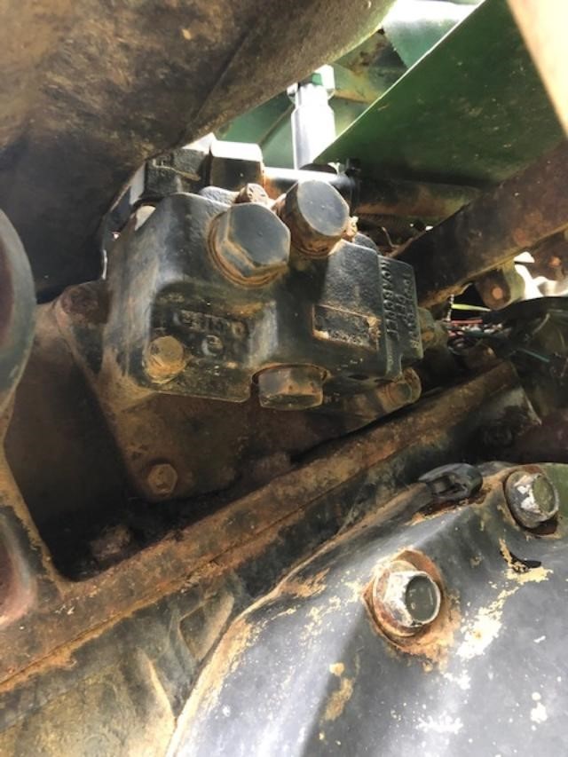

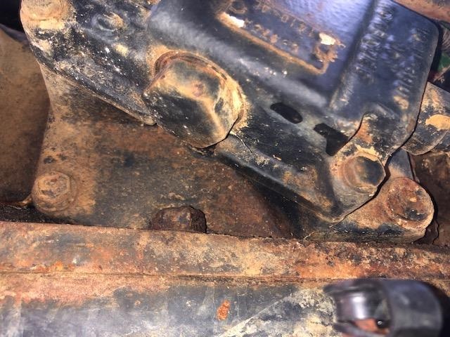

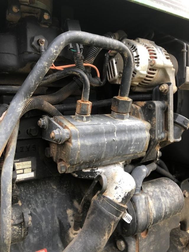

I have a friend who needs to add two rear remotes to the back of his John Deere 5300. We need to know where to tie into at on this model tractor, he said dealer wanted 2k to install them so I figured TBN could help us figure out how to do it. I have attached pictures showing the pump and the main line running to a block in the rear of the tractor. Im thinking this is the Pressure supply for the 3 point lift. Im assuming that these plugs on this block in the rear would be the proper place to add line(s) for the remotes. Just dont know which ones, they didn't seem to be labeled that I could see. There is no loader on this tractor, line goes straight from pump to this block that is mounted to the rear of the tractor sort of under the seat.

Dealer not an option. Can you put a double spool valve in line between pump and 3 point? Power Beyond would go to 3 point where would return to tank go? The tank?
   / Need to add two rear remotes to a John Deere 5300 #6
Dealer should have a schematic.
Your q isn’t that easy- you have no pressure regulation that I can see and the 3 point typically doesn’t get pressure regulated.

Go to a JD dealer and look / pictures of any similar tractor with a loader. Pay attention to the add-on block. Or just get the loader hydraulic kit and slap it on. I use the loader connections for my rear remote needs.
