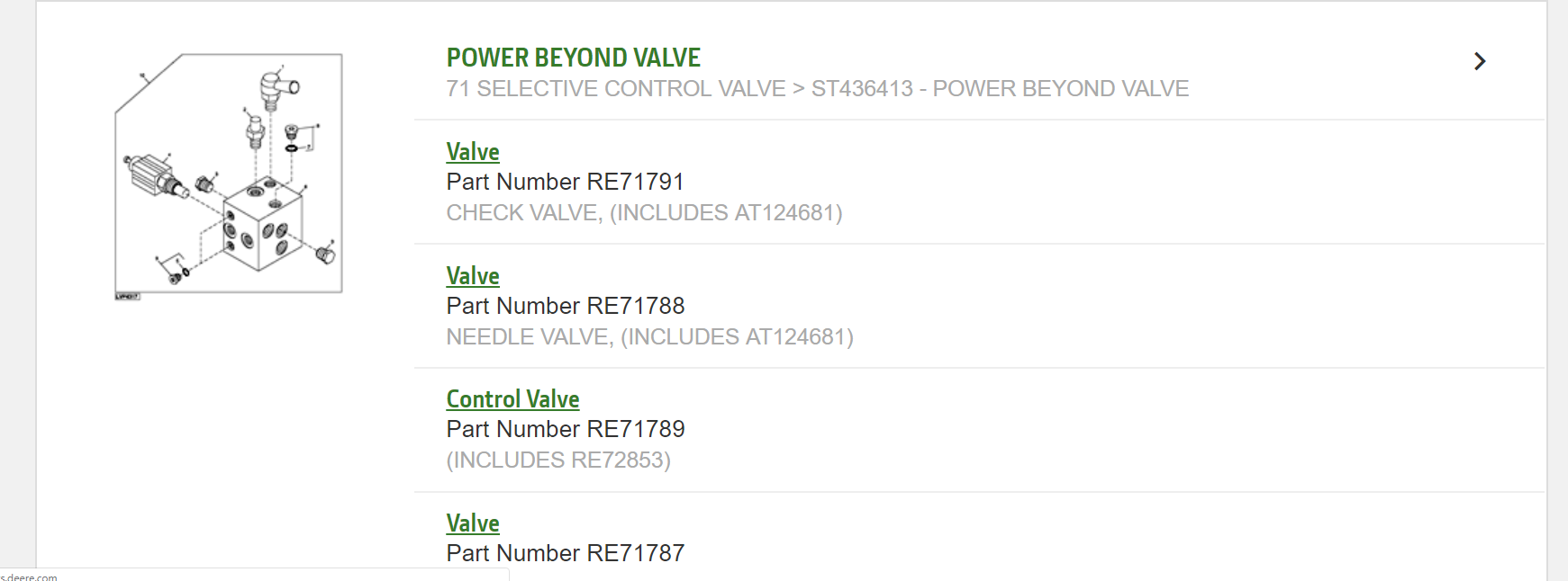

Anything can be done;
If the line from the pump to the block was redone to pass thru an SCV with the pump feed going in the pressure port and the power beyond going to the port on the tractor block, with an additional return to tank piped into the tractor chassis it would work fine.
It almost looks like your pressure relief is visible in the front of the block pictured.
I am assuming the desire is to use a valve from some place such as Burden Surplus instead of the expensive JD parts.

Yes thats it exactly, I agree I think it will work fine. My only concern was where to "T" the return/tank line from a new aftermarket valve back into the system, i suppose anywhere would work as long as it returned to the reservoir/tank. I will check out this catalog to see if i could find something maybe even used, ill google this LV number you have here.

I think to install aftermarket scv & not do harm to tractor's hyd system one will need to acquire/install a PBY valve similar to photo below. After PBY valve has been installed one can plumb generic control valves.

Back when I ordered my 5400, the dealer just "t'd" into the loader valve iirc..
One can't successfully "TEE" into a open center hyd system. Valves must be attached in series on OC system
