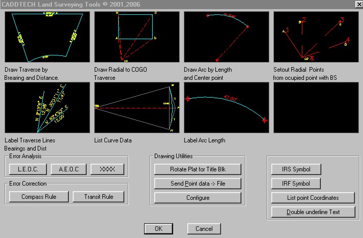

Here is a screen shot of the software I'm working on. I'd like to add GPS overlays to it.
I hear that by late next year consumer GPS units will be accurate within +-1ft. Currently I think it is -+10ft. So you might be able to get a coordinate on a known corner and we can overlay it on the plat.

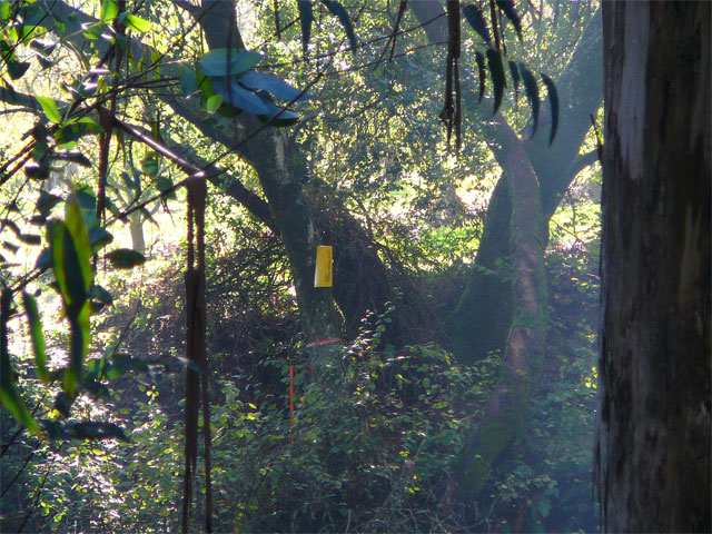

... Look for blazed trees, these would have a blaze facing the line if they were within 4 foot of either side of it or a blaze on line if the tree was on the line. Trees with an "X" will indicate a corner. Trees with an "X" and hacks above and below or base blazed trees will indicate that it is a Witness tree for the corner...
In my area of NC the boundries are marked with two slashes on the tree nearest the property line. Corners are three slashes AND should have three trees marked around the corner. This way you should be able to figure out where the corner is located. SHOULD. :D
If the land has been recently surveyed you might still find flagging in the trees. I have seen the tree grow around flagging that was years old.
